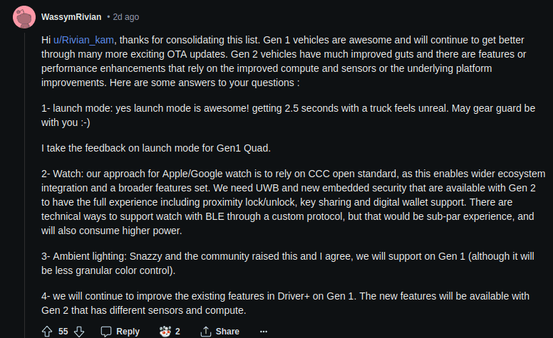

So, what accounts for the difference in the quad-motor 0-60 time between Gen1 (3.0 secs) and Gen2 (2.5 secs)? Is it just software, not the new Rivian motors?
Almost 200 hp and 300 lb-ft plus much stickier summer tires widened from 275 to 305 in the rear (fronts are still 275 resulting in a staggered fitment).

With all the negativity, I want to suggest my simple answer. I believe it is possible to increase both speed and HP with the same motors that are in my R1T Launch Quad Edition. To do this in an ICE car you would certainly have to make mechanical changes and maybe slap on some racing tires. However, with DC electric motors you can increase Power by increasing Current, and the Current can be increased by making some software changes. Simply put, the Software (the brains) controls the Current allowed to the motors; the Current controls the amount of Power (with constant voltage); and Power produces the Speed and Torque. This is essentially how our accelerator pedal performs. Power = Voltage x Current. Increasing Power means increased Speed and Torque. So, I see no reason why the torque, speed, and thermal management of our Gen1 versions couldn’t be increased by a simple OTA update to our software. I remain positive.
Probably not a lot of gains to be had with the primary limitation likely being the water cooled Bosch motors used in Gen1. Rivian's in-house oil cooled Gen2 motors have much better thermal performance.

Someone needs to put the staggered tires on a gen1, and see if that alone could get a 2.99 0-60
