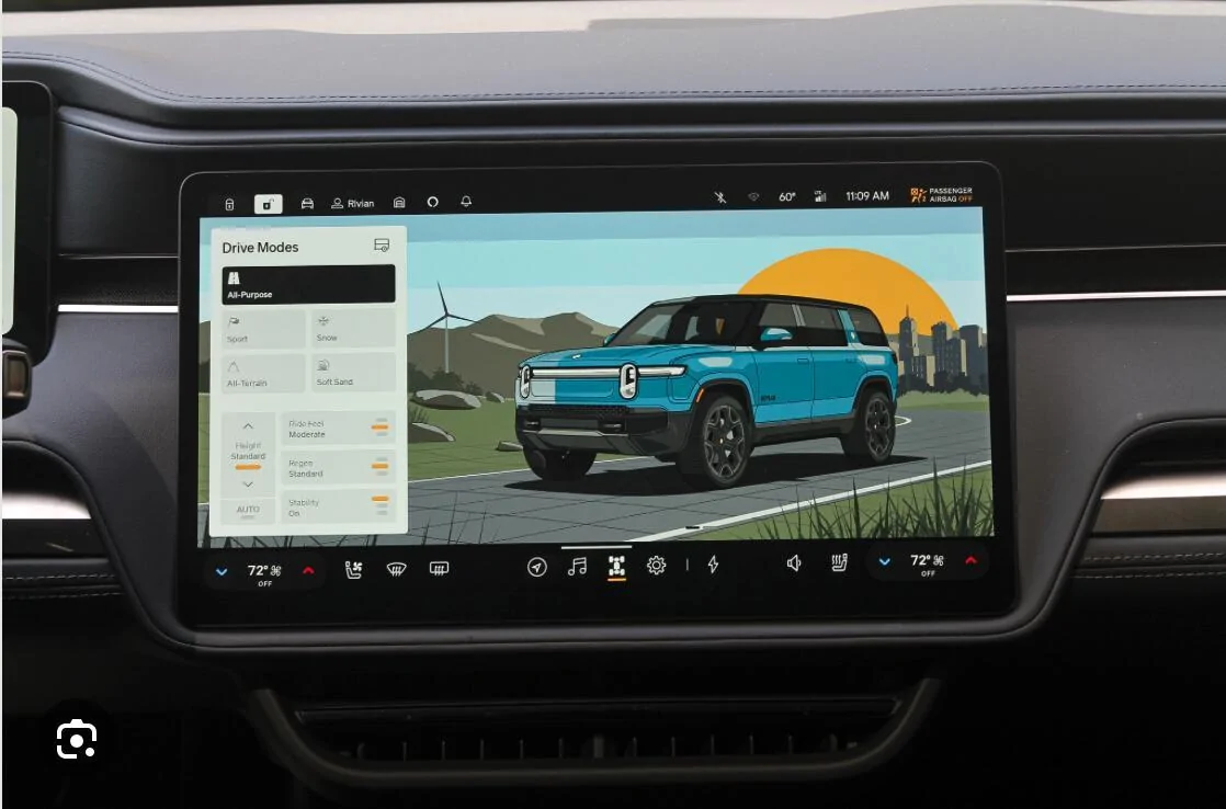

Swipe up from the icons in the bottom center of the main screen. (the area with the horizontal line above the music note and car drivetrain in the image below)
There are 6 or 7 main apps that you can select; there are several that are shown always, one icon for the last app you used, then you can swipe up to see the remaining options.
PS: I do not like the Rivian Owener's Guide - needs a few pictures in there in addition to the hundreds of pages of text...
