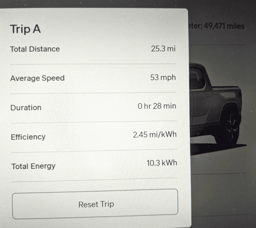

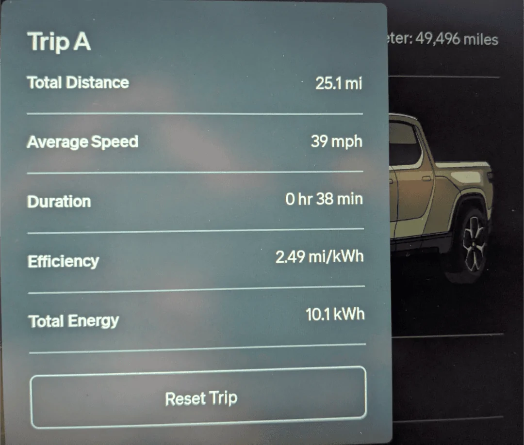

Pirelli AS+3 275/60R20 on Ram 2363 getting 2.47 MPK on my commute. 2022 Quad R1T riding All Purpose/Standard. I go 70mph when I can, 25% local roads /75% highway. AC on 64, lowest fan speed, recirc on.
Morning drive
Rivian R1T R1S Most efficient wheel size? 1000011608
Afternoon traffic
Rivian R1T R1S Most efficient wheel size? 1000011614
Morning drive
Afternoon traffic
What's the weight difference between the RAM wheels and stock? Also, the surface area I imagine will make some difference.
