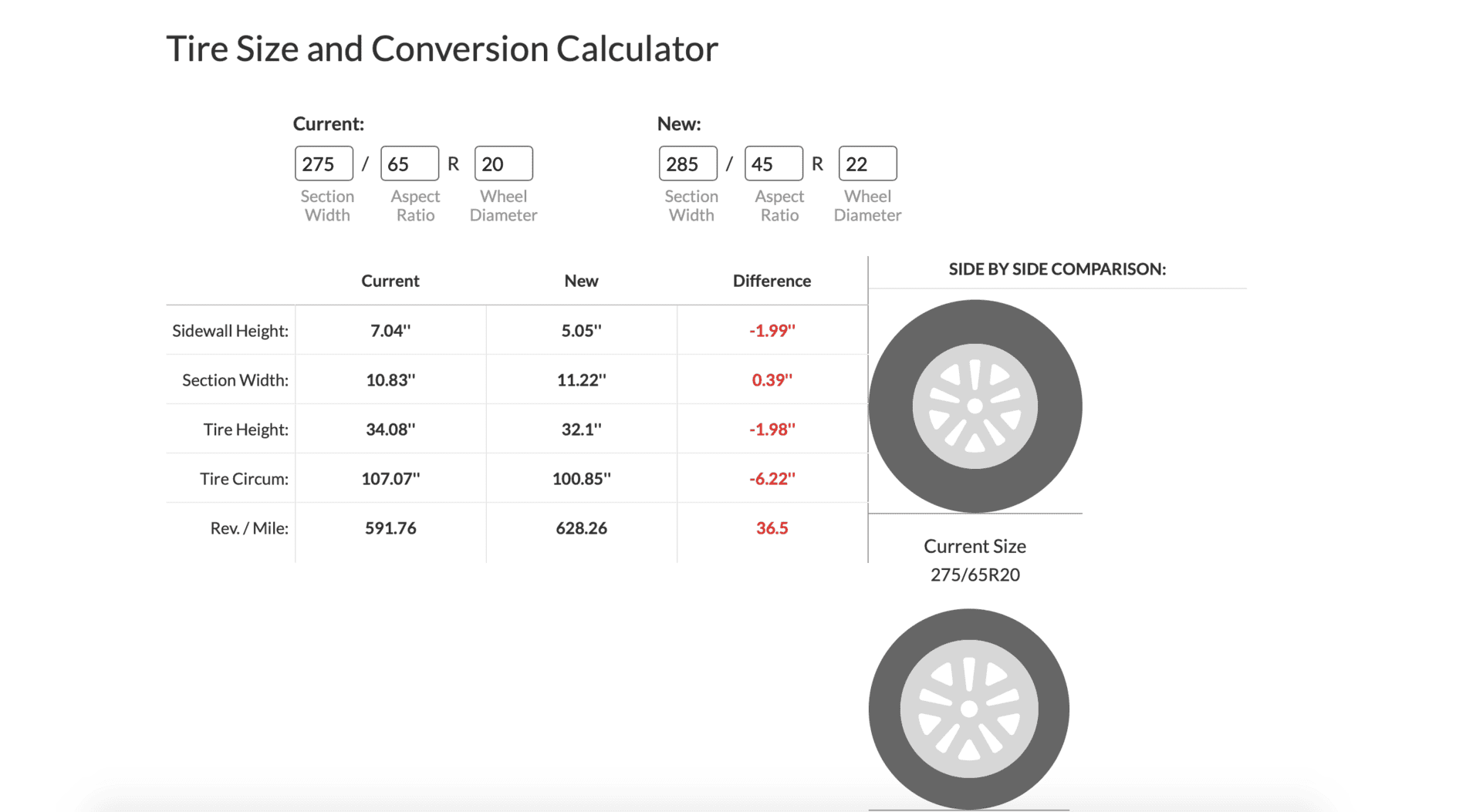

I just went back and looked... my LX470 were indeed M/S rated and I liked them a lot.... Also did a bit of research and came up with the following. The Pirelli Verde 22" Tire only comes in one size "currently" - Pirelli Scorpion Verde A/S 285/45R22 - At this point I am assuming this is in fact the same tire Rivian is using... We know it's a Scorpion Verde and we know it's a 22.
I compared this to a 275/65R20 (which we know is the AT tire that's being offered) on DiscountTire.com can came up with this:
Rivian R1T R1S New Official Video: Normal, August 2020 | Progress Report | Rivian Screen Shot 2020-08-13 at 8.02.59 AM
So the A/S tires give up 2 inches of side wall and 2 inches of height. The tire circumference is also different making swap out more difficult if you can't tell the computer what tires you're running.

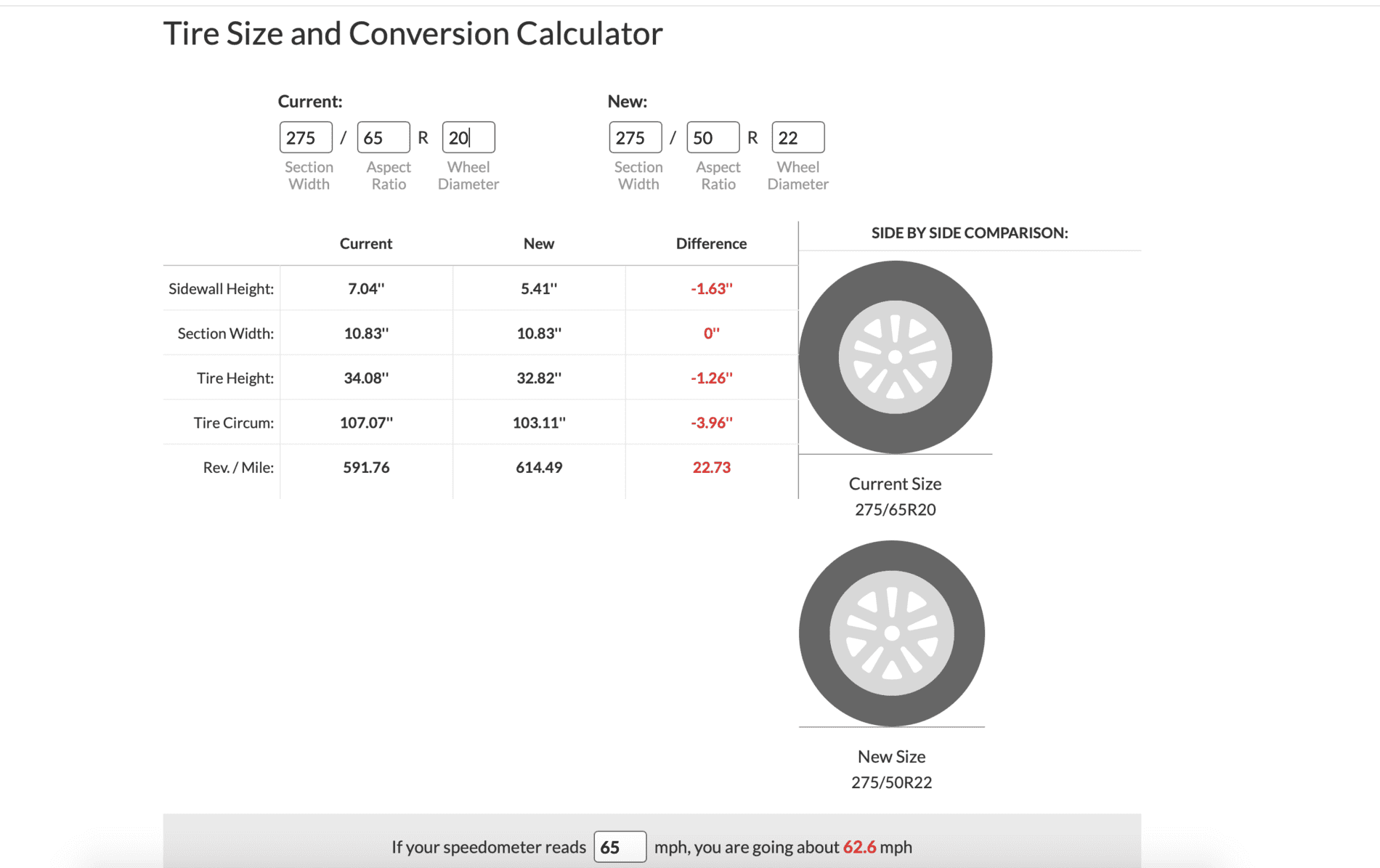

@bajadahl , the tires on the R1S are 275/50 R22 (32.9"). Might not be a readily available tire on the open market, but that's what they are.
Pirelli doesn't make it easy to find on their website (Since Rivian isn't a listed manufacture yet) and on Discount Tires website if you choose the Verde on a 22" rim it only offers the tire I mentioned...
Thanks for the update..

Updated comparison of the A/T and A/S differences based on the size correction from @skyote
