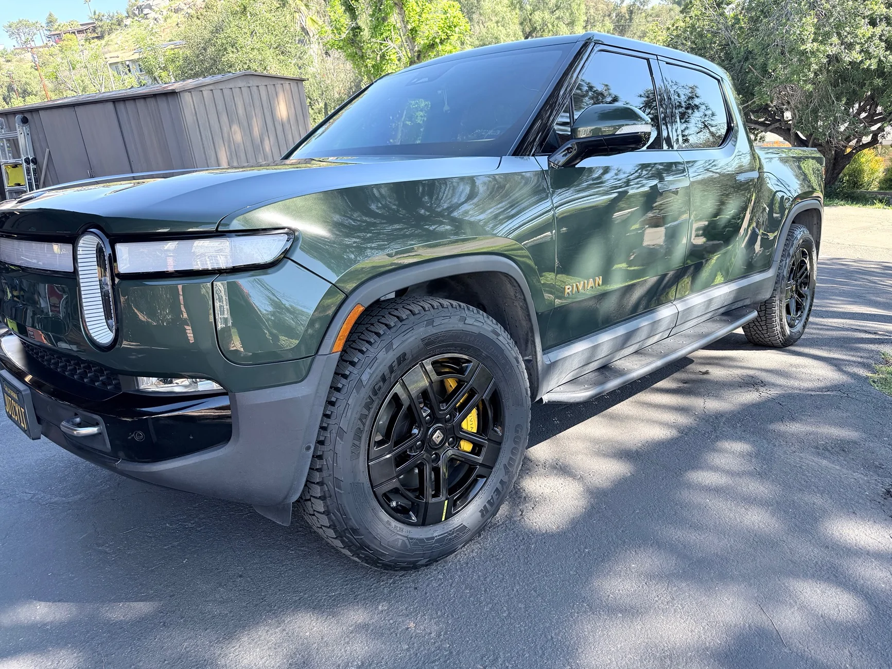

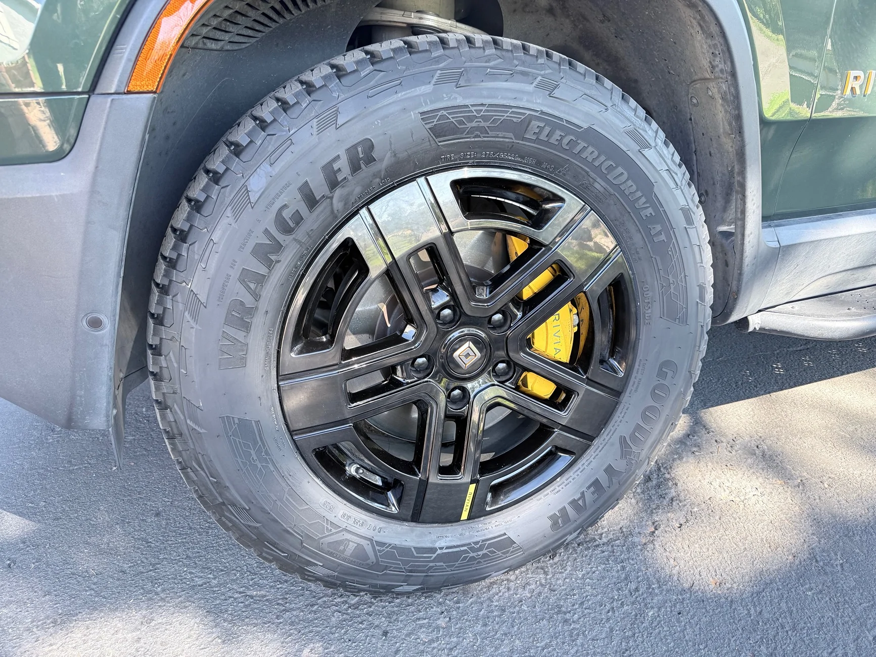

Tires were installed this afternoon! I'll post some photos later today, but wanted to share some initial thoughts and impressions:
  • Noise reduction compared to the Pirellis is like night and day. Obviously everyone knows or has experienced the loudness and drone of the Pirelli's, so no surprise there. These are AT tires, so they are not completely silent, but you have to really listen to notice. I took some quick before and after measurements with a sound meter app on my phone. Not scientific, but gives a decent idea:
    • At 45mph constant speed, the Pirelli's were measuring around 65dB, with a noticeable spike on the graph around the 200-300kHz range. That's the dreaded Pirelli tire noise.
    • At 65mph constant speed, the Pirelli's were measuring around 70dB, with a spike in the 300-400kHz range.
    • At 45mph constant speed, the Goodyear's were measuring around 59dB, fairly linear with no noticeable spike in any frequency range.
    • At 65 mph constant speed, the Goodyear's were measuring around 63dB, with no noticeable spike.
    • One other note on noise, these tires are noticeably quieter over bumps in the road. The Pirelli's seemed to amplify small bumps, almost like hitting a drum when you hit a bump at speed. The Goodyear's definitely muffle the sound of those small bumps and don't translate that noise to the cabin as much as the Pirelli's did. Early on, it's apparent the "Soundcomfort" foam insert is doing what's intended.
  • Efficiency-wise, I didn't really have a chance to get a great like-for-like baseline with either tire for comparison, but here is some limited data for comparison:
    • My lifetime average on the Pirelli's with 20K miles was 2.18m/kWh. This is on a Gen 1 Quad motor with the 20in standard AT wheel and the factory Pirelli's. I reset my Trip B yesterday and drove around for ~25 miles in mostly 45mph stoplight traffic, and got around the same 2.2 m/kWh with the Pirelli's in 80-85 degree weather and AC on.
    • After installing the new Goodyear's today, I've only driven ~15 miles in mixed highway and 45 mph stoplight traffic, and I'm at 2.58m/kWh. Too early to say there is really that big of an improvement, but it looks promising and there is definitely a measurable improvement in efficiency just watching the efficiency graph and knowing what it normally looks like. We will see how that holds up as the tires break in and I give it some more time and miles. I'll keep reporting back over the next few days and weeks.
  • So how do they feel? In a word, fantastic. However, new tires always feel fantastic at first after driving around on worn out tires. There are a few things I've already noticed in the brief amount of driving I've done so far:
    • Steering definitely feels lighter and more responsive. Again, keep in mind this is compared to worn out Pirelli's. However, I am really pleased with the road handling of these tires so far.
    • The tires feel a little more compliant than the Pirelli's, absorbing bumps better but perhaps at the expense of handling, but maybe not. I took a short twisty road and didn't get too adventurous, but grip felt really really good. Better than the worn out Pirelli's, that's for sure.
    • I haven't got the chance to "goose" it yet to test traction. Once I rubber these in a little more I'll give it a go and see how well they perform at full throttle launch.
That's all for now, but I'll be sure to update more as I have a chance to really test these out.

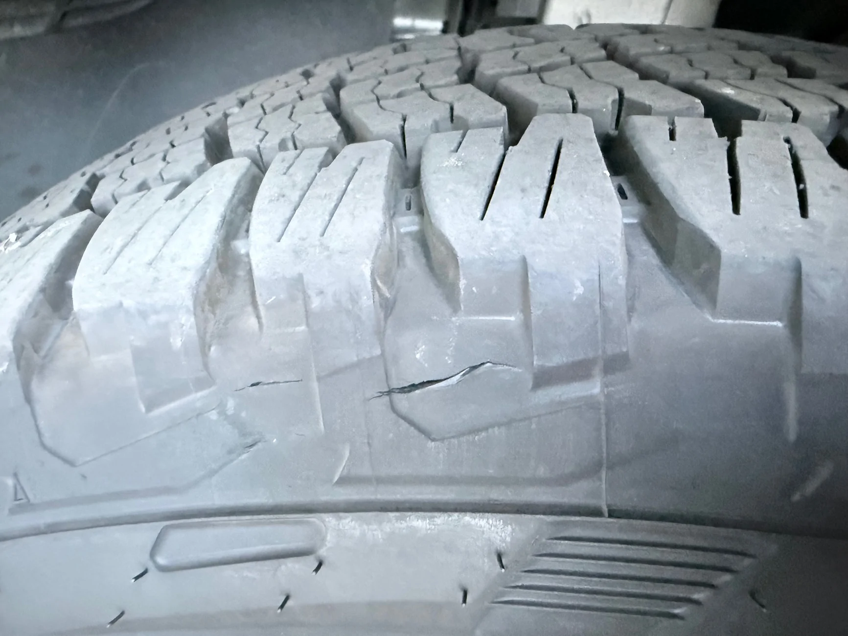

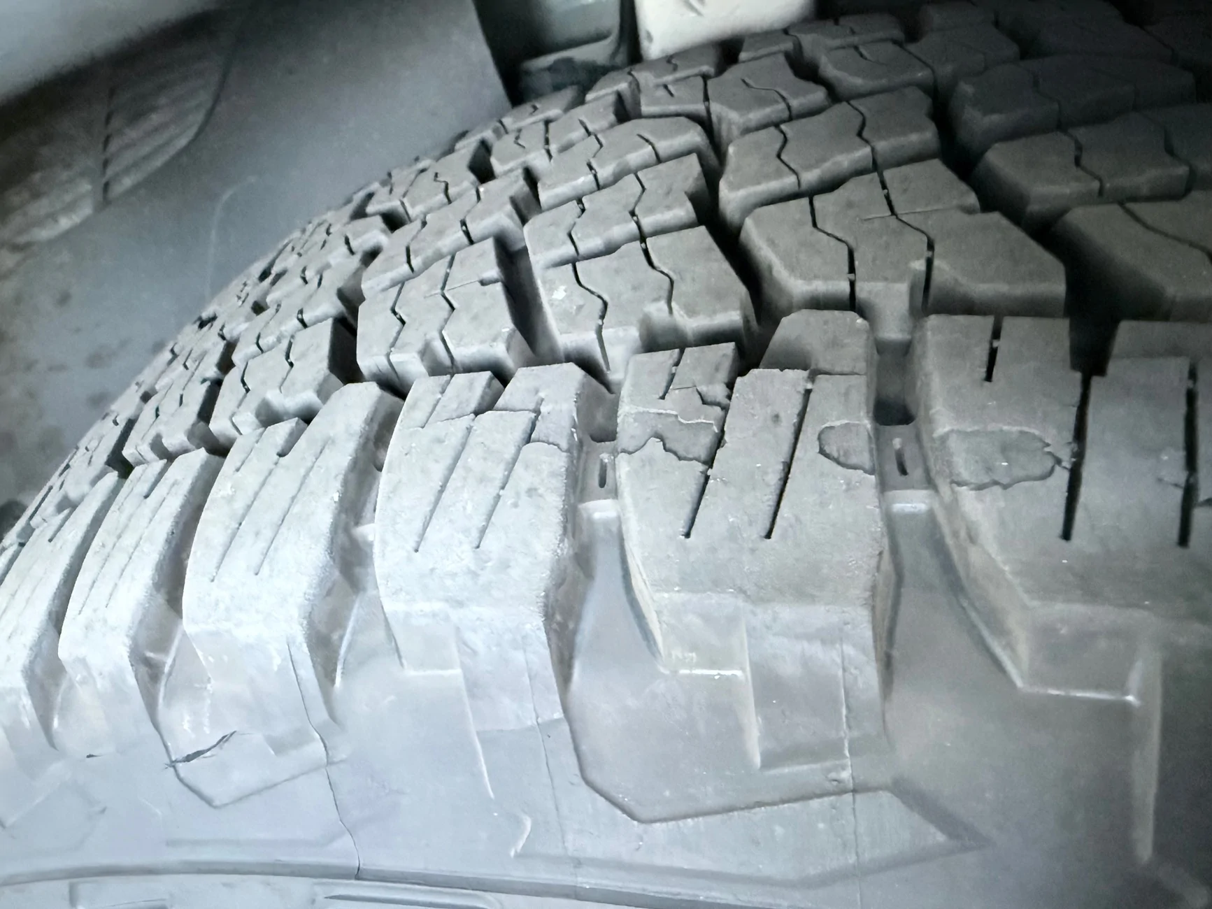

Sorry it took me a bit, one of my tires had a 1” crack and some peeling on day one(see pics), Had to go through the tire rack/discount tire warranty process.
I now have about 1000 miles driven so I would say the new tire grease has worn off and the tires are settling in.
Follow up impression. Still quieter. The sound foam is doing its job. YEMV. What i noticed the most is that over road cracks and separation joints it doesn’t reverberate. Think of a drum hit then a drum with a hand mute. Instead of “WHAP-WHAPpPpPp” it’s a “thunk-thunk”.
Will update in a year or so.

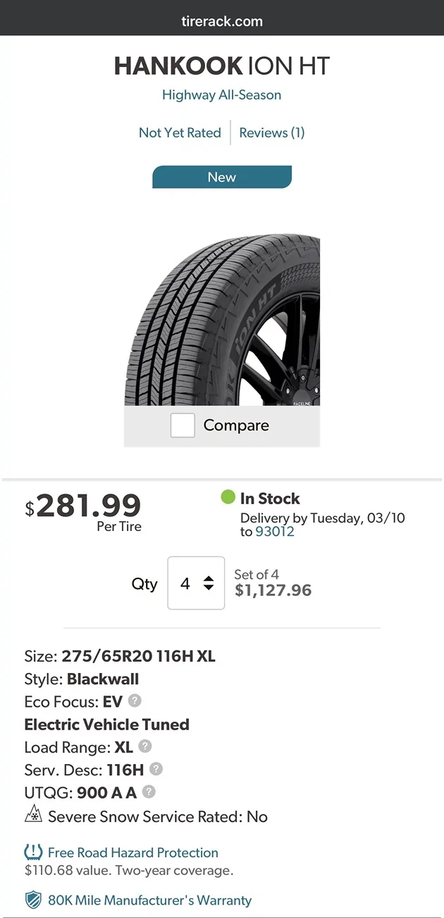

Ok, not sure what your priorities are, but the Hankooks, Michelins, or Toyos seem like a better value than the GY ElectricDrive…
My preference would also be an XL over an SL (LT if towing/offroading):
Rivian doesn’t really fit the standard load vehicle definition: passenger cars, crossovers, and light SUVs
Rivian also typically provides XL or HL factory tires…I’d give the Hankooks a try first since they have a 100-day trial period
HWY1R1T
Feb 17, 2026
Monterey, CA
Thank you. Which Hancooks model are you referring to?
