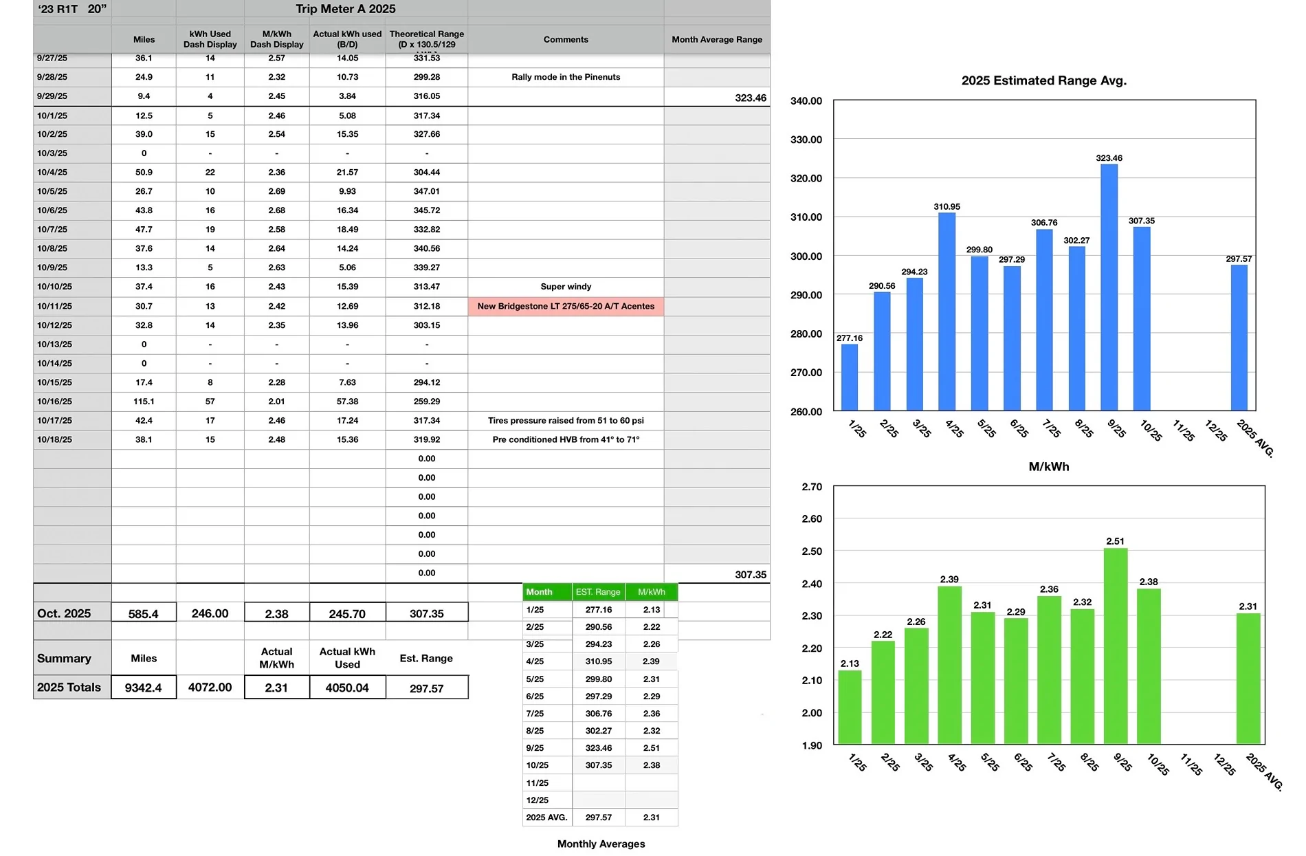

I just put a set of Bridgestone Ascents on my R1T - LT275/65-20. The first fews day, my efficiency was down about 20%. I was expecting a bit of a hit, but not that much. Why was this happening? Well, for one thing we had a bit of an early season cold snap that perfectly coincided with the installation of my new tires. My overnight lows were near freezing and the HVB was about 40º in the morning, and very reluctant to warm up. Second, the tire pressure had been set at 50 psi. The weather has since warmed up a bit, but I decided to manually heat the HVB by preconditioning it. That raised the HVB temp to about 71º, prime operating temperature. Second, I raised the tire pressure to 60 psi. Guess what. My efficiency dramatically increased and seems to have returned to almost normal. Not sure whether heating the battery or raising the tire pressure was mostly responsible for the gains. I suspect it was about 50/50. I only have a couple of days worth of sample, so we’ll see how it pans out going forward.

I came off the original Pirelli Scorpions. I’m including an attachment that details some of my 2025 efficiency data. Oddly, I had a huge spike in efficiency in September, that seemed to be carrying over into October, UNTIL I put the new Bridgestone Ascents LT’s on. I have no idea why there was such a jump in efficiency in Sept. Now, with the LT tire pressure increase and taking into account the HVB temp, efficiency seems to be returning to near where it was is in September. But, I only have a very small sample size. We’ll see if that holds up with more miles and colder days ahead. I am encouraged that there may not be as much of an efficiency hit with the LT’s as I had anticipated. The main reason I went with LT’s is that I do off-road and wanted the extra durability. Somehow, running around in a 7000+ lbs vehicle, especially off road, on SL rated tires doesn’t seem prudent.
