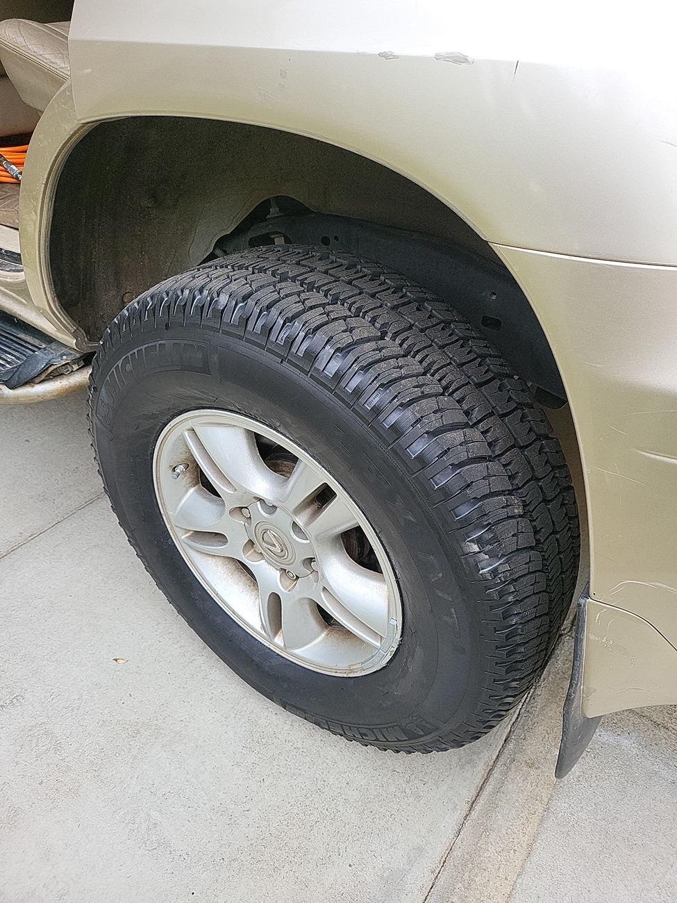

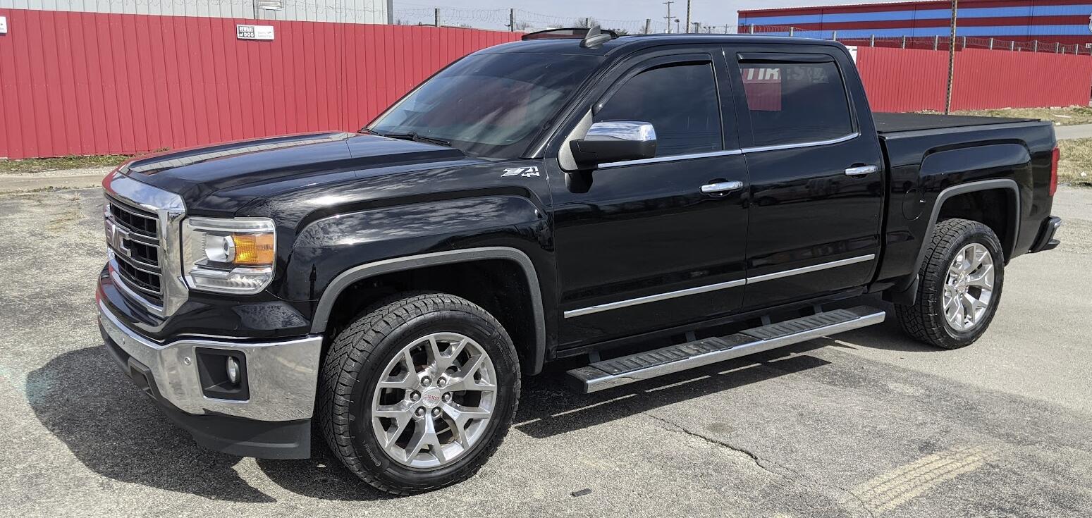

This is the first time I've seen this tire on a Rivian. Are these yours? How do you like them? I had the Terrain Contact AT's on my Sierra and really really liked them. They were smooth, quite, and balanced easily. I'm torn on them because I want to preserve the 3PMS rating (because I live in Buffalo southtowns), but have used them in the past and had a great experience with them.
Not quite as aggressive of a look to them, but better than a regular "all season" tire I think. These were a 275/55/20, but the Sierra had much larger wheel openings in the body, so they looked tiny on there. They do make 275/65/20 that matches the OEM Pirelli AT's
Rivian R1T R1S New Tire Recs - Analysis Paralysis 1749665031213-48
I've been a fan of Continental tires for a very long time. Run the DWS06's on several cars, and then have run several other models on my wifes cars. Heck, even have Continentals on my bicycle. really curious to see what the Rivian owners with these tires think about them.

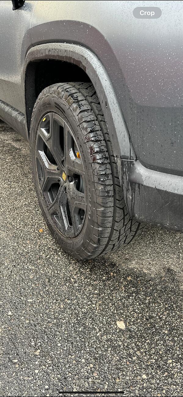

I don't have those. Just collecting samples for me and everyone else. The most quiet and smooth AT I've had is the Michelin LTX A/T. Lots of miles on them and they are still quiet today.
Rivian R1T R1S New Tire Recs - Analysis Paralysis 1000035155
GY Wrangler AT have also been pretty quiet and ok off-road but that was a long time ago and they likely have improved them even more.

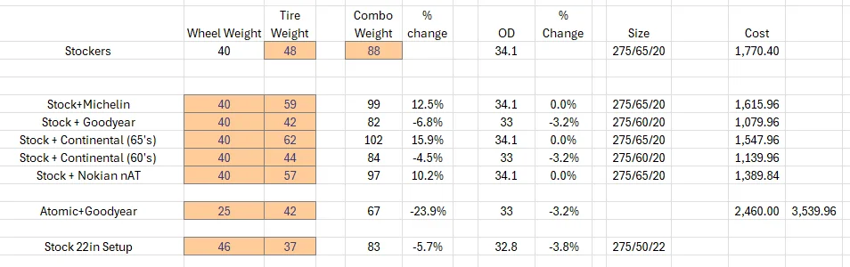

I've started putting together a weight analysis on these wheel/tire packages. The Michelins and the Continentals are by far the heaviest around. but the Nokians are up there as well.
Rivian R1T R1S New Tire Recs - Analysis Paralysis 1749734705491-th
I'm really leaning towards the Atomic wheels + Goodyear setup. More expensive to also buy wheels, but makes swapping them at home easier, and you get a little "savings" from the tires being less expensive.
While I won't disabuse you of the effort to look at mass, it's not the ONLY metric.
I could probably name 15 of them, but the absolute biggest of which is rolling resistance. To which there is generally no (recorded and reported) data.
So, while you'll get a decent *idea* from the mass of each tire, it's only a part of the equation. There are verily heavier tires getting better efficiency than lighter tires just because of compound, siping, geometry, air incursion, etc. TO what degree, we can only speculate.
I keep offering that if anyone wants to pay me a full time salary and cover costs, I'll happily test every wheel+tire combination exhaustively and provide objective real-world data! :D
Oh I agree and get it. There are a plethora of things to looks at beyond just mass. however, it should be a pretty good indicator of of several of the other things you mention though as mass is likely very closely linked to stiffness in this case, and stiffness will drive a lot of the other parameters like rolling resistance, deflection under load, ride quality, etc.
Also, it's damn near the only objective metric we have. Everything else is either shielded behind corporate "secret sauce" or largely subjective/anecdotal.

You didn't list which tire model nor the load rating which makes a big difference in weight. Many of these come in the exact same size with one being a 115/116/119. All different weights. Additionally, the OEM tires have very little tread on them to make them light but they wear out quick. Shave one of the aftermarket ones down to the same tread depth and you'll have a fair comparison.
2kwik4u
Michael
Jan 8, 2025
889
1,135
Western NY State
Let me get back to a PC and I'll post them. Have links to the tires just outside that screen shot.
You can't shave 10lbs of tread off a tire and still have it be usable. That variation is well with the noise of production tolerances.
