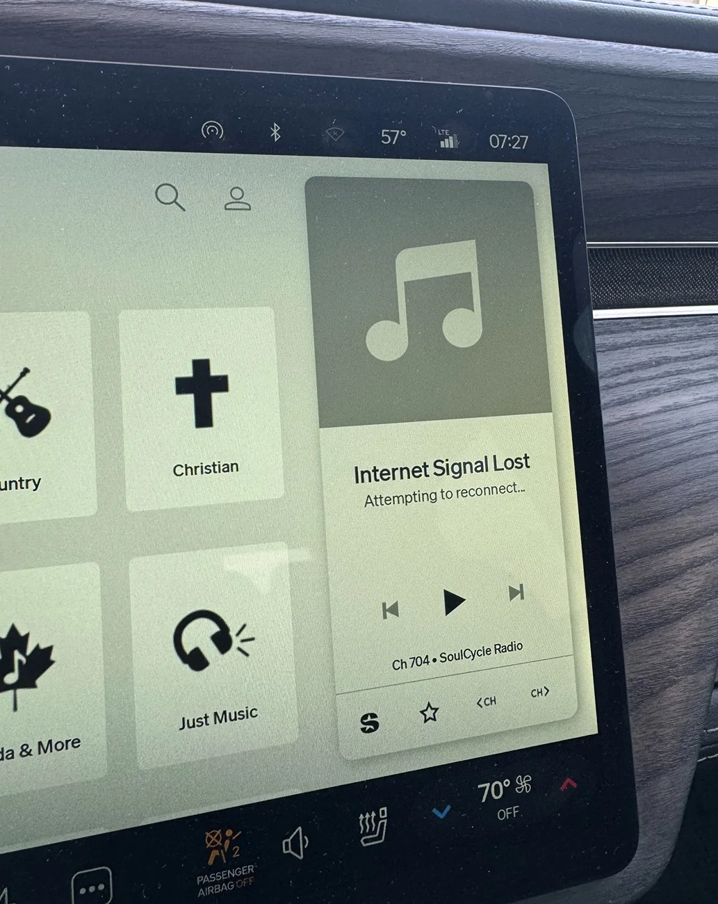

This morning on my drive into work, everything was working fine. Then I turned on wifi and a min later, it said the internet signal was lost. I turned off the wifi again and it took 10 min before the connection reestablished. Interestingly, during the 10 min blackout period, the hotspot worked fine! lol

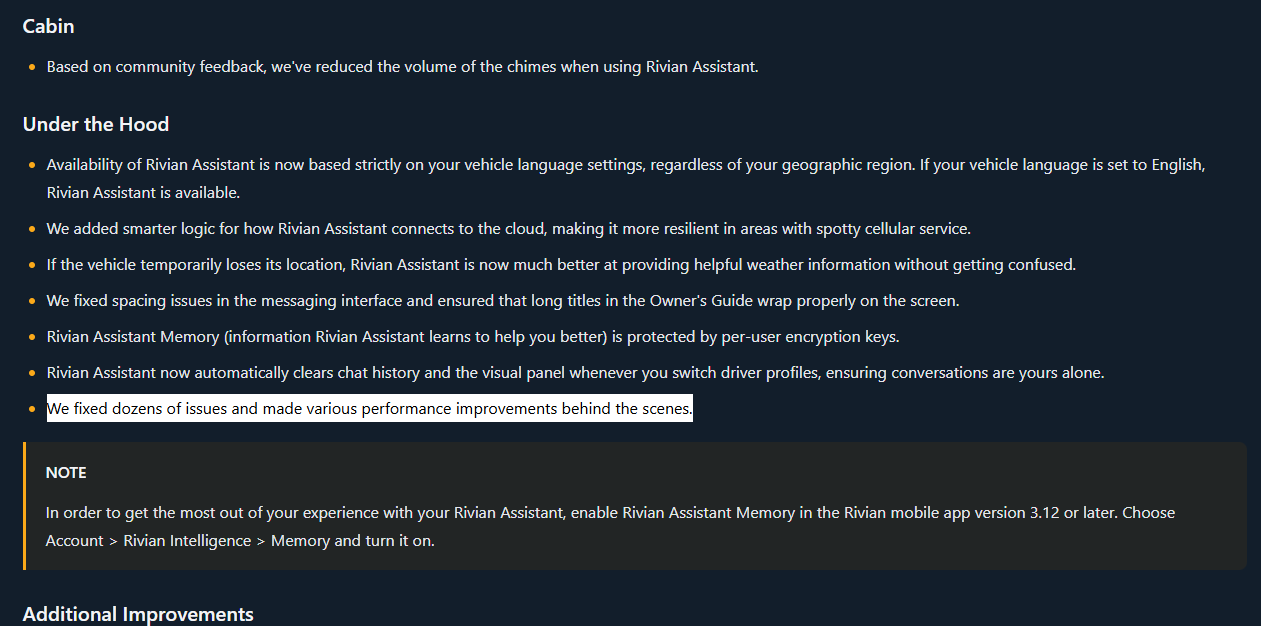

Sorry to hear you're having issues as well. I am not sure if I still have the issue but I assume it's still there. Since I made it a point to turn off the wifi, everything has been working well. I am leaving the wifi off, which is fine for me. I understand we should be expecting a software update (2026.15.30) soon and I may turn on the wifi to facilitate the download when it's ready. Hopefully the update will address this as I believe it's a bug considering I never had this issue before and, others are reporting similar issues. I'll be traveling for the next 2 weeks, so the update may reach the vehicle before I get back. It may be some time before I am able to do follow up testing.
My hope is that the vague "We fixed dozens of issues and made various performance improvements behind the scenes." addresses this... One can hope anyway.
Source: https://riviantrackr.com/2026-15-30/
