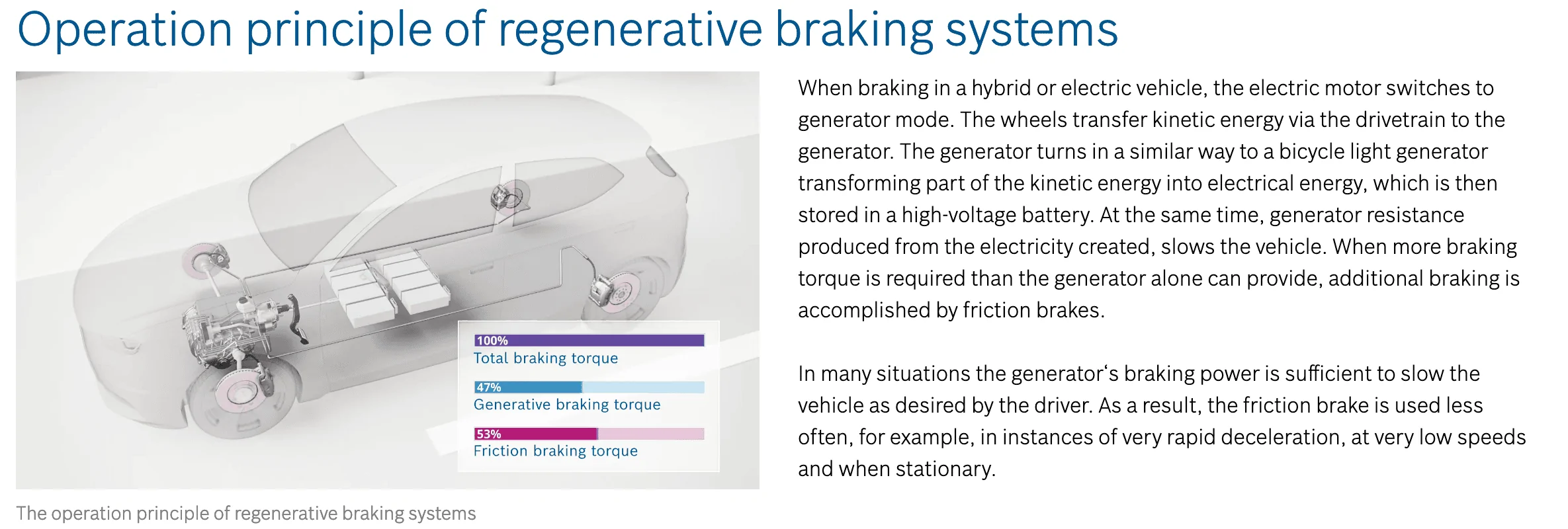

There are two fairly solid indications that Rivian does automatically blend from regen to friction braking as the vehicle slows.
1. From the Rivian EPA Application for Certification - Read the last sentence:
08.07.03 Overlap of friction brakes and regenerative braking
One pedal driving by default, and in this mode, fully releasing the pedal yields the maximum regen allowable in the level selected. As the driver manually increases primary service brake pressure and friction braking torque, the vehicle regen level will proportionally ramp down to 0 Nm. The ramp profile is affected by many factors, such as those described in 08.07.01. When auto hold is active and the vehicle approaches standstill, the braking torque will blend from motors to friction brakes.
2. It has been documented that Rivian uses the Bosch iBooster braking system for EVs. On the Bosch Web Site, it talks about using friction braking at low speed deceleration, and an animation video specifically explains that blended braking is used as the vehicle comes to a stop. This is illustrated at the 56 second mark in the video.
Rivian R1T R1S Not liking one pedal driving 1696299467388
The inset:
Rivian R1T R1S Not liking one pedal driving 1696299493574
The inset:
Getting back to OPD and whether friction braking is involved in Rivian’s implementation…
In the video you linked, at 1:49 it addresses how the 2 different components which can be attached to the brake pedal, “…detect the driver’s braking request and regulate the torque blending.” This seems to indicate that the blending is used to slow the vehicle when the driver presses the brake pedal and it doesn’t address OPD (where the driver does not press the brake pedal) at all. As Rivian implemented the hardware for OPD, it seems the friction brake must only apply at speeds approaching zero to fully stop and hold, such that there is no practical brake blending to slow the vehicle.
While we don’t know all the details of Rivian’s implementation of OPD yet, we do know that as currently configured, Rivian needs to warn the driver that the vehicle will not slow down as expected when regen isn’t available. I get to experience the lack of regen several times each week and the vehicle does not slow down in any perceptible way using manual OPD when regen is unavailable. Braking is just suddenly absent because the friction brakes don’t appear to be used by manual OPD to slow the vehicle. I assume that ACC, AEB, and other automated safety systems would use the friction brakes to slow the vehicle from something higher than walking speed when I’m coming down a hill, but OPD does not.

Too cheap, or is it strictly a design/operational philosophy to maximize regen as part of their "ethos"? The Bosch system can do blended braking and Rivian has documented they do it at low speed. I'm not sure that there is any added hardware cost, just software, to do blended braking with the Bosch system. There was an article I read a while back that said Rivian uses the exact same hardware as Tesla. I'll see if I can find it.
