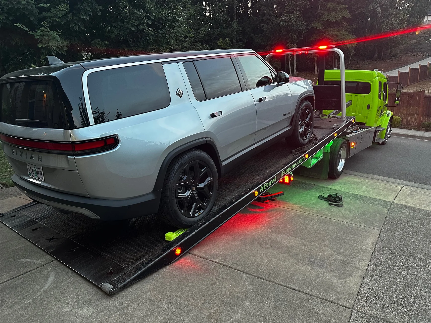

Our nearly new R1S is suddenly a brick

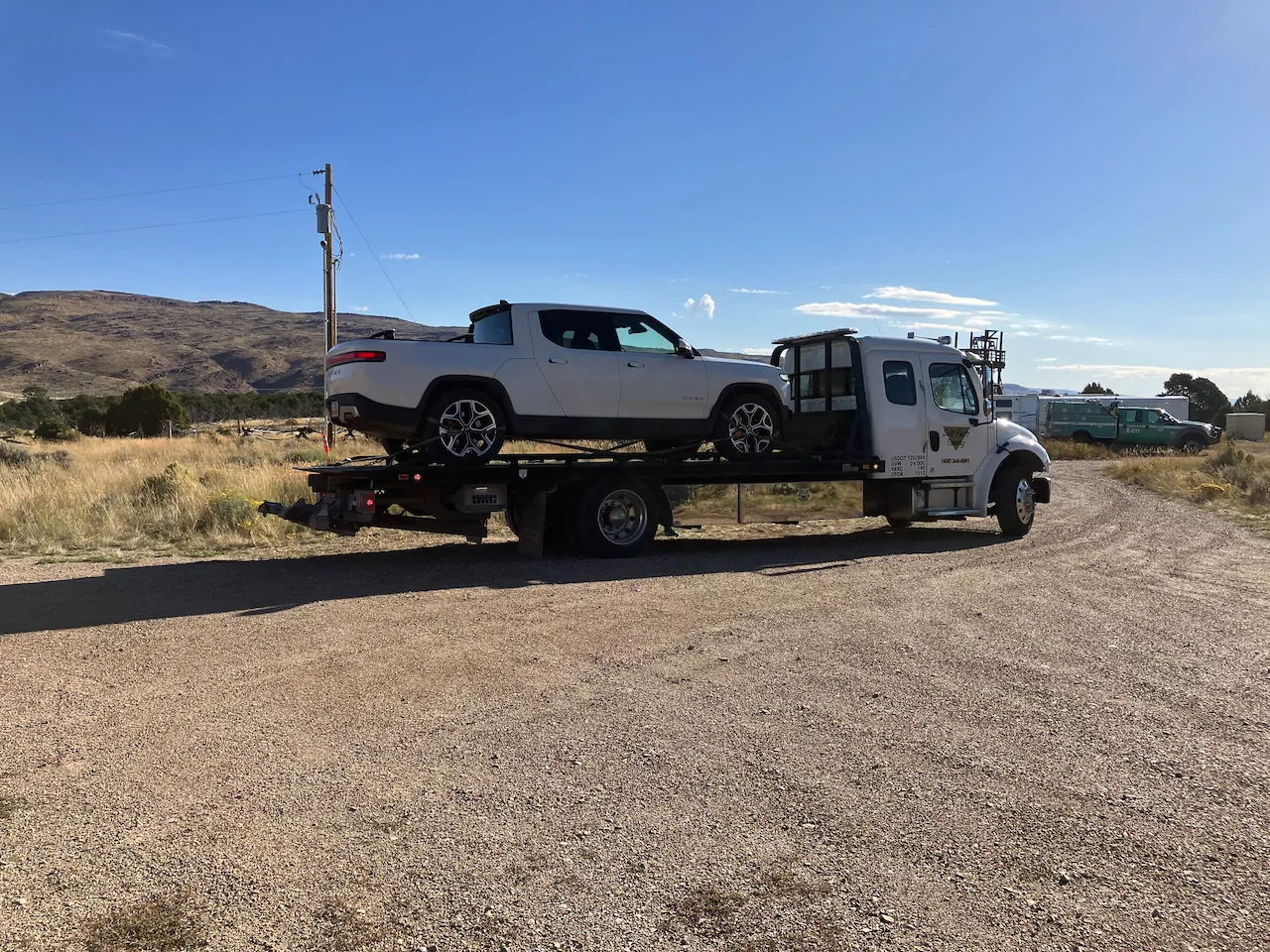

FWIW critical battery error is usually the main pack. Rivian will get it sorted though.
I had the "critical battery issue" message a few months ago on my six month old R1T. The screens soon went blank; there were strange noises; lights flashed; doors would not open; etc. After a few hours it was completely inert. Fortunately, it died at home. Rivian had it towed 75 miles to the service center, dragging it onto the flatbed on wheel skids. The problem was a bad 12V battery (I think they said it was cracked). They replaced it and had the truck ready for me in a couple of days. The HV battery is fine.
Funnily, just a couple of weeks later, Rivian called me to replace the battery bracket. They sent mobile service to my home and changed the bracket and also replaced the battery again.
Your description is VERY consistent with what I experienced. For a little while the screens would come back on if I walked away and then opened a door again a few minutes later, but just for a few seconds. The emergency flashers would activate randomly for 20-30 seconds then turn off. The doors would lock and unlock sometimes, but not always. The audible warning consistently sounded when the screens would come on, and the on-screen battery warning always returned too. I’m hoping it just needs a new 12V battery and bracket but we’ll see. I’ve been quite happy to see so many positive comments here reflecting excellent service and outcomes from Rivian And am counting on the same. I miss my R1S so much! Driving an ICE rental vehicle reminds me why I first went electric in 2023 - OMG!

Final resolution: The 12V battery casing was indeed cracked, as I had expected. It and the bracket were replaced and the vehicle was driven and tested for an additional day with no other problems identified. We picked up our R1S this morning and it’s operating normally over about 170 miles driven today. Our first experience with Rivian service was excellent. Good communication, no surprises. Given our experience I would definitely recommend getting your recall battery + bracket replacement service done ASAP.

I feel better it wasn’t something else. This was a known manufacturing error, already under recall. Rivian certainly learns from significant issues such as this one. Had it been something else “big” my confidence would have been more shaken. I love this company and want to see them thrive.
