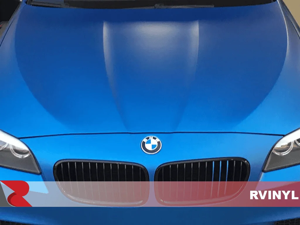

I'm also wondering if anyone here can tell me if they've ever had a matted coat with a ceramic coating over it. Does it diminish the matted effect and add shine, or does it retain the full matted finish?
Thanks in advance.

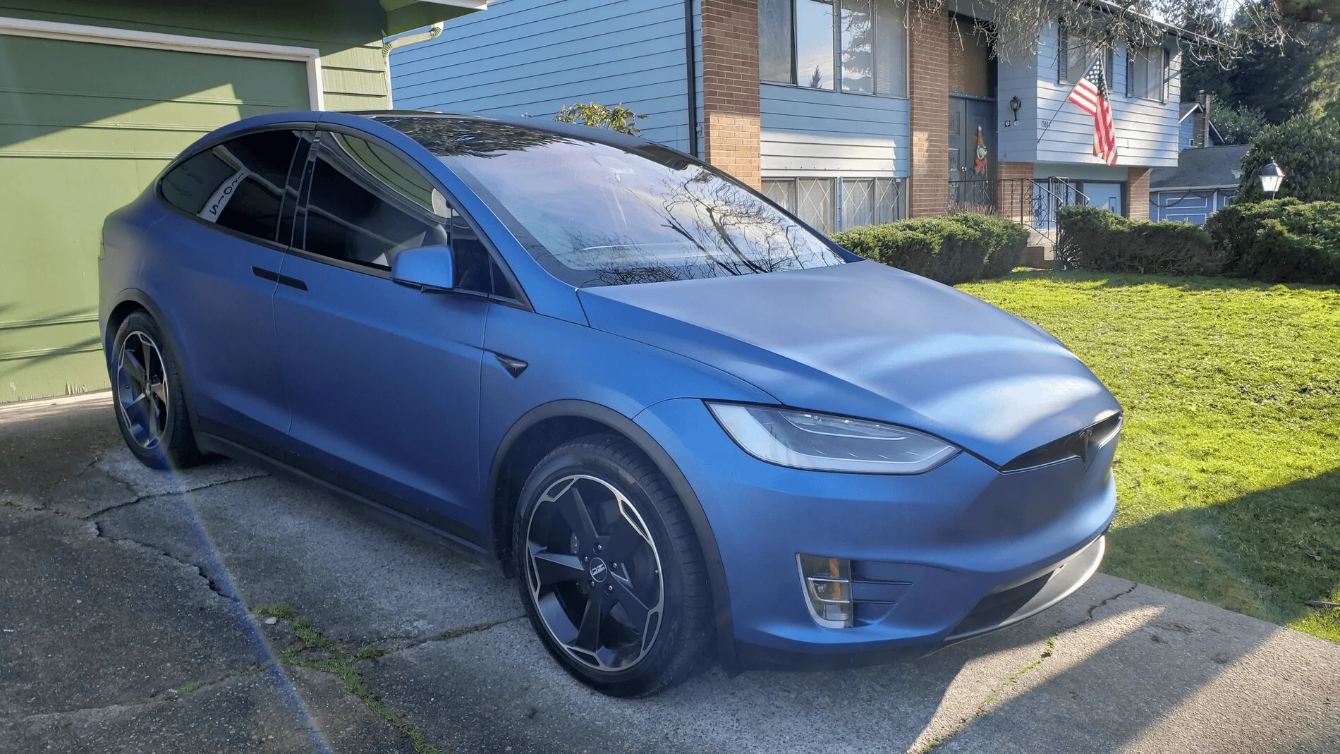

From my experience, no. It doesn't change the "matted" effect of the PPF or of a matte vinyl wrap, it does shift the colour slightly though, generally making it a little bit darker and a little deeper in tone (if you have a colour vinyl wrap).
My Tesla X here has had the Ceramic coating done to it. The wrap is a 3M Matte Blue Metallic. If you look at the sample on the site, and compare to my Tesla, you can get a sense of the shift (kinda).
Uncoated:
Rivian R1T R1S Paint Care Protection Thread 1640577771842
Coated:
Rivian R1T R1S Paint Care Protection Thread 1640577808776
There is of course the difference in lighting and angle... but it does cause a slight shift in the colour, not the sheen.

Thank you! That's all great info. I'd only consider color-free, whether matted or clear. I really like the Launch Green, but would love see a matted version first. I would imagine a matted PPF would require more labor to tuck all of the edges for a consistent finish.
Good to know that a ceramic finish doesn't impact the matted nature of that PPF.
BTW, your Tesla looks great!

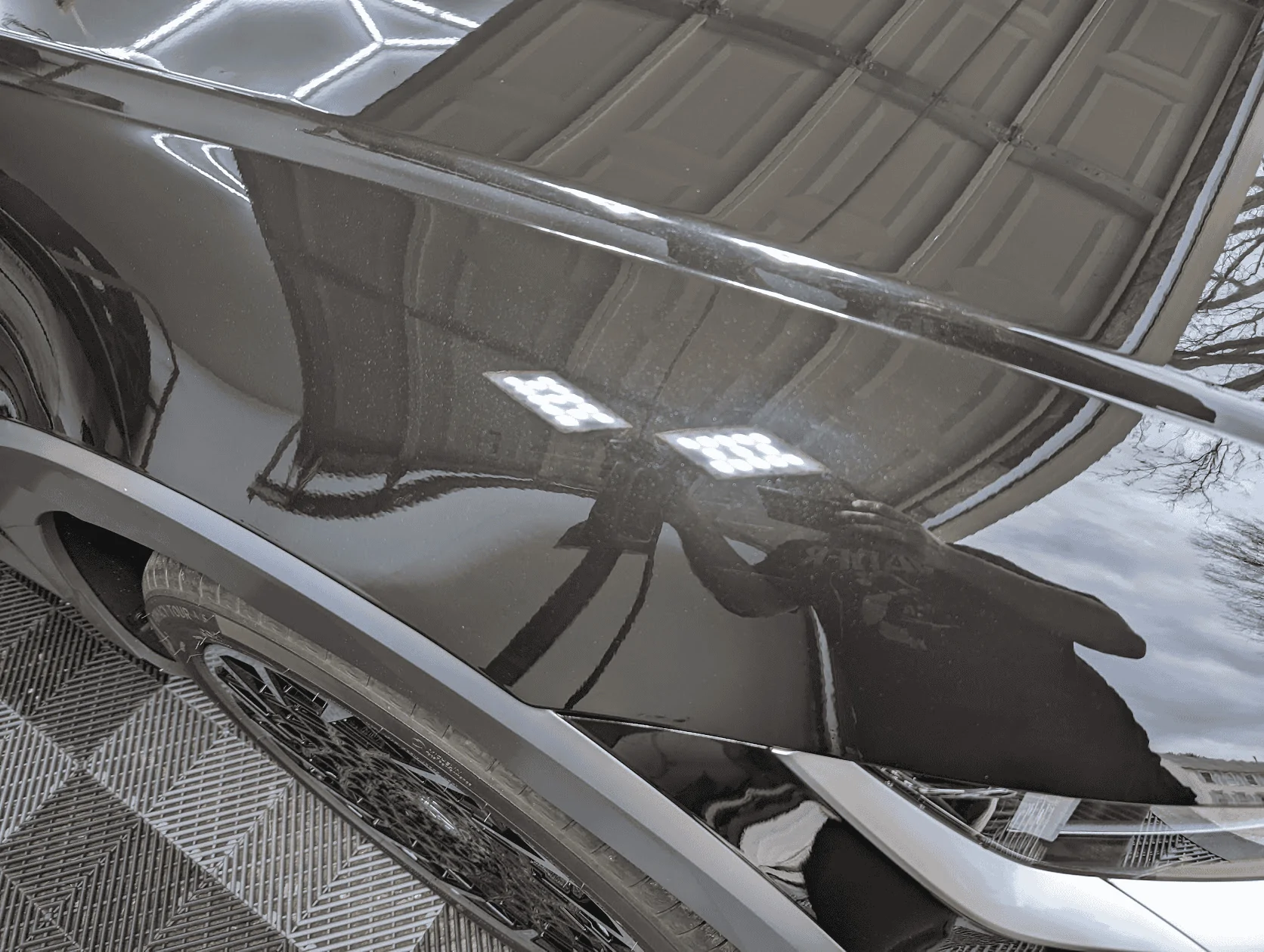

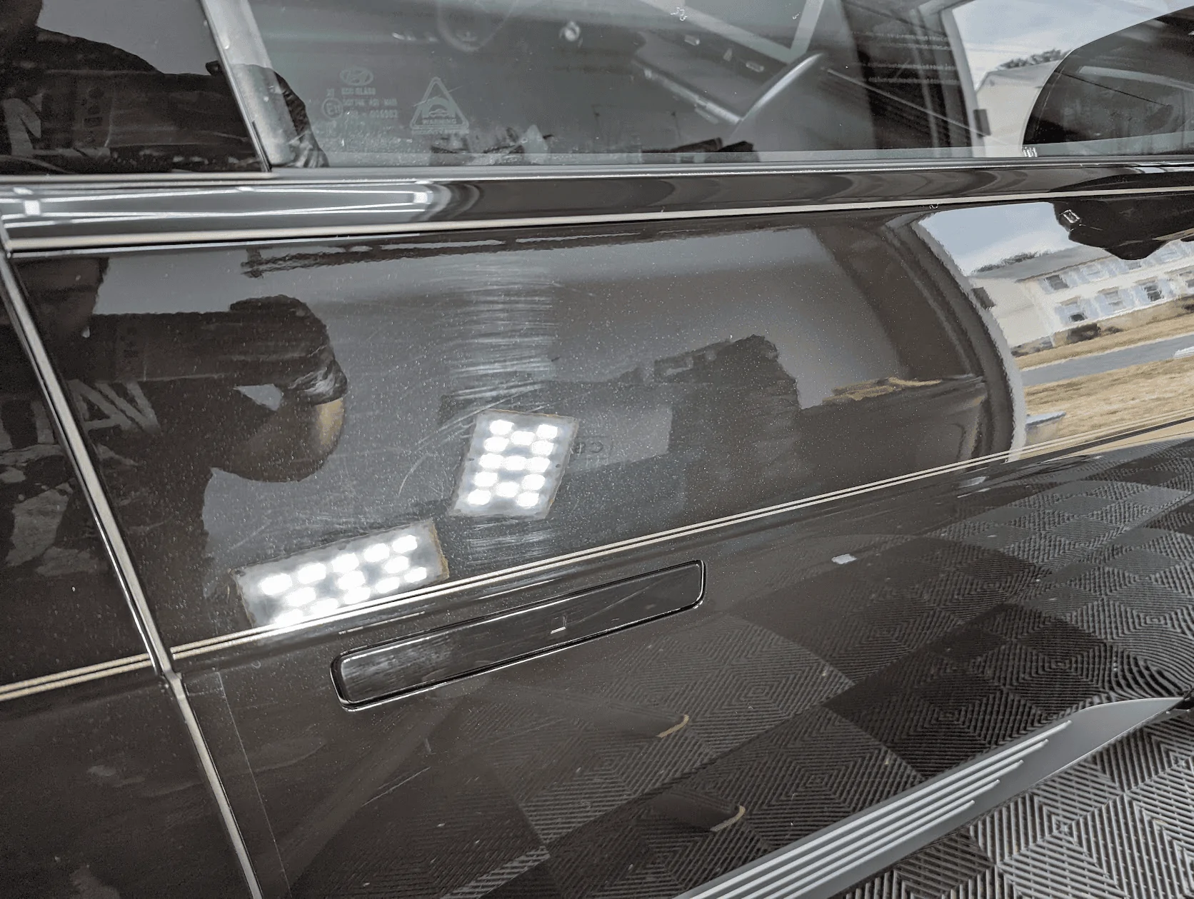

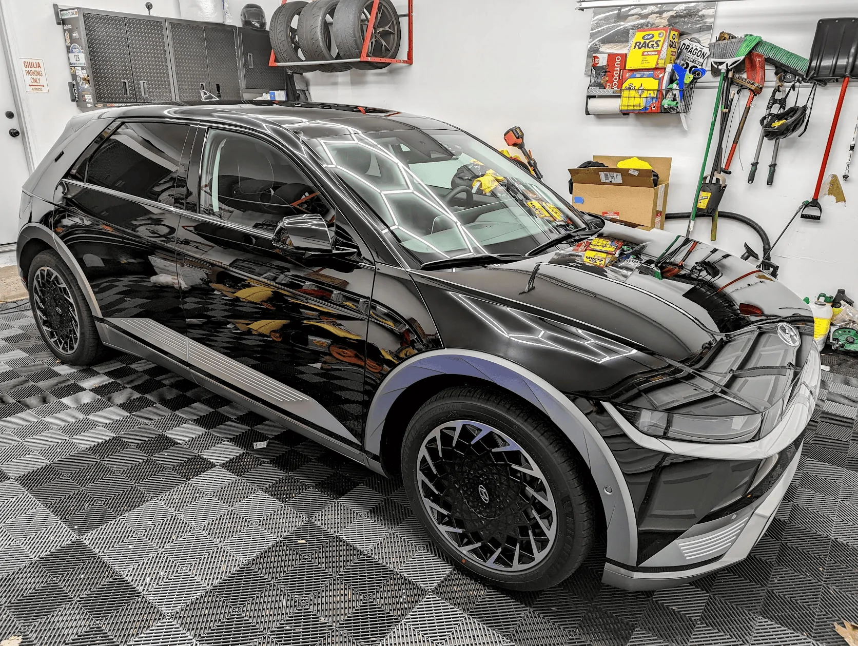

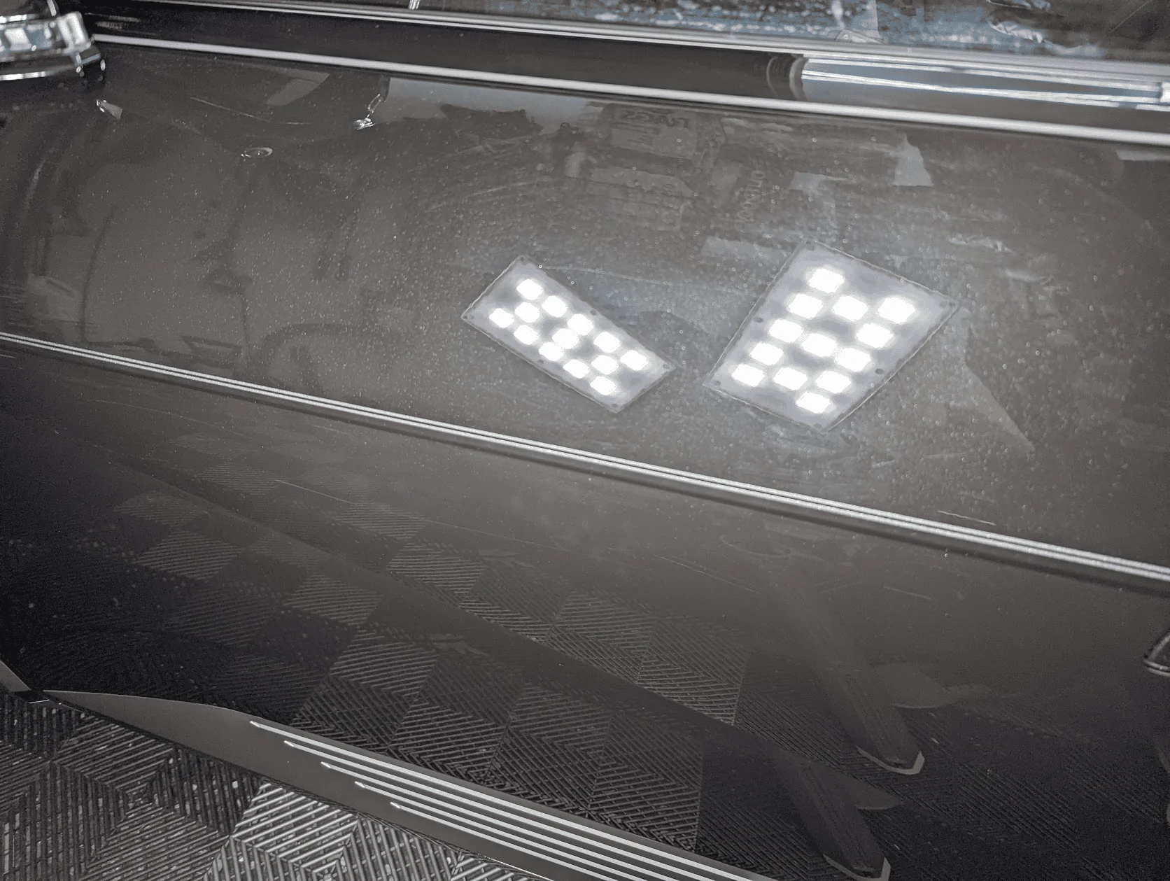

Just Detailed my sisters Ioniq5 and did Ceramic Coating.
Rivian R1T R1S Paint Care Protection Thread 1646623360772
Rivian R1T R1S Paint Care Protection Thread 1646623371603

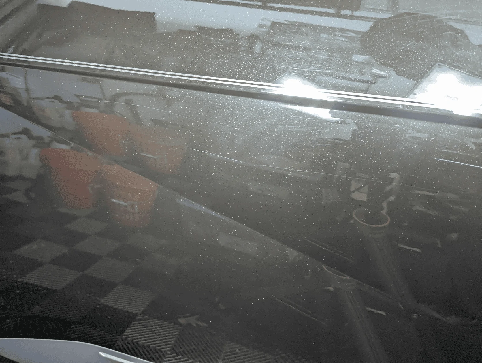

Paint it self being black was HEAVILY scratched/marked from dealership.
Rivian R1T R1S Paint Care Protection Thread 1646623397014
Rivian R1T R1S Paint Care Protection Thread 1646623411950
Rivian R1T R1S Paint Care Protection Thread 1646623438556
Rivian R1T R1S Paint Care Protection Thread 1646623464223

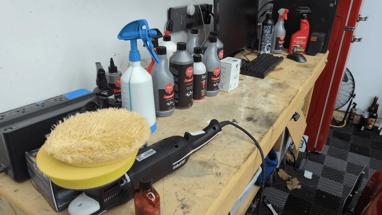

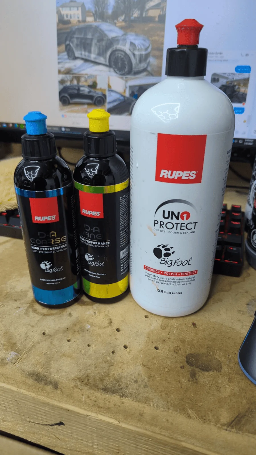

So I used the following
Rivian R1T R1S Paint Care Protection Thread 1646626708300

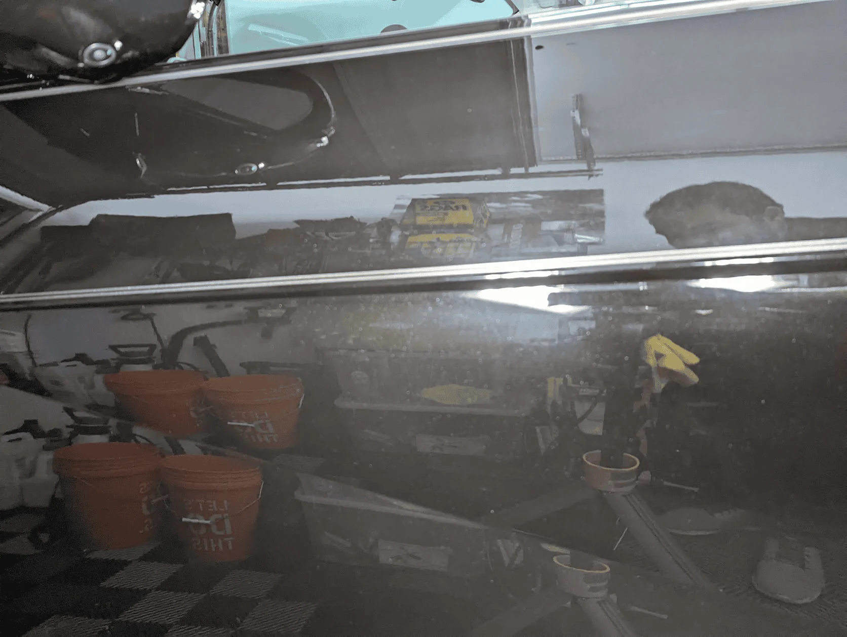

AIO is a great product for those who are DIYs but for black paint its a lost battle as for 1000% perfection its tough and you have to start cutting beyond AIO. I didn't want to go to deep so I was happy with taking care of 80% of the deep surface scratches and leaving a few things that you can only see with a inspection light.
Example: The same panel above with that deep scratch is now gone, all items you see are a reflection again 75% to 80% better because black paint lol.
Rivian R1T R1S Paint Care Protection Thread 1646626818437
After all correction was done, I applied glass wax to all glass surfaces and then used the ceramic coating to protect everything for 3 years (ideally 1.5) with the FICTECH coating pictured above. Result is

Looks good man! Sucks the paint was scratched from the dealer though. The black trim on my Kia was all scratched up too, but paint correction will fix it no problem. Love the contrast between the gray and black on the Ioniq, looks so mean.
SeaGeo
Brice
Jan 12, 2021
5,673
10,212
Xc60 T8
C+ at best, I hate when I get do something 100% lol. If you have an inspection light you are like OUCH. lol
I think you're being too hard on yourself. It looks great!

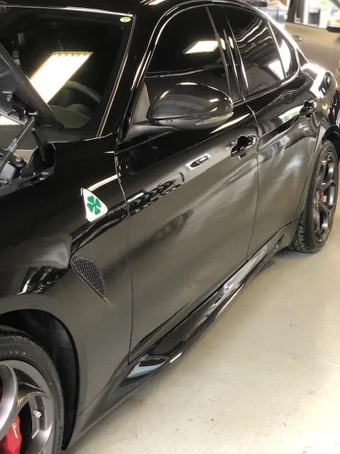

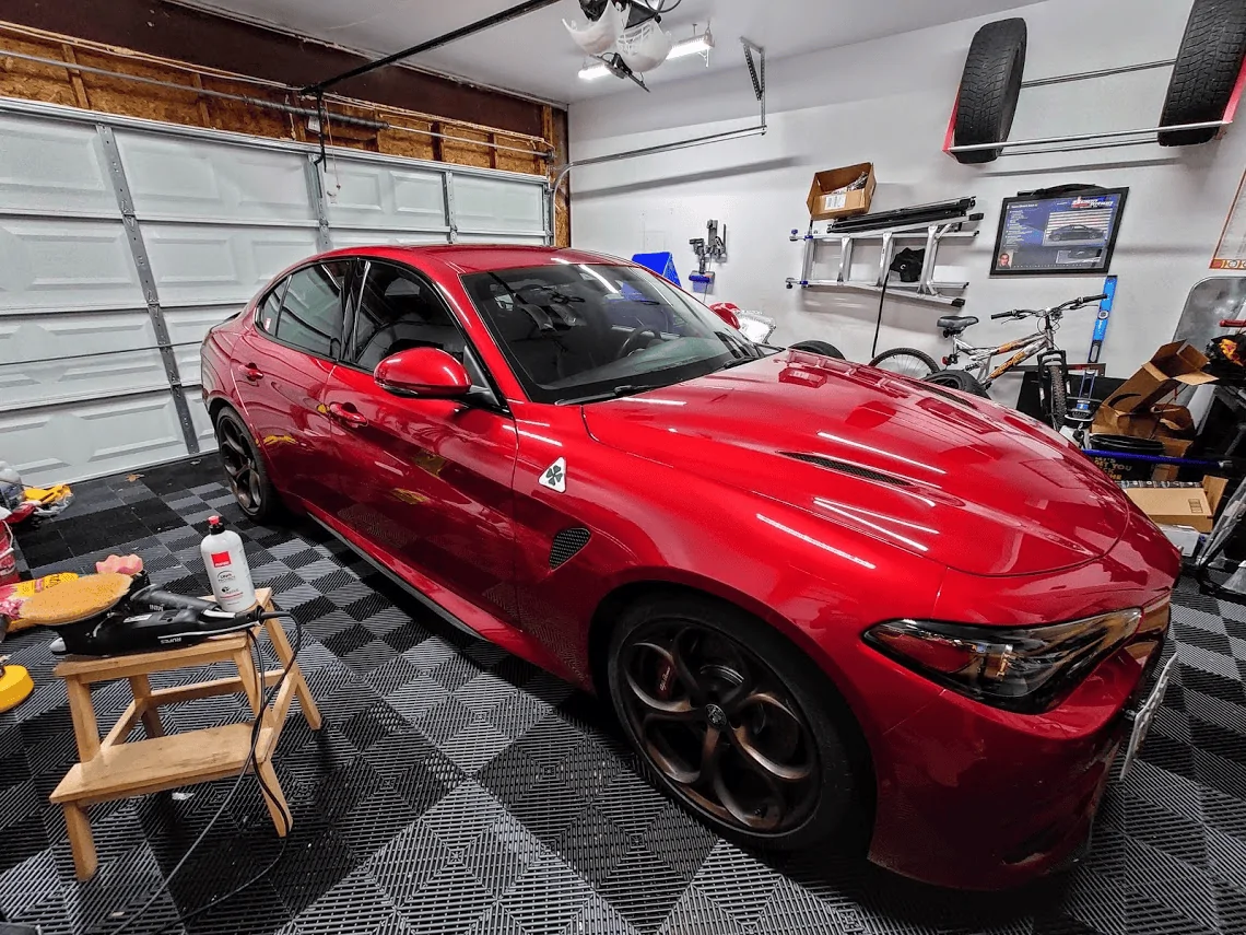

Huge fan of detailing/paint care etc though not a professional by any means I have talked with some of the industries best professional folks including Ammo NYC (who detailed my Alfa) and Detailers Domain

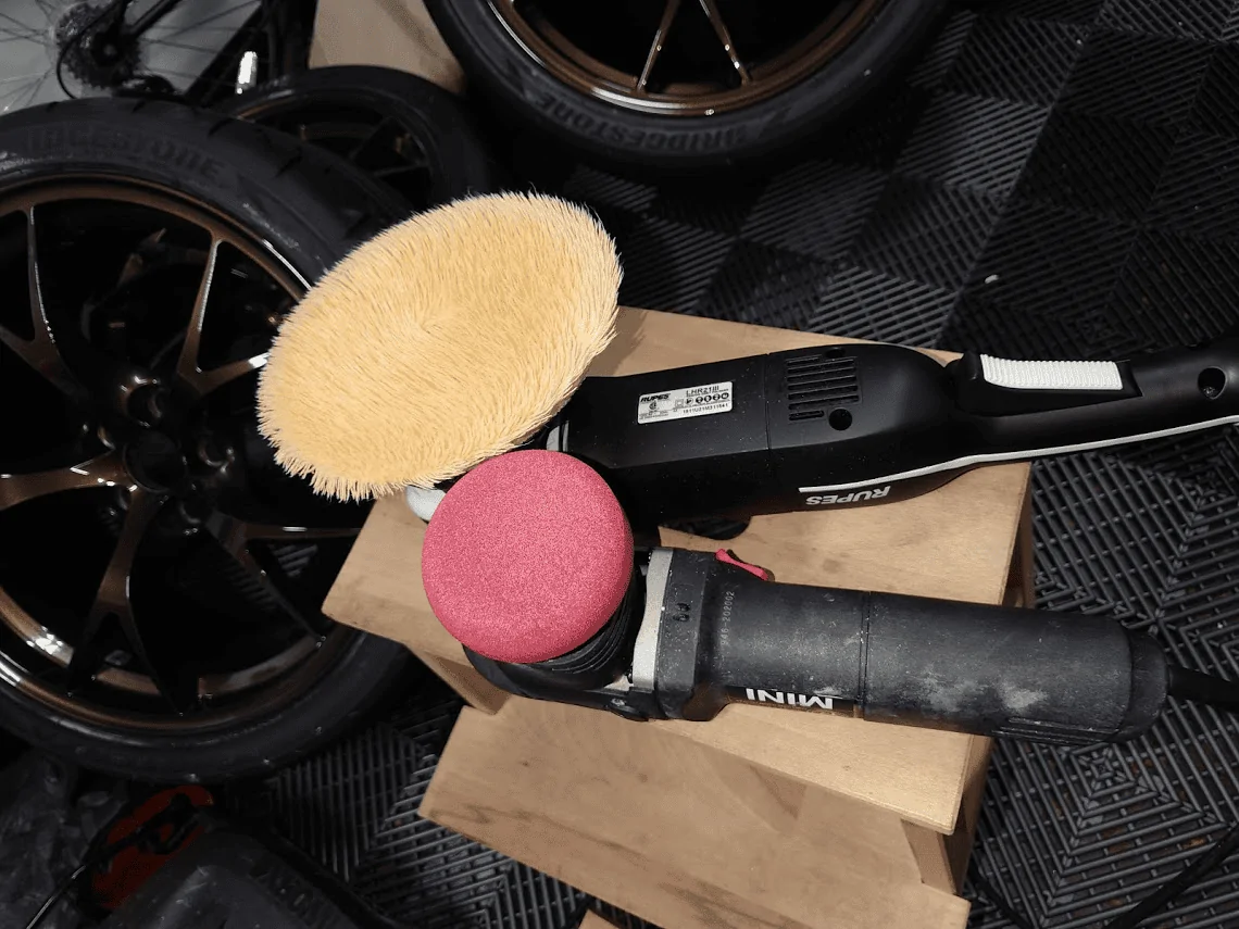

Below are some pictures of me working on my own items and again while I am no industry expert I have been doing things as a hobby for the past 15 years so I know a small amount.

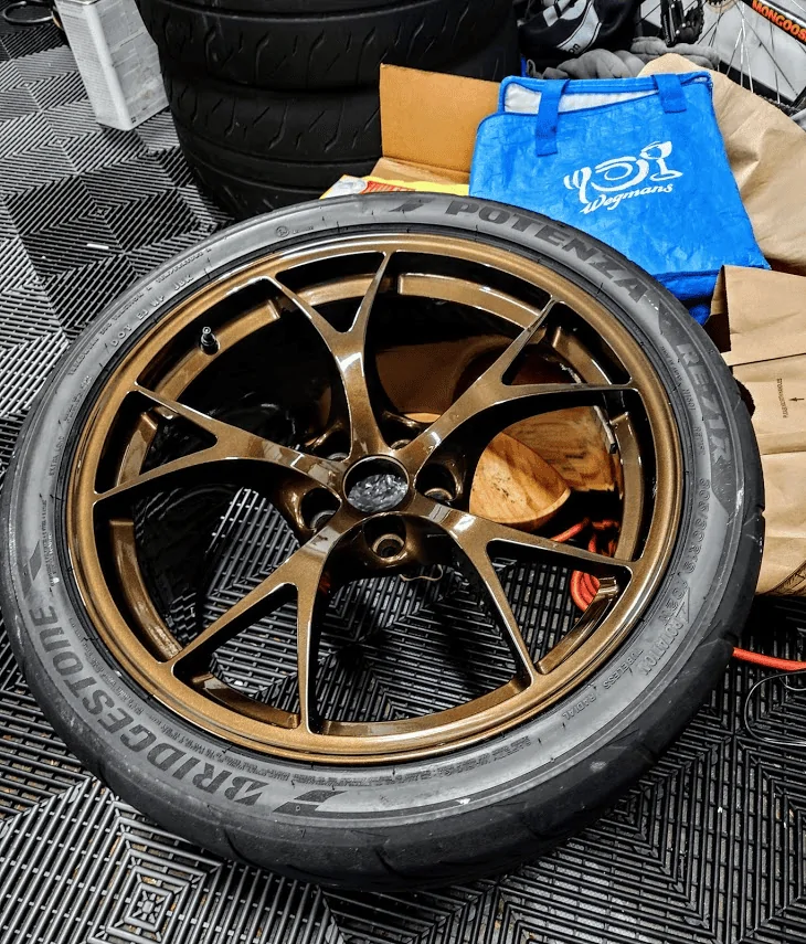

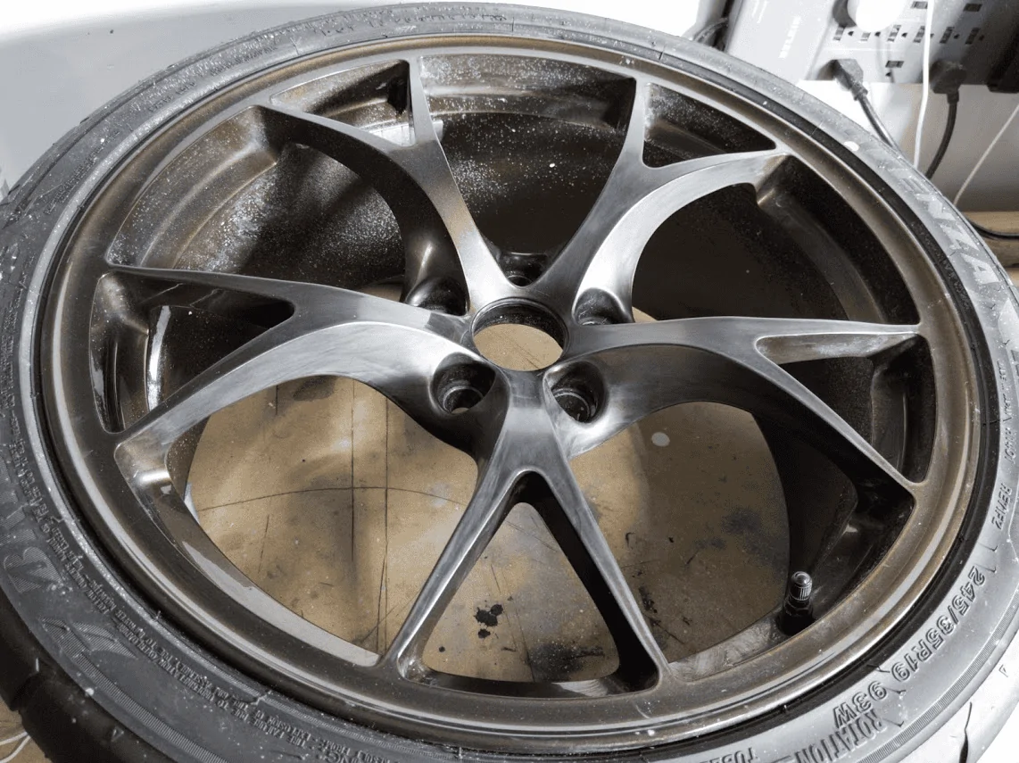

Before Wet Sanding/detailing on my track wheels that had a coating not cure in time and track debris stick to it.
After about 40 hours (per wheel) of wet sanding/high cut compound and then ceramic wheel coating added.

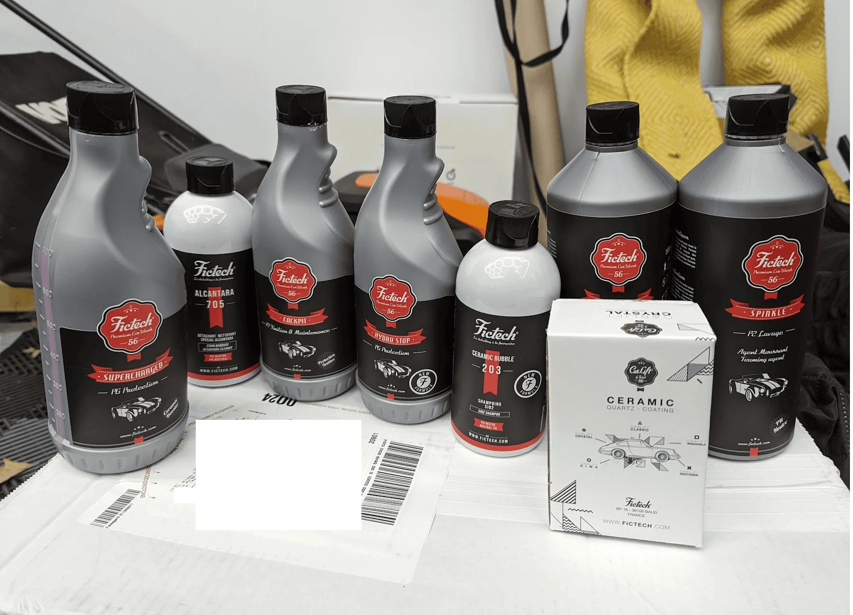

Here is a quick summary of my experience on products: Anything from your box stores are more or less temporary and kind of a waste of money with maybe the exception of Griots/Meguiars. Even then those are temporary at most a month or 2 of exterior care no matter what marketing on the box/label says in terms of Exterior paint protection.
My person Favorite is the Fictech line of products because most of them (with the exception of the ceramic coating) are super easy application, just apply when the car is wet and then wipe off. https://www.detailersdomain.com/search?type=product&q=fictech*

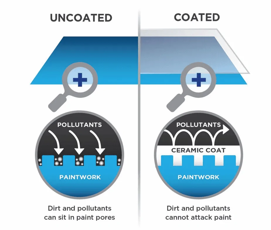

Ceramic coating is a liquid substance that turns hard once cured to protect the paint, here is a great example.
Keep in mind it will put a layer over your paint regardless of how flawless or un-flawless your paint looks so when a detailer says they will Correct your paint first and them coat it that is because they want to protect their work, slapping on ceramic coating after a car wash or from the factory which probably still doesnt have 100% flawless paint is a waste but only if your not really into the fine details of paint protection.

Love the quad! Thanks for the post.
Rivian R1T R1S Paint Care Protection Thread Alfa2
