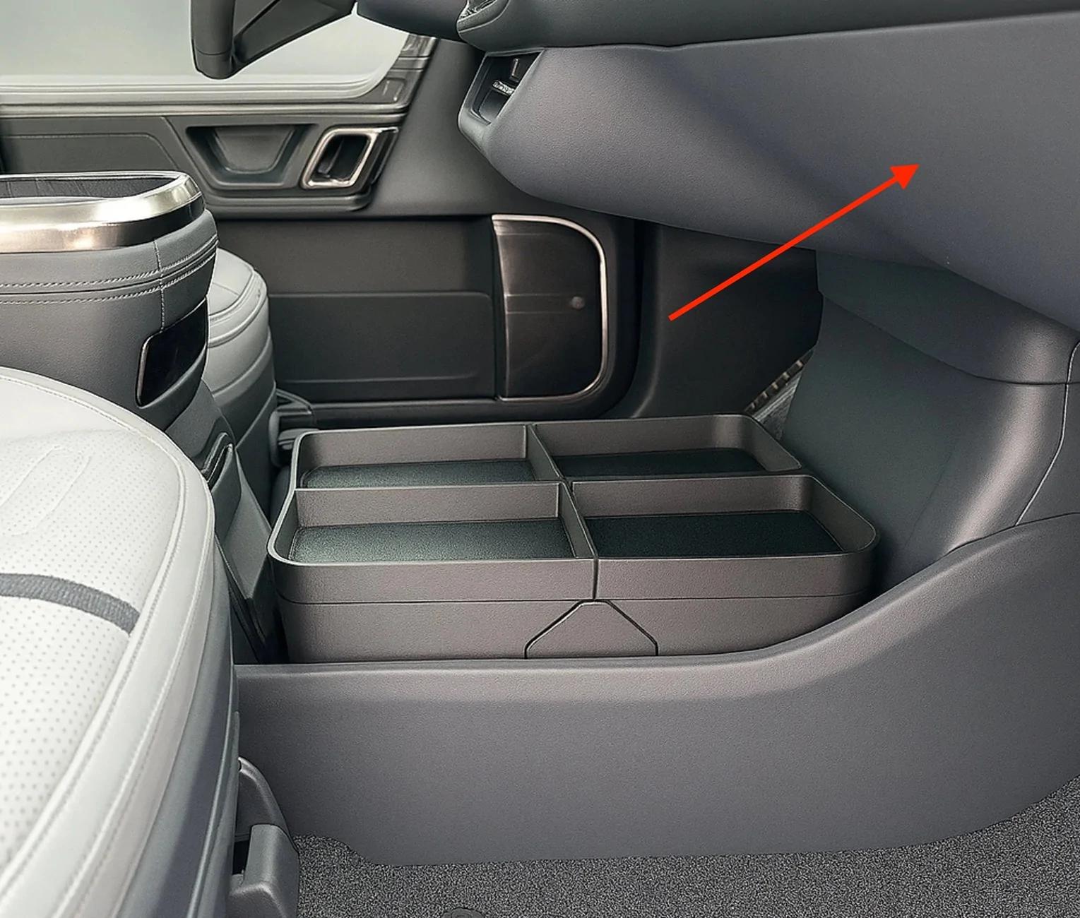

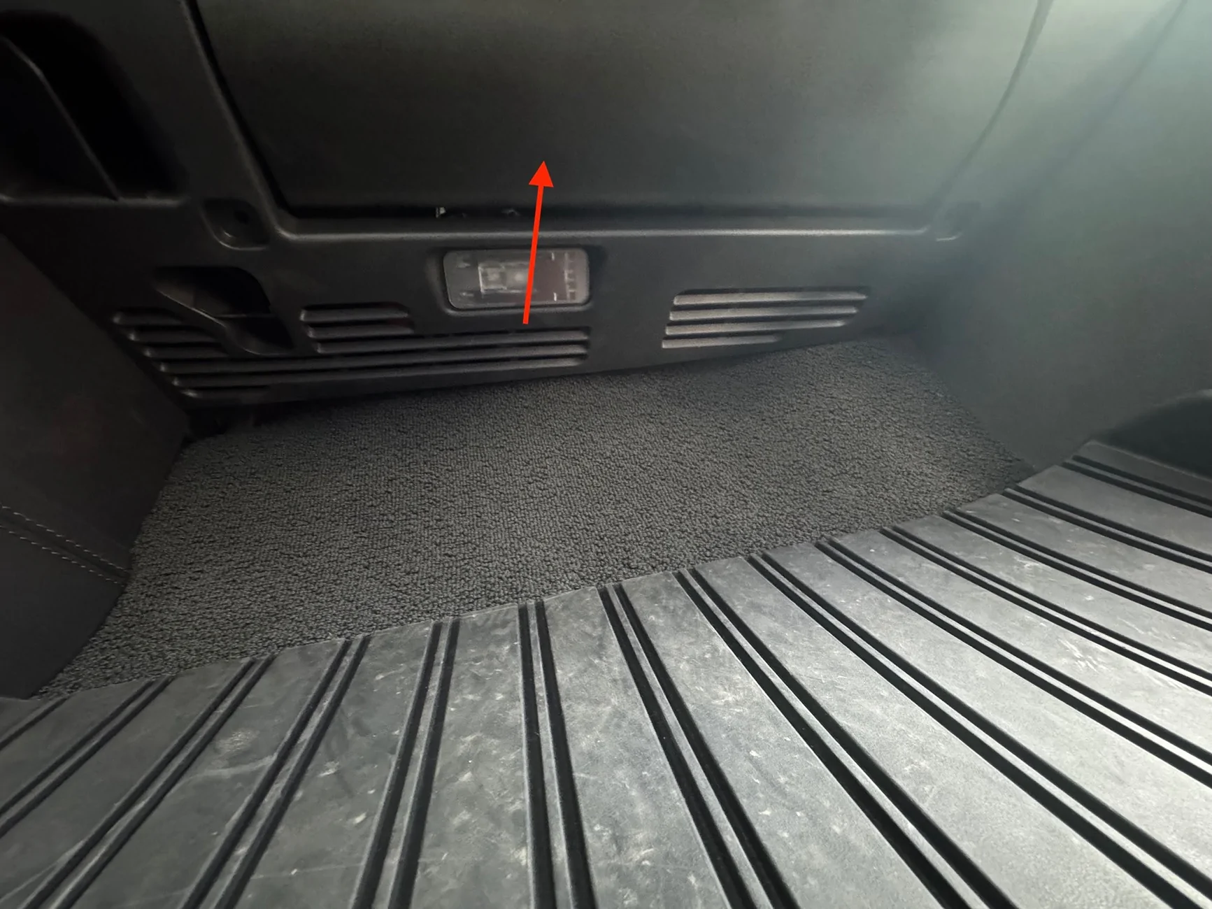

And the knee airbag seems to be flexible panel above the footwell?
Rivian R1T R1S Passenger airbag locations? airbag
I think I will need to remove this entire trim piece to do the things that need to be done, and it should generally be clear of explosive bits?

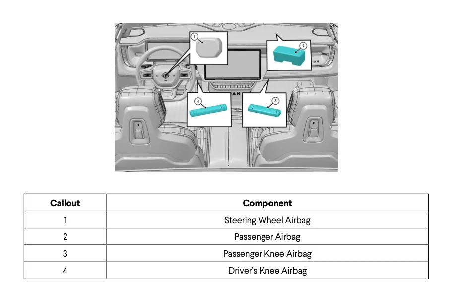

Check your Owner's Guide - it shows the locations of all the airbags.

does this help?
I've found quite a few pictures and videos of driver airbag deploys (and that's coming out of the steering wheel so easy to identify), but haven't yet seen where the passenger airbag is stored/deployed from.
Yep, I've seen the picture, but it doesn't show where the airbag deploys from on the dash. Is it above the wood paneling, below it, somewhere else?

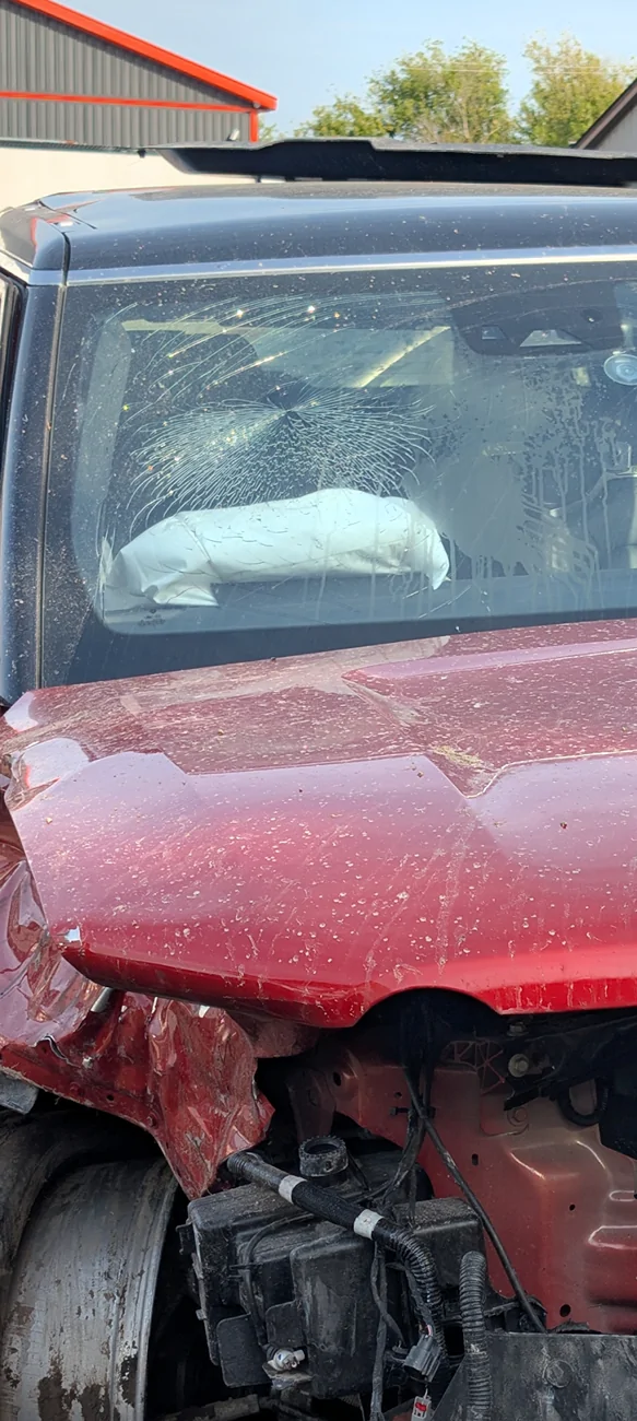

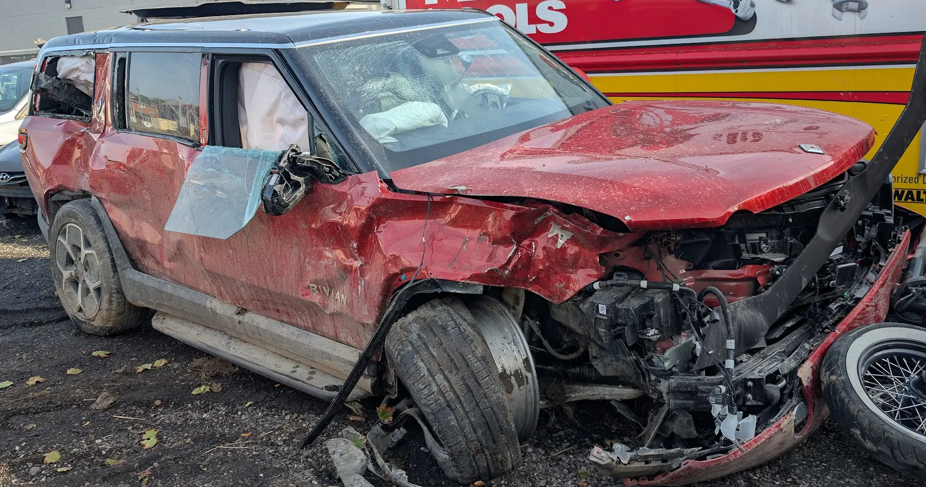

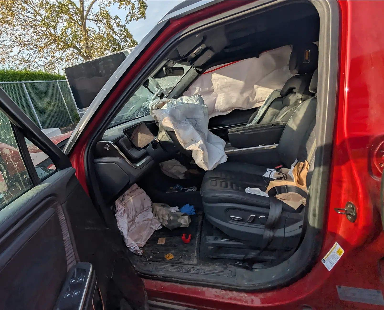

Man, it is horrible looking at these pictures, but that's exactly what I needed, ty.

Passenger airbags almost always deploy out of the top of the dash by levering the dash trim up with a cut-out.

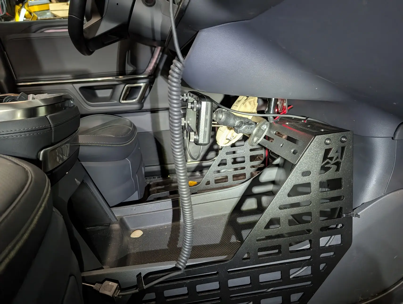

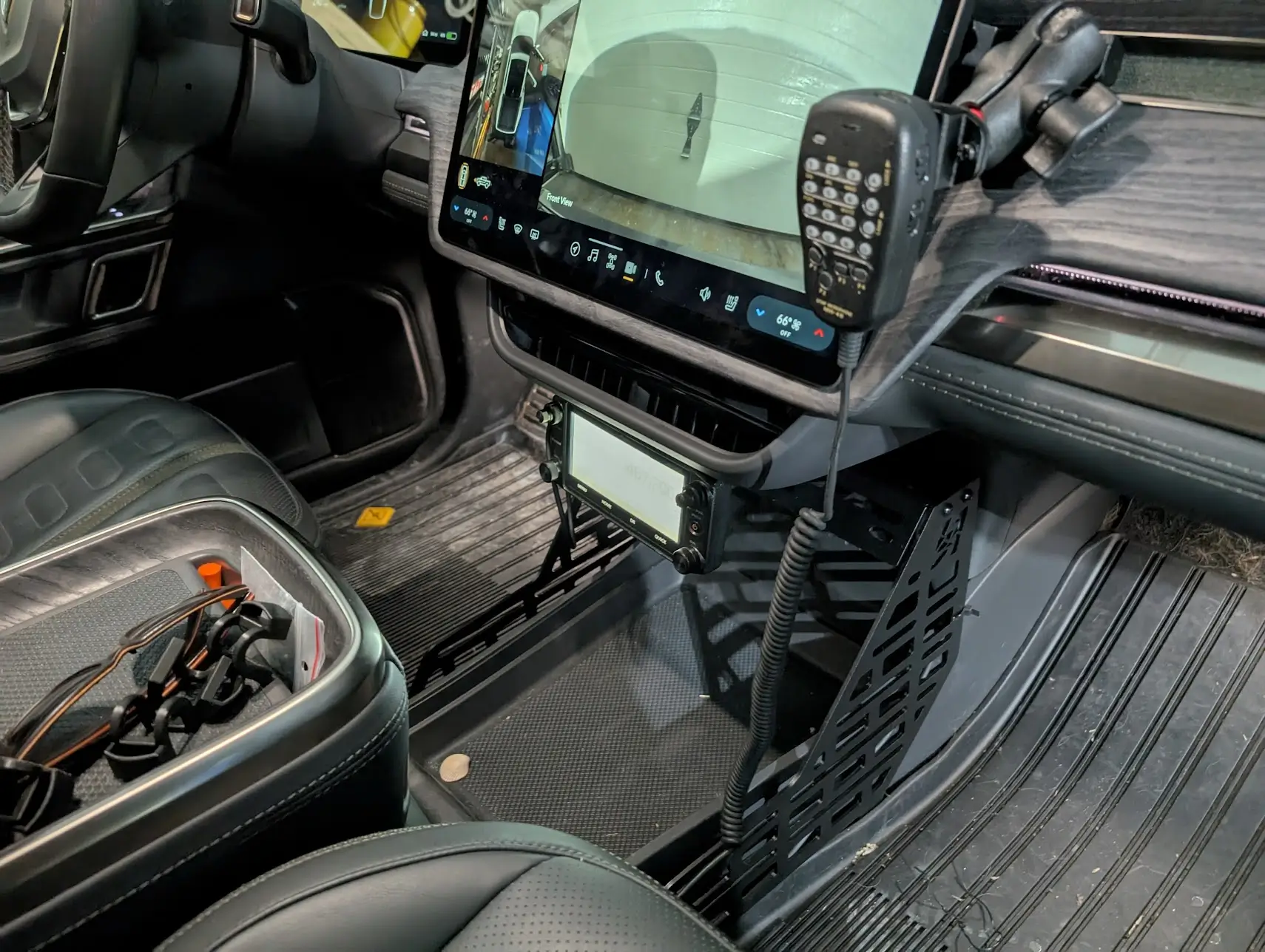

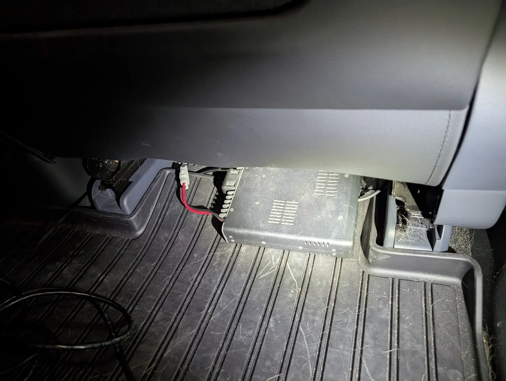

As an alternate opinion, I put my radio under the passenger seat and ran all the cabling from there. I thought it was a pretty non-invasive setup and had a by-product of having good ventilation on the unit. You can tuck it up pretty far under there depending on the size.

My wife and I walked away with minor whiplash - the truck saved our lives.
OMG is that YOUR crash?? So glad to hear you and your wife were OK coming out of it!!
Thanks for the pics! My kids are frequently in the backseat, don't think I can impinge on the footwell area too much (also I know the Gen2 12v battery is there, which may make it super-easy to route power, but probably means less space as well.
