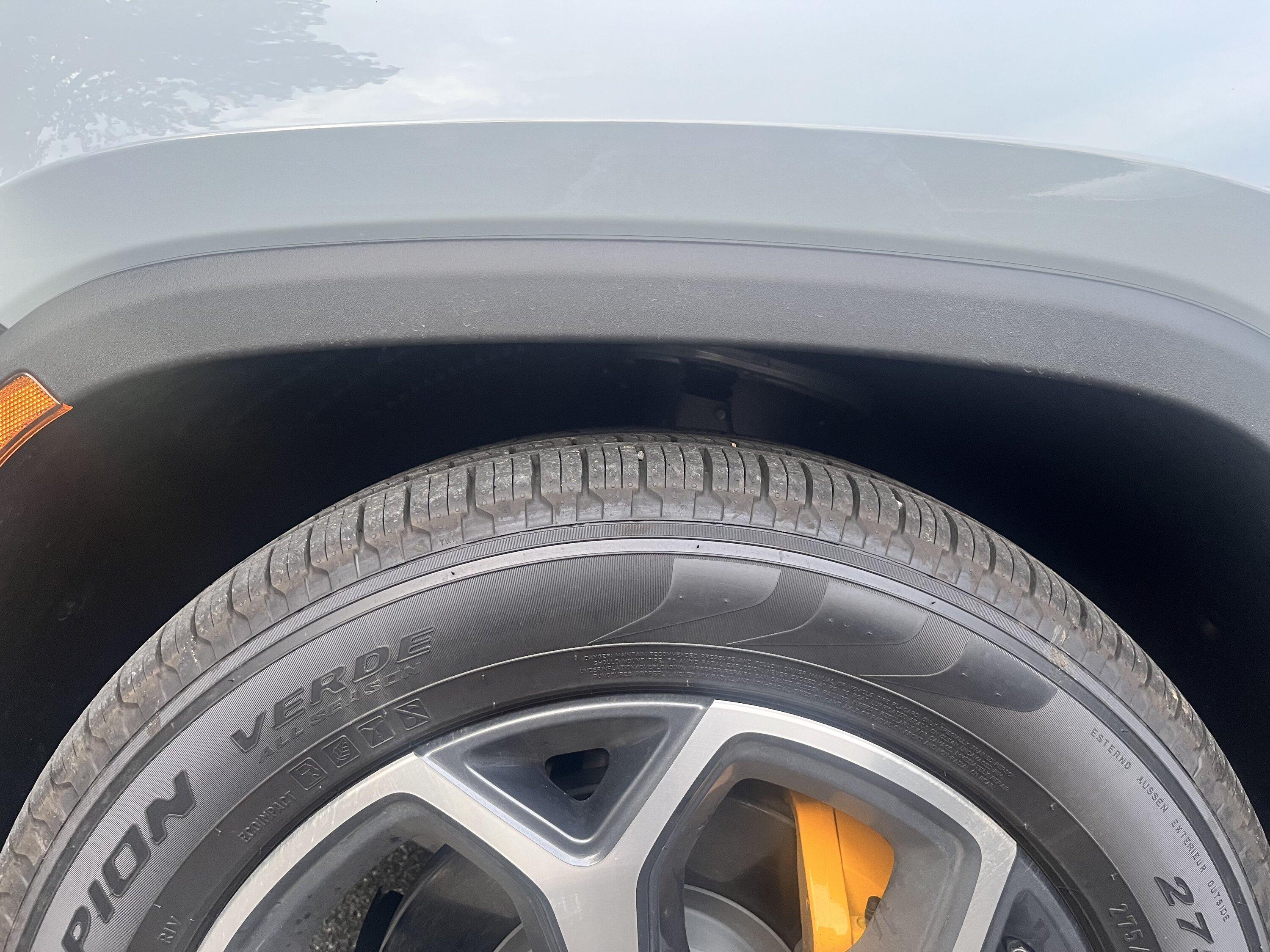

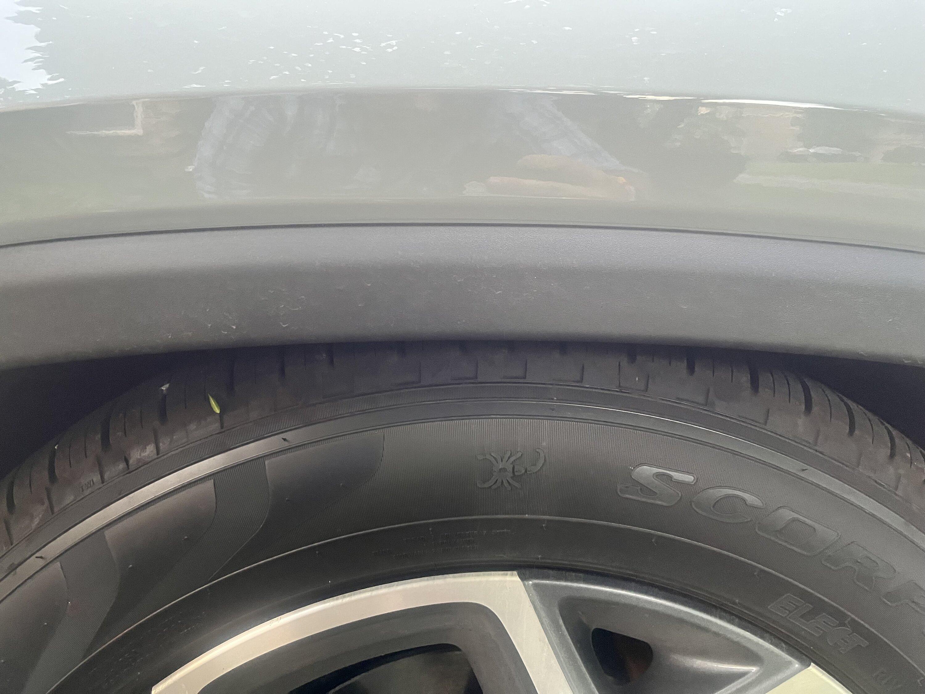

So I have this issue with my front driver side tire. If I leave my R1S for a couple of hours, or overnight, the front left tire ends up almost touching the top of the wheel well. Back tires are fine and front right dips a bit, but nowhere near like front left.
Good news is once I get in the car, it adjusts to the right height (after giving me the terrifying - "car is raising, don't drive to avoid damaging car" alert). But it then leans way down after being parked every time.
I don't use kneel mode (I stopped a while ago), I tried turning off auto height adjustment, parking in different ride heights, etc.
Rivian doesn't seem concerned as they gave me an appointment at the end of October. Seems like a clear leak in air suspension to me. Here is a pic...it actually gets much lower than this. This is after about four hours. Started at the "All Purpose" height - shown in the bottom photo.
And before anyone asks - yes, that's Limestone and actually a good example of how different it can look it different lights. I love it.
Anyone had this solved by their SC? Doesn't seem like a ride height sensor, but I have no idea. I am concerned about leaving the car for a couple of days, but Rivian said not to worry...

I've had both front dampers replaced on mine and had the same warning. Though my truck would not automatically raise in that state and I had to toggle the ride height in order to get to from kneel to standard ride height.
I reported last October and my appointment was in February if that helps.

Your vehicle will have a code about a leak, service will be able to address it for sure as they did mine. Meant a replacement damper for me.

Very helpful. Thanks.

Super helpful, thanks! Seems to operate fine once I start, but somewhat alarming when truck clearly leans to the front left. How long did they take to repair it once they got the car?
