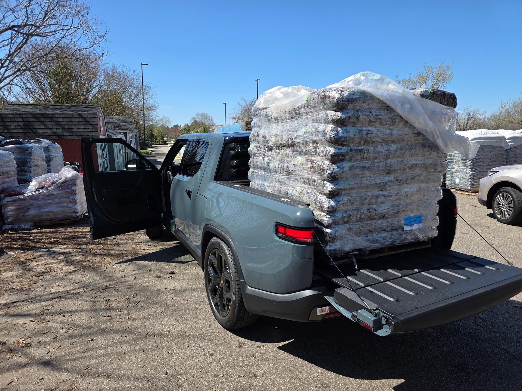

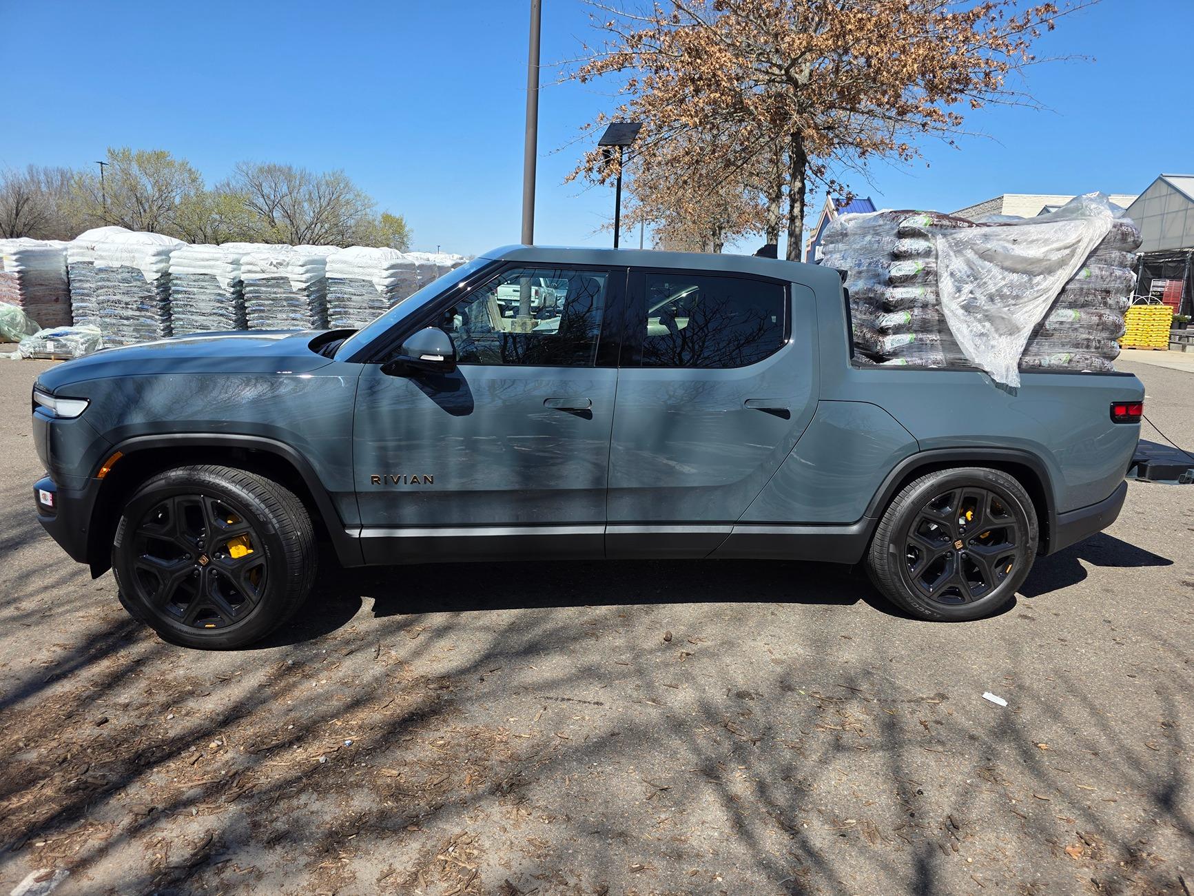

I don't know how much these 60 bags of mulch weighed, but if they were 30 lbs a bag that was 1800 lbs, not including the pallet. You can see when I had them loaded the rear sagged. But when I started the truck it leveled out as you can see with the shot I took when I got home.
Rivian R1T R1S Payload and Air Suspension 1000000271
Rivian R1T R1S Payload and Air Suspension 1000000270
Rivian R1T R1S Payload and Air Suspension 1000000272
I think you should be fine filling the cistern, but if the path to your place is rough, it is probably more risky than the smooth roads I went on.
I had it in All Purpose, Standard height.
