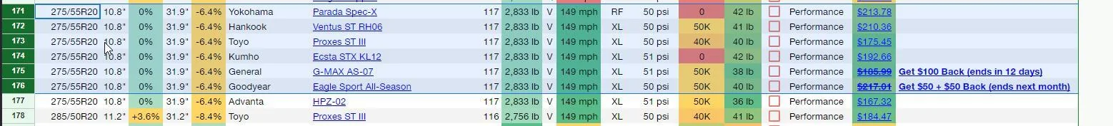

Curious if anyone has tried on performance spec tires on their 20 inch wheels?
From the often shared Rivian tires spreadsheet, I found these options below. Anyone have any impressions/experience with these tires? I know the best option probably is to upgrade to the 22inch rims with the new Pirelli Scorpion MS tires, but that's looking a bit too pricey atm.
Rivian R1T R1S Performance tires for 20 inch rims 2024-10-19 13_38_17-Rivian R1 Tires (bit.ly_riviantires) - last updated 10_5_2024 - Google Sh

You may have fewer takers as all of those tires are smaller in diameter than even the stock 21/22 setup.
Are there no performance tires in 275/60R20? Those would have the same diameter as the 21s and 22s.

Performance tires generally have a smaller sidewall. For performance you’d want a 22” wheel…is something that’s not 7k pounds.
there doesn’t seem to be any tires close to the standard 20 inch sizing. Seems like my best bet is to suck up and get a 22 inch rim+ scorpion AS

Michelin Pilot Sport S 5 that is factory spec for gen 2 quad. The same sme tires that set new record at this year’s Pikes Peak. Get aftermarket wheels from Atomic. Run same staggered tire sizes or all fronts. The factory gen 1 Scorpion AS aren’t performance tires.
