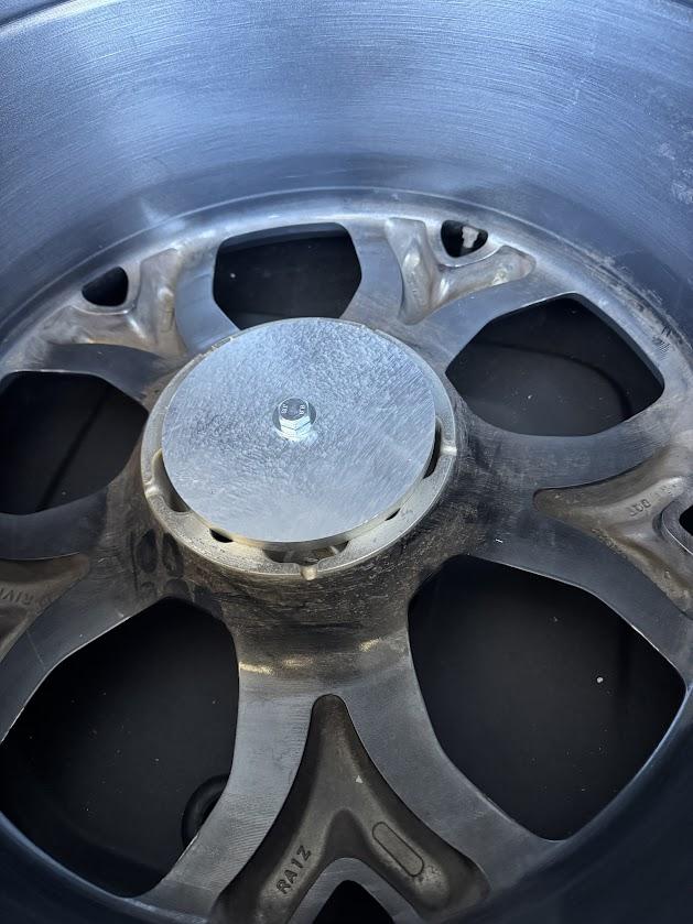

Yeah, I didn't really ask the question I was thinking - using a 21" as a spare:
1. Is the linked screw long enough to clear the height of the wheel but short enough not to bottom out at whatever is at the end of the spare tire well? Sounds like the answer should be "yes" to both?
2. Is the screwhead wide enough to secure the wheel down by itself, or do you need some kind of large washer to get over the diameter of the center cap?
babock
Bruce
Dec 6, 2024
141
111
Los Angeles and South Lake Tahoe
2025 Rivian R1T, 2024 GMC Denali 2500HD, 2022 Hyundai SantaFe PHEV
Retired Electrical Engineer
I am using a 21' spare too. The bolt I bought is 120mm long and I have a 1/4" aluminum disc that I bought at an industrial metal supply that's near me to hold down the wheel. My collapsible lug wrench set has a socket that fits the bolt
1. I'd expect the offset to be the same or very close, so it would fit. I cannot verify that.
2. No, you need a giant washer, which is what I linked to... The pipe plug is your giant plastic washer with an exact fit.
