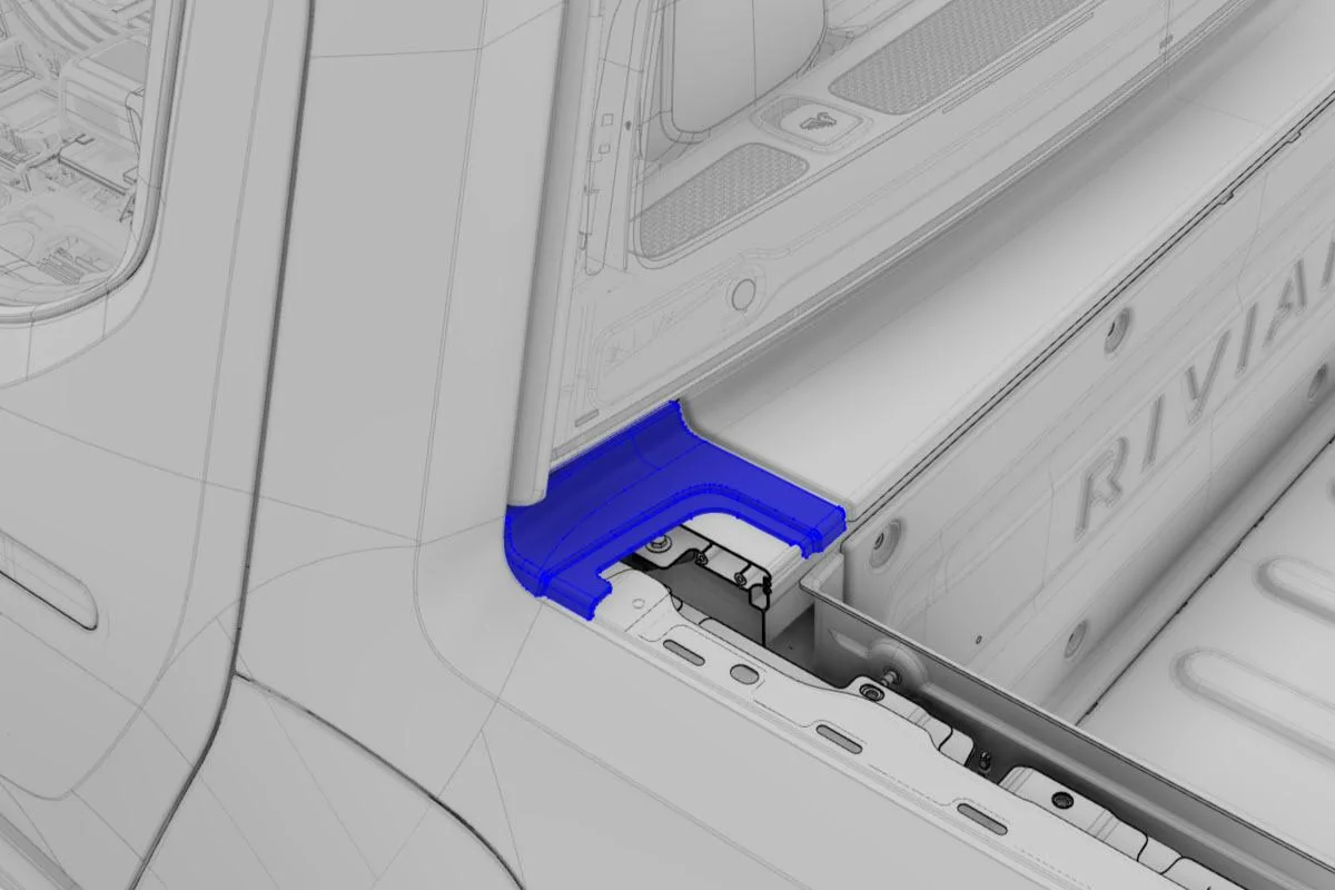

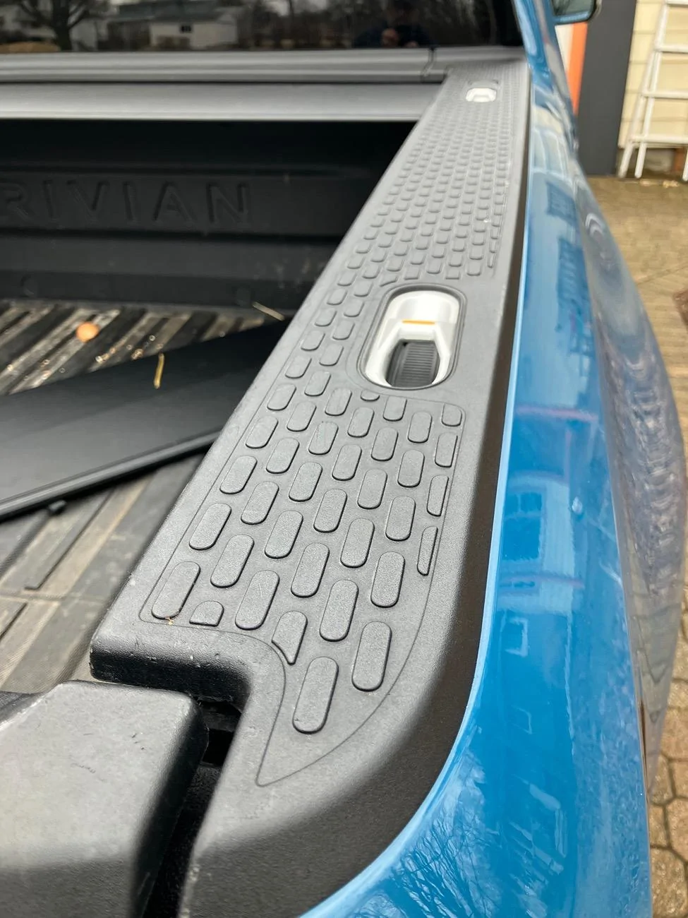

I need to get a little PDR work done on upper portion of right rear quarter panel (fender) and the technician would like to access through an opening under the top trim, if possible. Has anyone removed this trimand, if so, do you have any photos and description? I am attaching a photo of the trim piece involved.

I've removed it. Accidentally. It's not bolted down in any way, it's just clips. Lift on it enough and it pops off. Here's the kicker though... Rivian designed this piece as one time use, for reasons beyond me. So when you pull it off, the clips don't really work anymore. The teeth on the break off or they pull off the part and bend some. You can make it work and reattach clips and reseat things but it takes some work to modify the clips a bit to bite on the trim piece before pushing it back in place. Dumb design honestly.
Before you pop it, would recommend searching YouTube for teardowns to see what things look like, just to make sure you'll have the access you expect when it's off. Will be super annoying to pull it off only to find there isn't the access your PDR guy needs.

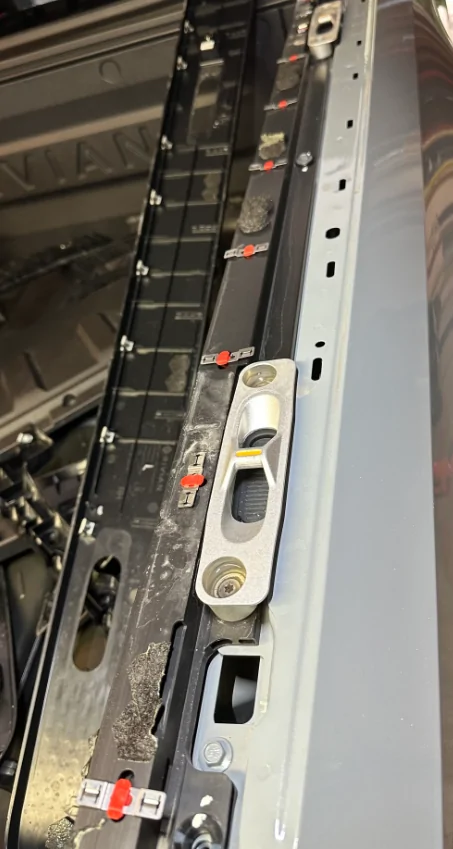

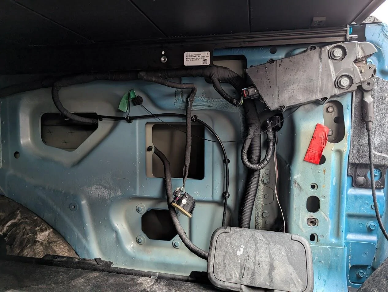

Best I could do
Rivian R1T R1S Pickup bed top trim removal 1000002960
Rivian R1T R1S Pickup bed top trim removal 1000002961

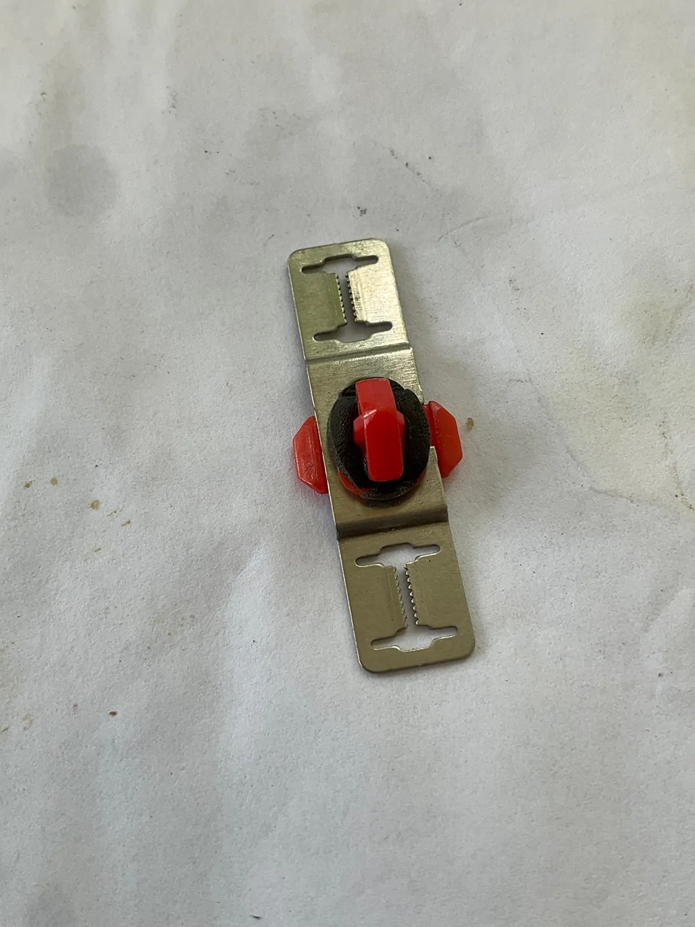

CAUTION:
Potentially non-reusable fastener(s).
147
13,522
27,291

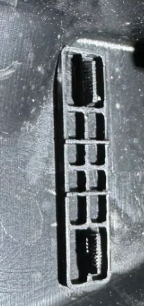

The clip and the plastic they attach to. Pulling these clips tends to cause the clip to bite the plastic off that they attach to, so reattaching afterwards is nearly impossible without being well versed in plastic repair.
Rivian R1T R1S Pickup bed top trim removal 1741184131557-bj
Rivian R1T R1S Pickup bed top trim removal 1741184141158-n0
You don't gain access to anything by pulling these panels off that would be helpful for PDR.
Rivian R1T R1S Pickup bed top trim removal 1741184343256-cg
You'd be much better off removing the side panel of the inside of the bed.

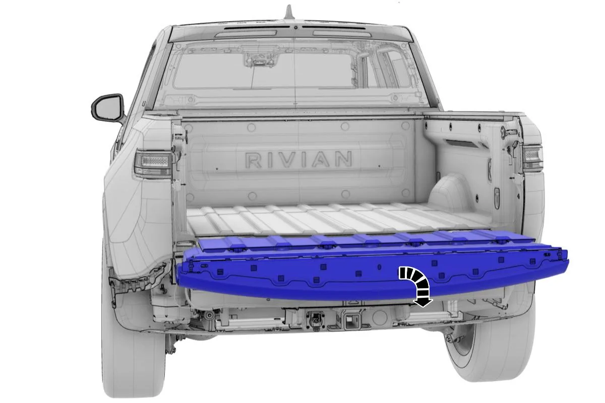

I have removed the upper trims from sides and tailgate. All of the “red” clips and a few others broke but many are still intact. As you stated, it is difficult for me to see how the red clips can readily be re-attached to the trim. So I got to thinking….danger. How about using any existing usable/functional clips and in areas of broken clips (or perhaps the entire perimeter) fasten the trim down with 3M Super Weatherstrip Adhesive? Weight the trim down while it cures and to remove trim, slide a plastic putty knife under it.

That's how they install the newer tailgate trim with 3M tape. There's probably no reason you couldn't do that with the other trim pieces.

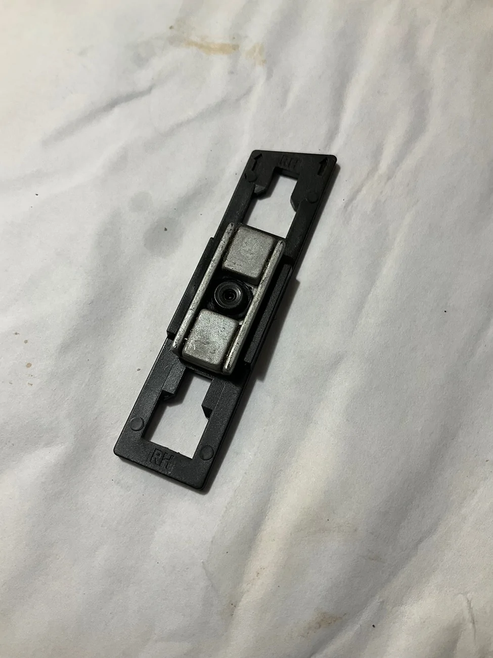

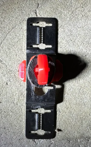

I just got done re-installing the three upper trims. All of the “red” clips pulled off of the trim piece but I cut off most of the remaining plastic “boss” on the trim piece, leaving only a little stub on each end for alignment. Kinda tedious and may have been easier to remove the teeth from the clip. Glued the clips back on with JB Weld clear. Seems to be ok. I have two extra each of pictured clips. These took about a month to get from Rivian. If someone can use them, I would be glad to mail them.
