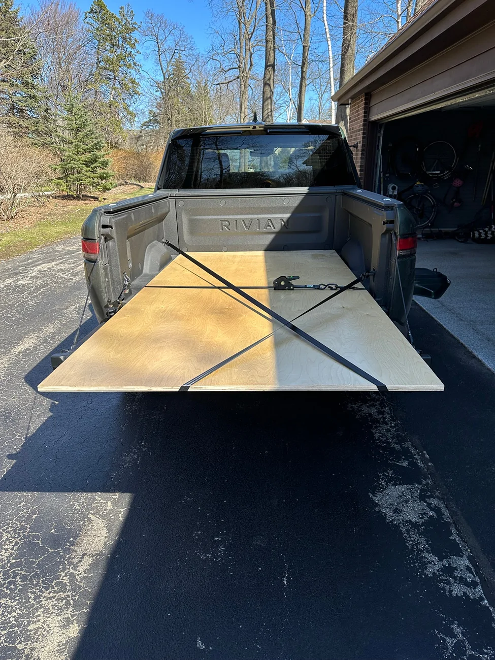

I'm new to owning a pickup truck and just got an R1T a few weeks ago. Got the R1T in part because of its ability to fit full sheets of 8x4 plywood laying flat.
Cabinetry is one of my hobbies so I'm often moving heavy and expensive sheets of 3/4" plywood, but I've always rented a u-haul to move it in the past.
I'm looking for feedback on my practice sheet (see image). My thought is one strap will go around the bundle of sheets to keep them compressed together, and then two straps will go diagonal from a side anchor and then terminate at one of the lift gate metal brackets.
I'm definitely over thinking this but I want to act like I know what I'm doing next time I go to my plywood supplier and the fork lift guy helps me load up the truck😅. Appreciate any tips or feedback.

Your setup is fine I just criss cross rear anchors the sheets don't move at all. With dimensional lumber you want to bundle it all together too.
I don't recommend using anything other than the anchor points on this truck for heavy loads.

Thanks, that seems obvious in hindsight and I should be gentle on those liftgate hooks.

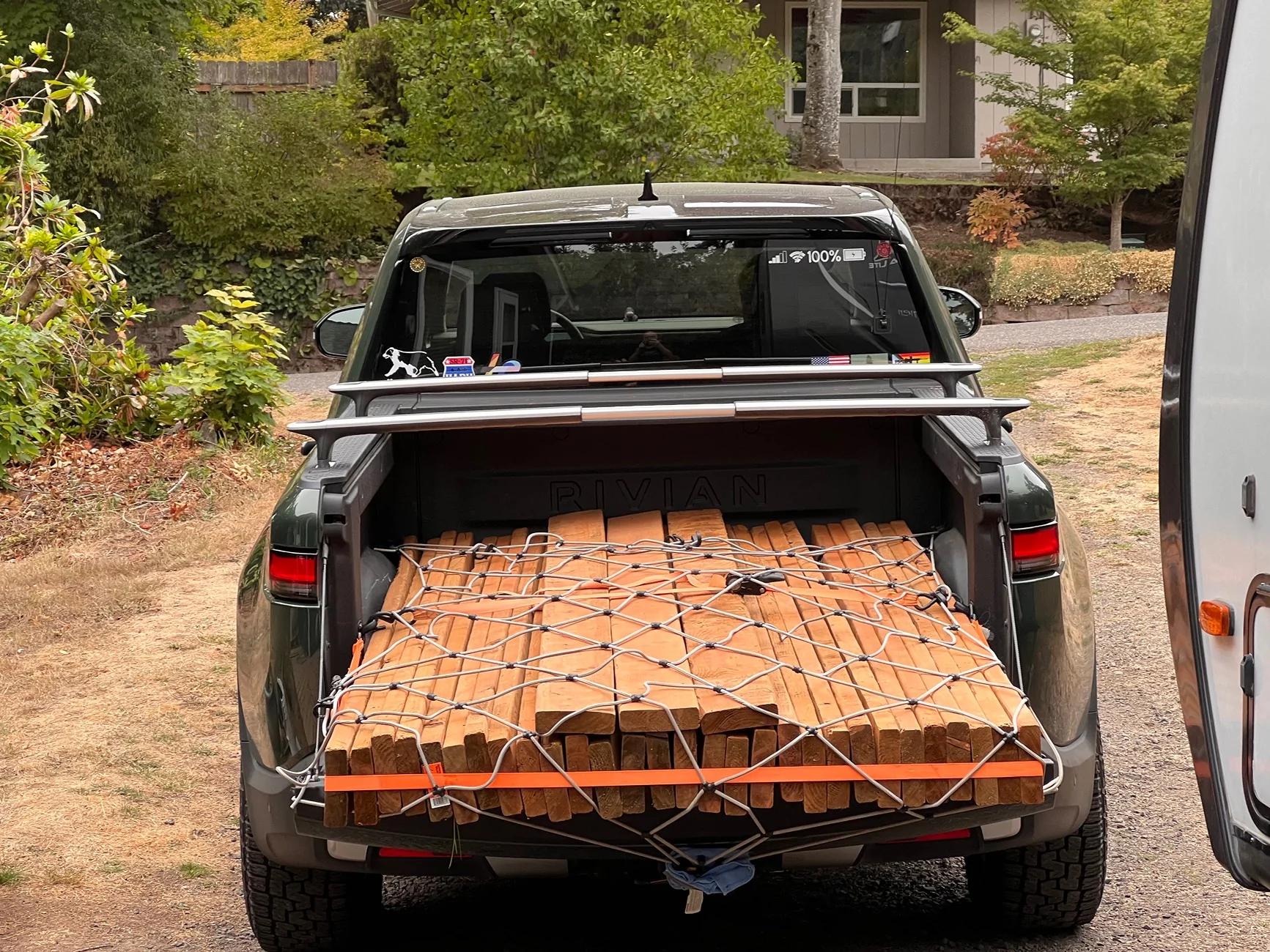

I recently hauled several sheets of PVC lattice, along with the subsequent supports. I bungee corded the whole load.
What helps to keep the load from sliding is I bought an aftermarket rubber mat that is custom for the bed of the R1T. Whatever I've put in there is gripped enough to not slide out on acceleration (learned that lesson many years ago...). The strap around the trailing edge is still needed.

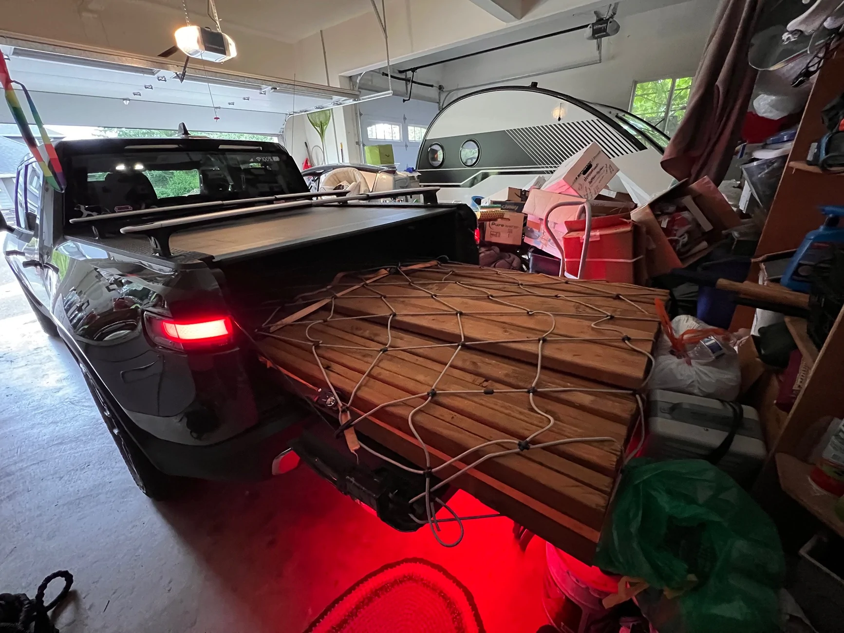

If you haul often, you may want to get an extendable tailgate net. I have this one:
https://a.co/d/0chNNexu
I’ve been wondering about the metal flip-style bed extender. This netted option seems like it could work better for my occasional needs. The flip-style extender would work great for lots of containers or an ATV, but with the rounded corners I don’t think it would hold 4x8 sheets of plywood.
