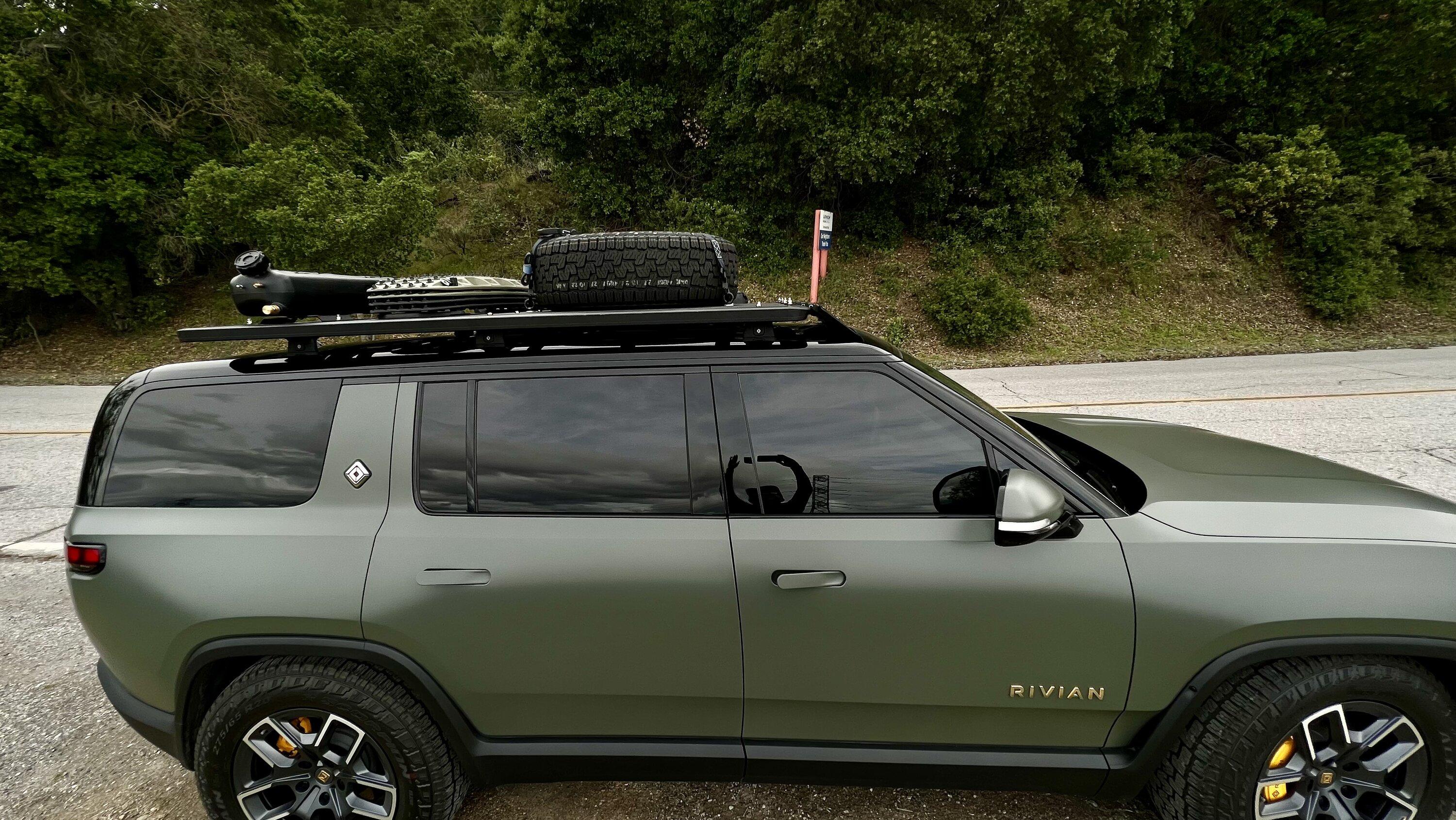

84x56 rhino rack fits over crossbars
Looks great. Thanks for sharing. How is the range hit? Does it cover the top glass completely? And you wouldn’t happen to have an extra bar hanging around would you?

Still get light through glass just less. I like planks are wide so you can walk on top.

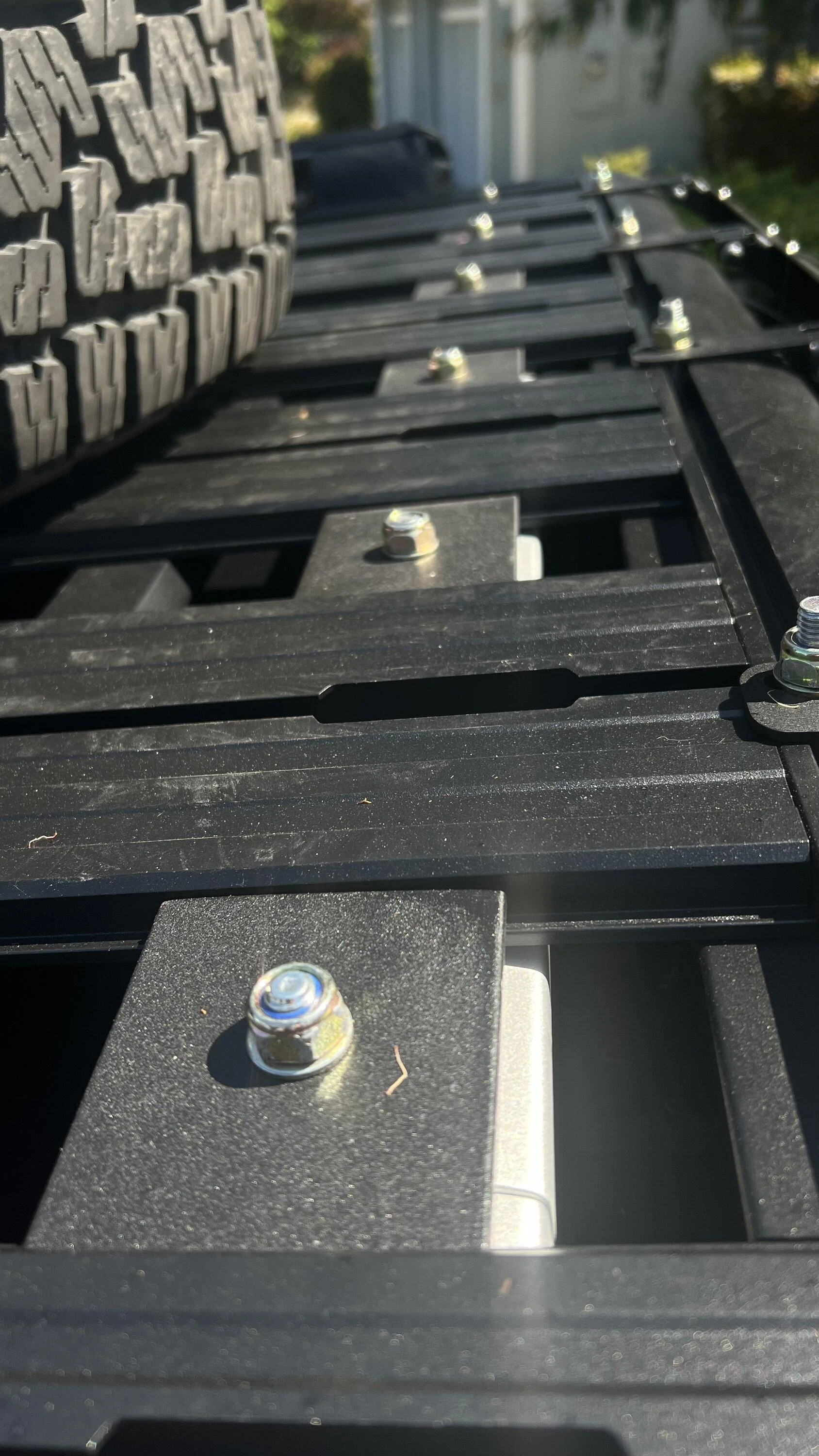

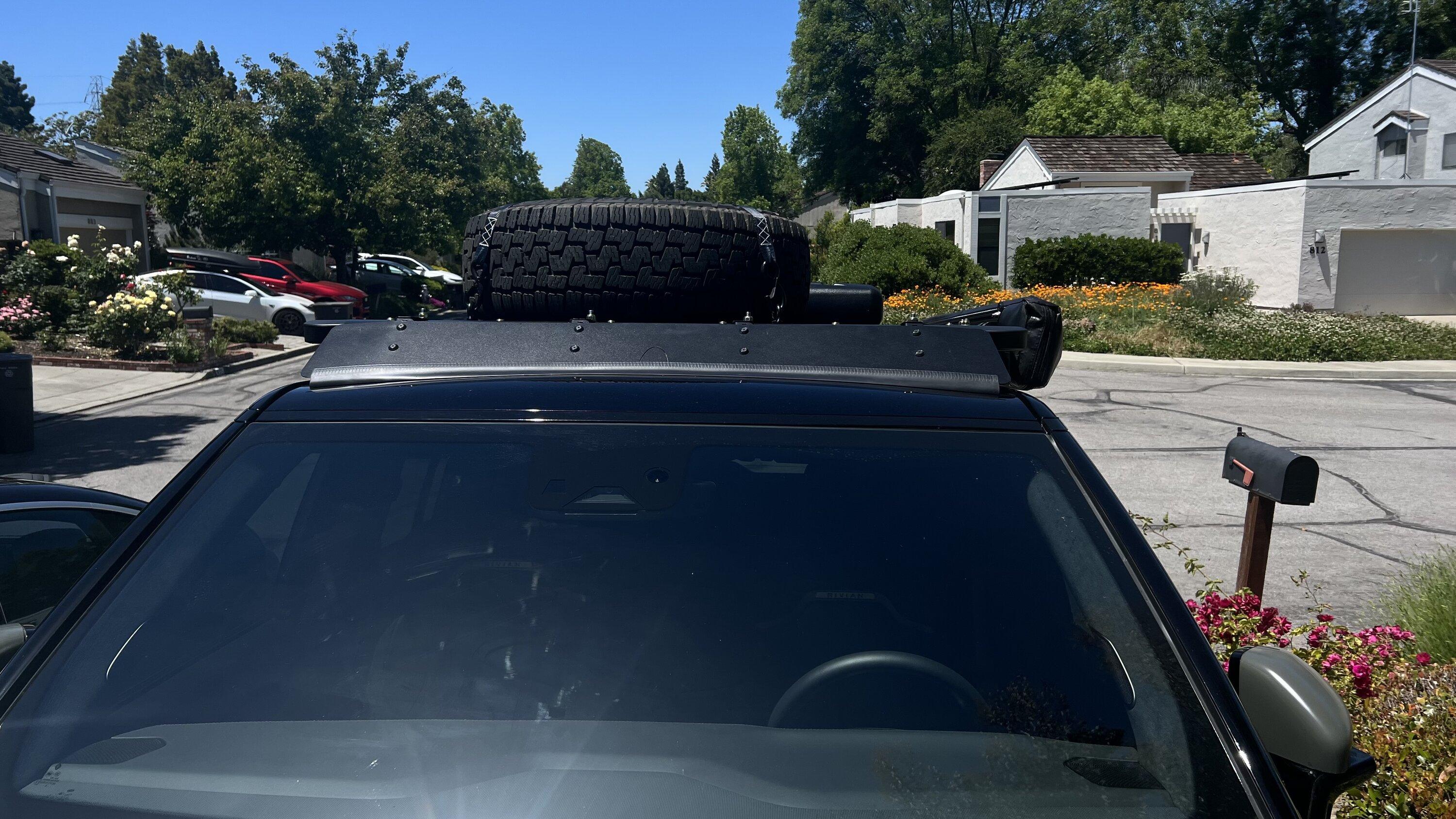

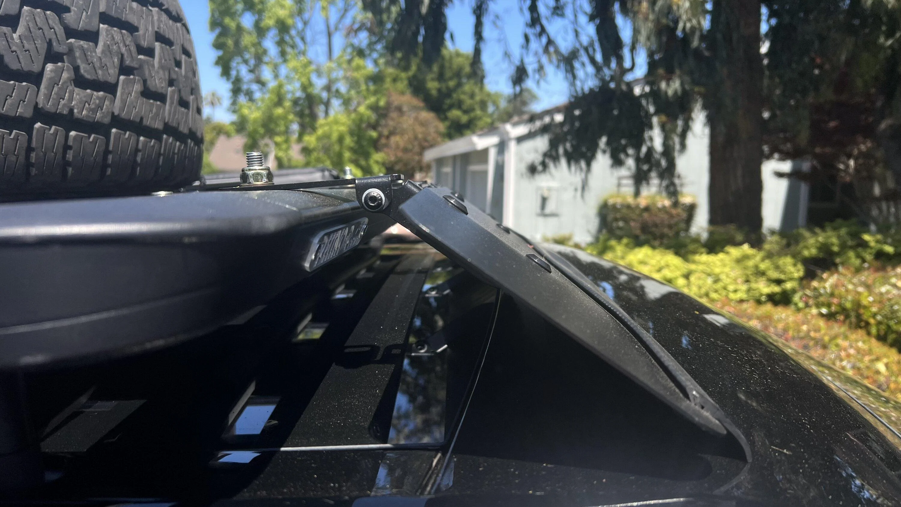

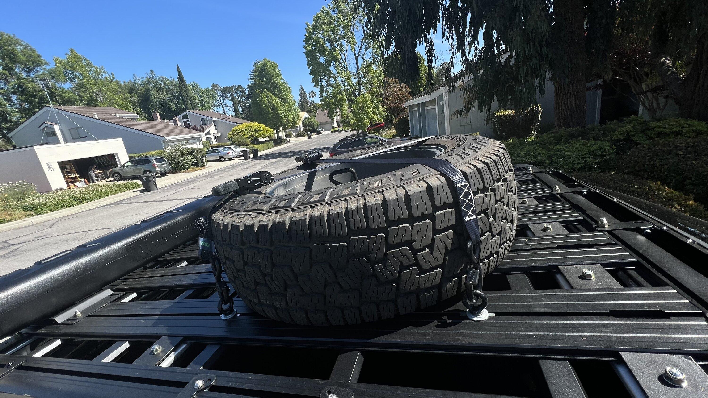

Getting ready for 1st trip but test drives showed minimal range hit. I have extra bar but was going to keep as spare. Rack is pretty easy to install and remove so I do not leave it on truck. I have front runner wind fairing to help with noise. Rack sits on crossbars but rear crossbar is lower and I flex the rack a little when I bolt it down with 18 Yakima 10mm lock n load t bolts and 18 steel plates that I fabricated that ride on rack plank lips. Not recommending this solution do so at your own risk.

So what I am hearing is rack is the right size but not necessarily ideal given rear bar height difference and lack of non-custom attachments that work with the Rivian bars. Is that right? Sorry for the million questions. Just trying to avoid trial and error on my own after I get the vehicle.
Correct and I would not want to be liable for the attachment method if something fails but it seems really solid to me so far.

Could I bother you for more pictures of the wind fairing? Which model is it?
