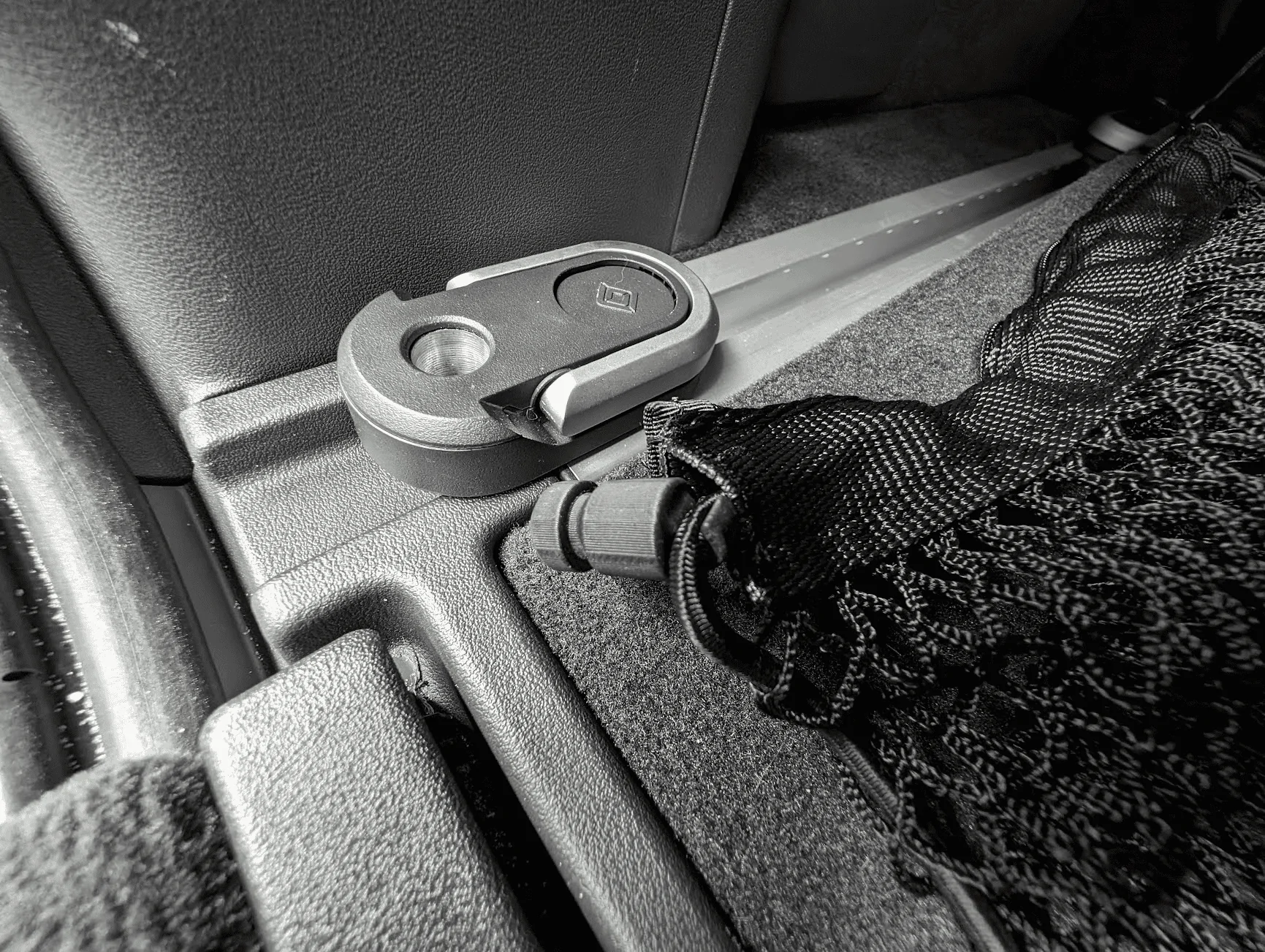

Acura MDX OEM cargo net with my custom printed quick-release hooks finally put to the test today 😁
Seems to be working great, and while it's not entirely as snug as I'd hoped, it certainly does the job I wanted it to. It's super easy to install and remove thanks to the quick-release latches. All in all, pretty happy with it. I'd say that net is viable if you're looking for something to fill the rear space
I might be able to film a quick video of the latching bits tomorrow if there's interest

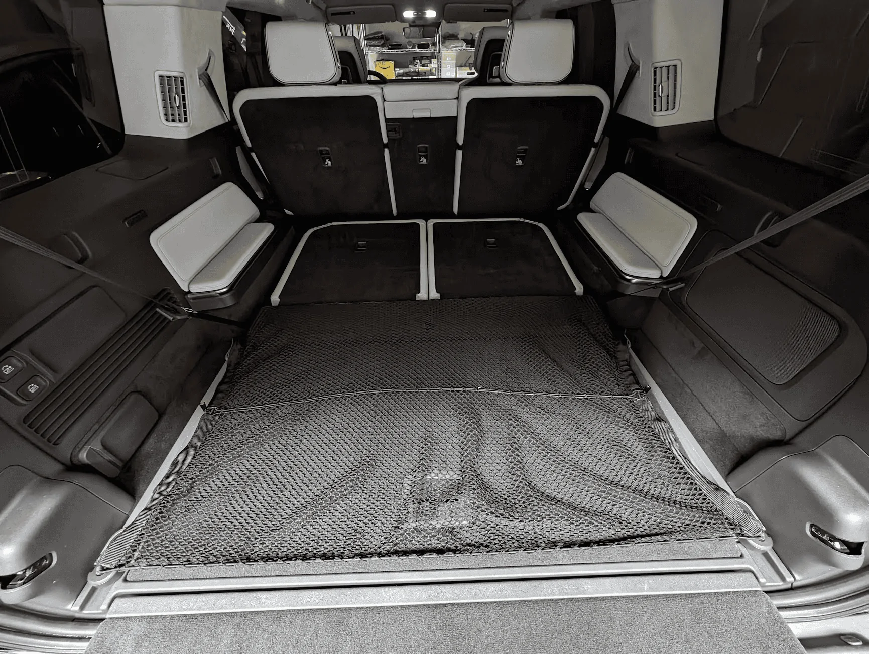

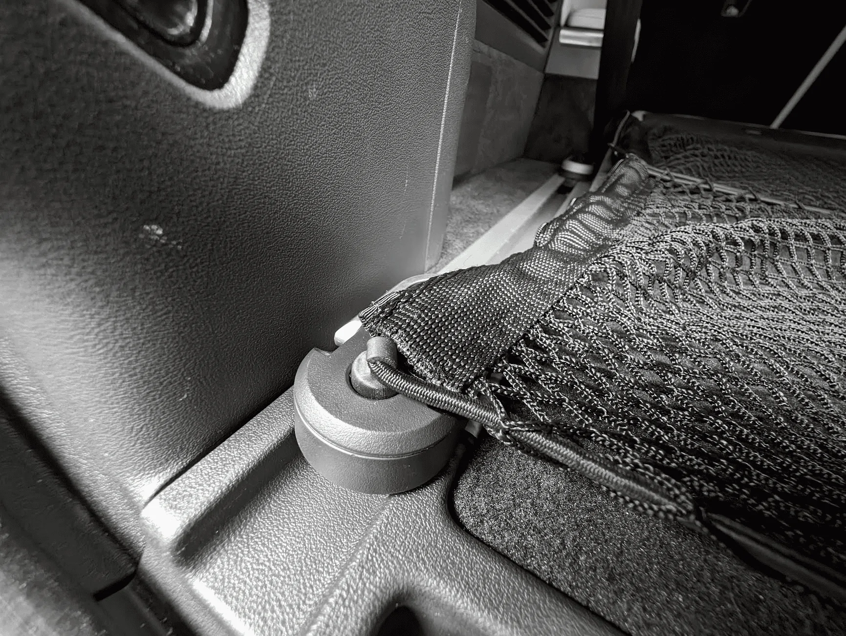

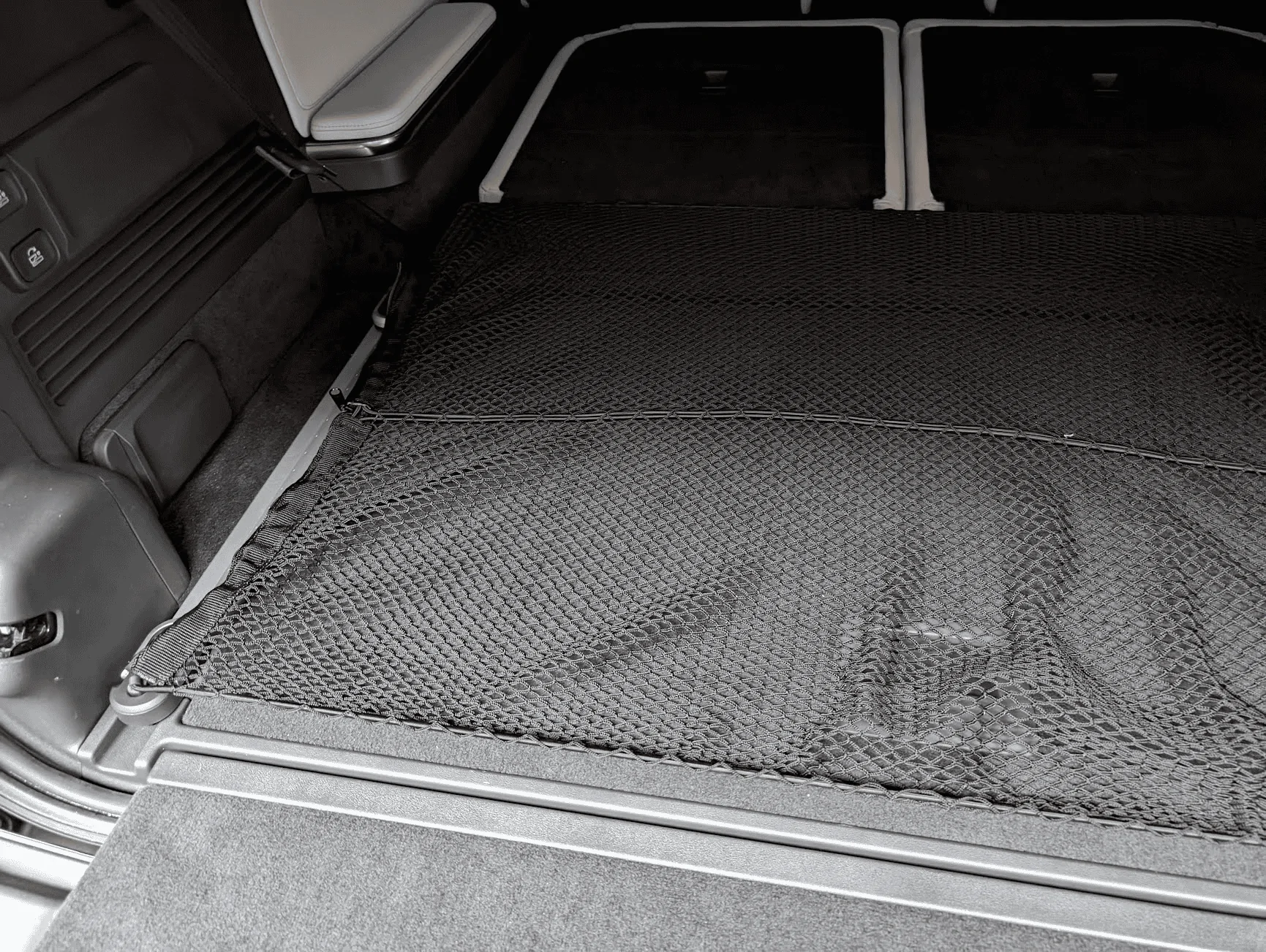

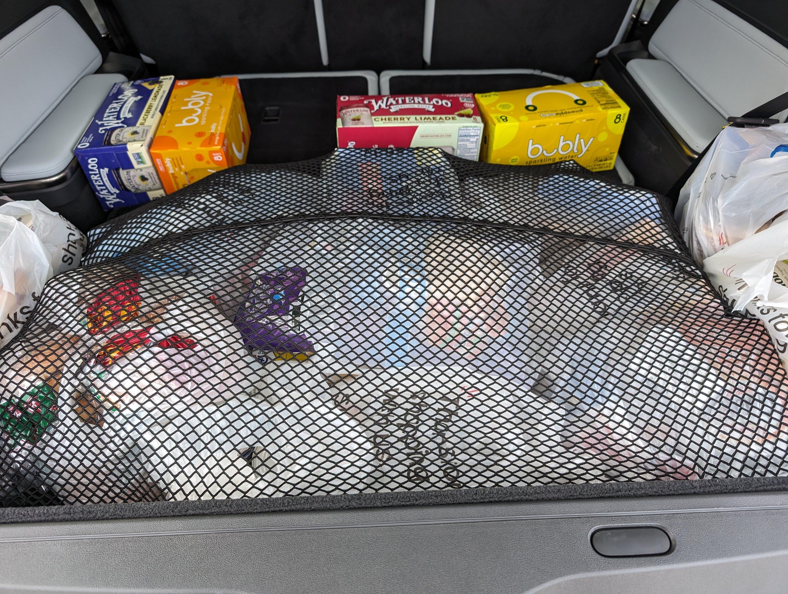

Here's an update of the final (for now :D) installation...
Rivian R1T R1S Suggestions for quality cargo net for R1S 1703794829205
Rivian R1T R1S Suggestions for quality cargo net for R1S 1703794845884
Rivian R1T R1S Suggestions for quality cargo net for R1S 1703794866762
Rivian R1T R1S Suggestions for quality cargo net for R1S 1703794884676
And a short video on it, apologies for the somewhat low quality it's a very dark day (way darker than it appears in the video) and inside a darker garage so black on black with a complex, small, repeating patterns seems to be giving the video encoder fits, but the gist of how it works and fits is there:

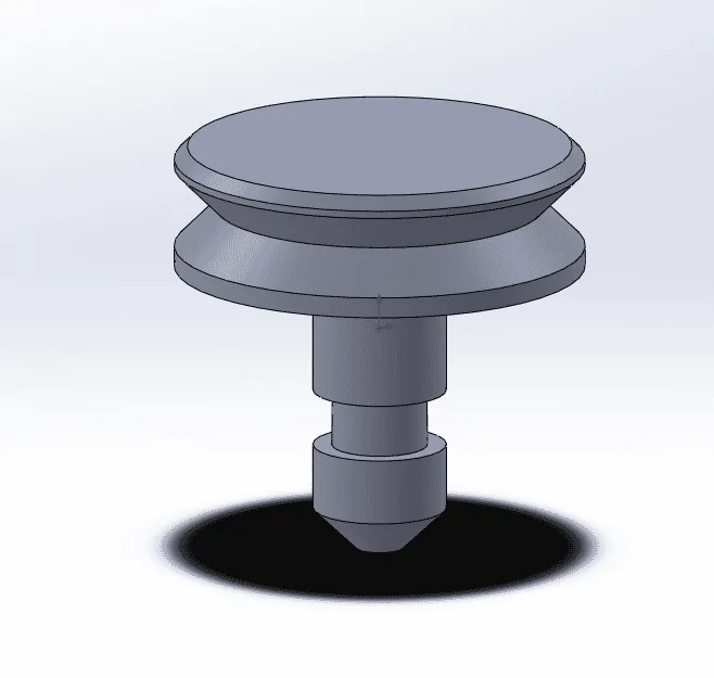

I really like what you've done with the fitting to engage the stock tie downs. I noted your mention of excess slack in the bungee. Here's perhaps another version of the anchor based on yours that might get it tighter and can be printed very cleanly and without supports. The dimensions are not correct-just visual representation. If you post the stl for the pin/anchor I could make an accurate model and share it back.
Check this thread: https://www.rivianforums.com/forum/threads/3d-scanner-works-test-prints-working-great.22136/
I like the design, one of my concerns with printing these in a "no support" orientation is that it would put the layer lines in what I feel would be the "weakest" alignment with regards to pulling force - I could see the bottom of the peg simply pulling off at a layer line below the metal latch and now you have a chunk of plastic stuck down there. Printing these "on their side", while requiring some supports, allows for the "long grain" of the print - the continuous filament - to run along the dimension I feel should be strongest. So it's a trade-off, but one I made knowingly.
I'd love to see what you come up with though! Thank you for the interest and support. It would be cool to build up a nice little catalog of quick-release accessories people can easily print and replicate.
