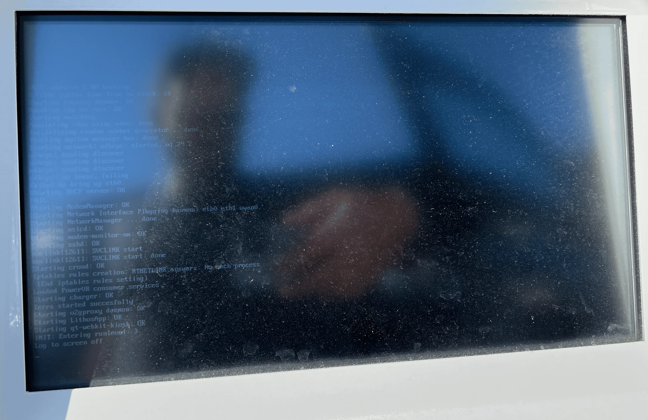

Does anyone know where the Rivian nav sources it charing information?
I've now experienced a number of situations in which EA and Shell Recharge locations are simply non existent in the Rivian database.
Presumably it is referencing a dynamic database, but it seems pretty stale.
I use PlugShare extensively and find it has the best intel by far on charger performance and availability.
I use the EA app to check on charger availability and reference the "last charged" time before I stop. Good mechanism to ensure you aren't going to show up to a dispenser showing a command prompt.
That basically describes every CCS vehicle. Use other apps to plan. Best option is to use combination of the station's own app (best chance of real time integration/being in sync) and Plugshare (crowdsourced recent activity/feedback). It's not really feasible yet for any vehicle to be able to provide the same level of information with a fragmented system. There's no incentive for the station operators to provide any information, because in most cases TINA (there is no alternative).
