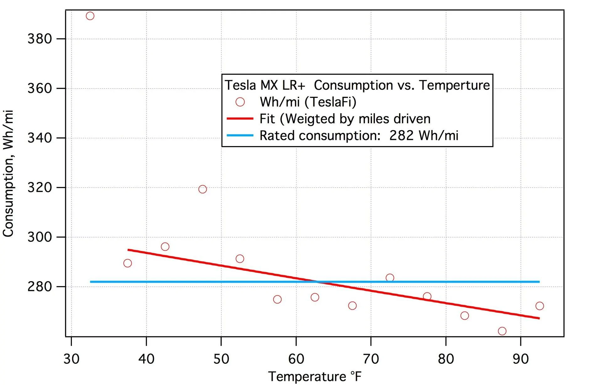

I've observed battery decline of about 1%/hr (~1 kWh/hr) with A/C running while parked in the sun. When driving the consumption on the same stretch of road is about the same A/C on or off but there are so many other variables that we can only conclude that the A/C load is "in the noise". Assuming one is cruising at 65 mph 1 kWh/h is 1000/65 = 15 Wh/mi. This is all in east coast hot (90 + °F) humid weather. Demands may well be higher in the over 100 °F the west coast is going through now. Also remember that the battery has to be cooled irrespective of whether the cabin A/C is on or not.
Here's reported data from my X on consumption vs temperature. The heavy line is a qudratic fit to TeslaFi's recorded numbers weighted by the number of miles driven in each temperature range. Note that the 30-35 ° point was excluded from the fit because it represents a single drive on wet/snowy road and that definitely increases consumption. Also note that the 90-95 ° point doesn't have much influence because it too represents relatively few miles as it has, thankfully, only been nasty hot here for a couple of days (which is why we come up here in the summer). This plot nicely illustrates what I mean when I imply that temperature effects are often obscured by other things that effect consumption.
Rivian R1T R1S Pre-heating and Pre-cooling???? WhpmivsT
