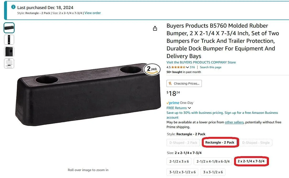

I kludged together this rear end/bumper protector for my new ride.
The Pintle mount shank is 2" X 10" long solid steel and the plate is 3/8" thick solid steel. The piece weighs 16lbs by itself and is rated for 13,000LBS. The bumpers are solid rubber 2.25" thick and 7" long.
Luckily, the two holes in the bumpers lined up with two holes in the mounting plate, so no drilling or modifications to the bumpers or plate was needed. Holding the bumpers to the plate I used four brass machine screws 1/4"x2.5" long with SS fender washers on the bumper side and 5/16" + 1/4" washers stacked on the mount plate side with a lock nut setup to prevent them coming loose. The hardware I picked up at HD, cost about $10 total.
I needed the 10" long version of the Pintle mount because I wanted it to be at least flush with the spare tire on my Jeep, which by the photos you can see it is. Since Rivian doesn't have a rear mounted spare tire option, you could use the 9" version of the mount so it won't nail anyone's shins if they pass to close to your vehicle. FWIW- I went with the "Save With Used" version of the mount because it was $10 less then the new version, and it was still in new condition, just repackaged by Amazon due to weighing so much and busting up it's original shipping carton. I think the "Save With Used" 9" mount is only $27!
Of course in a very hard rear end hit, this might not do too much (and nothing will), but if some knucklehead creeps up/rolls in to it at a stop light or while backing up in a parking lot it might just save you from replacing your rear bumper & bumper cover which is $$$ to replace.

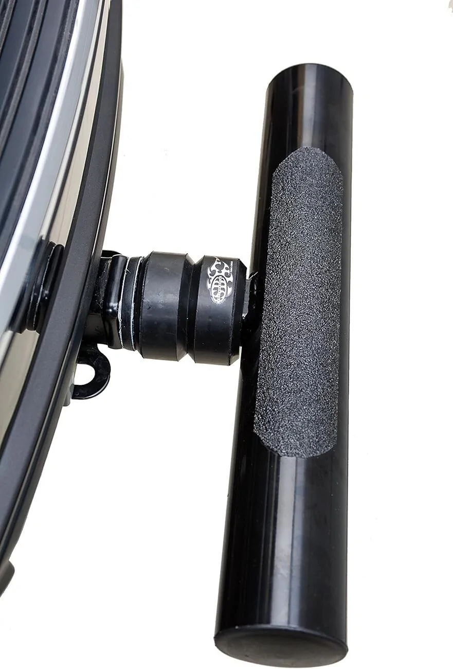

Has anyone tried a hitch step for an R1T? Like this type which has fighting kit, no rattle.
Rivian R1T R1S Protect Your Rivian Rear!! DIY rear bumper protector Screenshot_20241223_211814_Amazon Shoppin
cdubsR1T
Jan 17, 2024
NY
Does it have a tensioner so there is no rattle?
There’s no rattle at all. Tension is provided by compression of the rubber rings during installation of the Sparebumper. Installation instructions
It saved my rear end last week when a sedan rear ended me at 10-15 mph while I was stopped in traffic. The impact was enough to bend and deform the 1/8” thick tubing of the bumper bar, but the R1T was unscathed. Pretty sure it would’ve been a costly repair if it weren’t for the Sparebumper.
The icing on the cake is that they honored their lifetime crash warranty. The accident happened on Wednesday. I received a replacement Sparebumper on Sunday.
