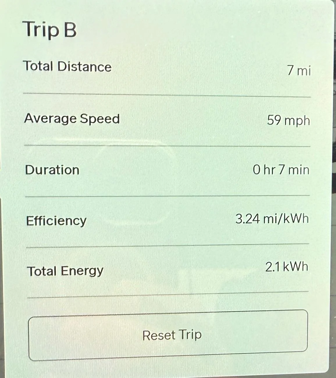

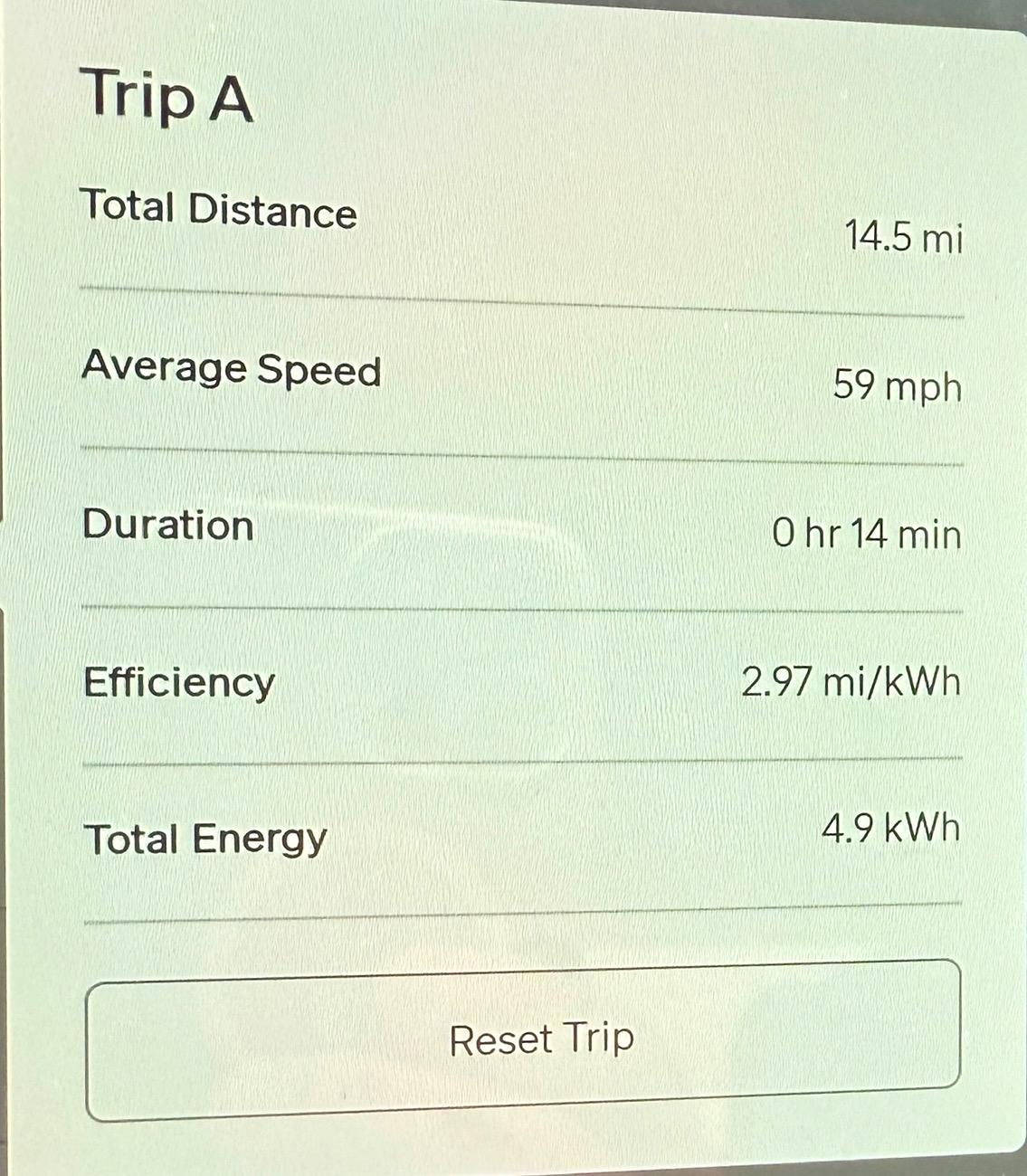

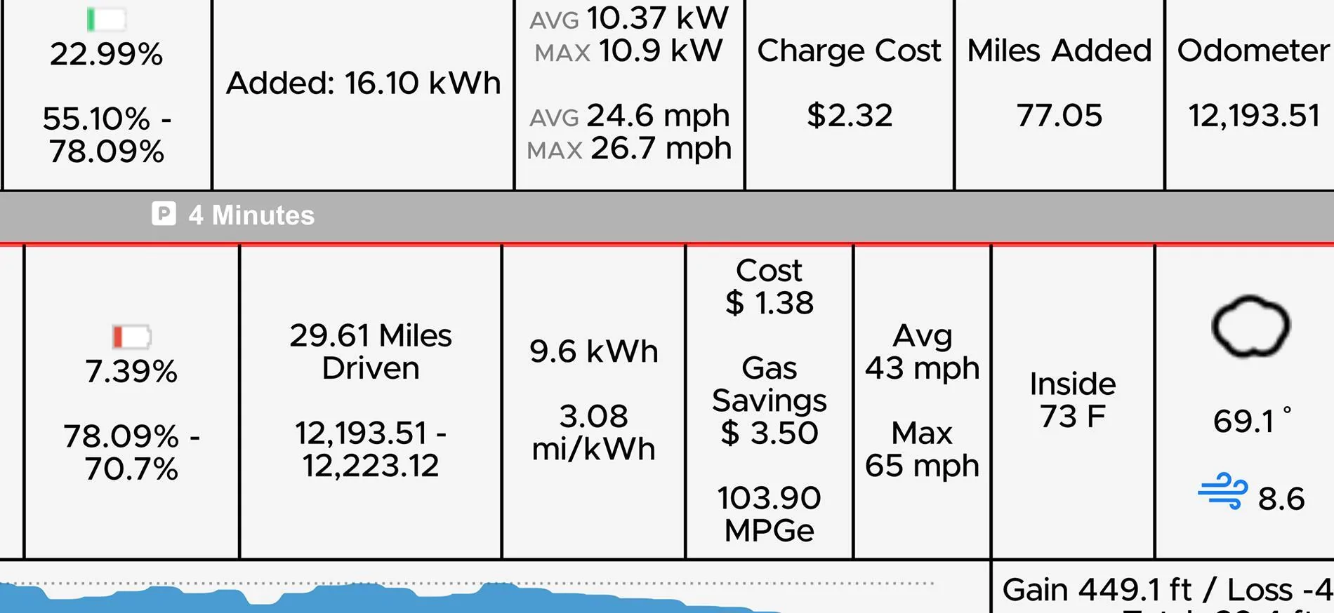

OK, I just made a run today. The longer distance started at our lower elevation than what I finished at so it was uphill overall. The second one is where I could typically have pretty close to the same elevation at the beginning and the end. There were winds of about 8 mph.
I am also posting a capture from Electrifi for my entire drive today.
I was in AP mode, low, had the cruise control set at 61 but according to my GPS was 60 mph, and I never had to slow down, and sometimes I actually went faster.
Temps started out at 68° and ended at 70. Battery test for 91 when I left dropped to 90 later on. Motte sprayer high 130 lower and 40s in the front, and low 130s high 120s in the world. It started in the 90s though when I got on the highway. I didn’t run any AC or heat. I was using my cruise control with Comma.Ai.
just reminder, this was with the factory computer set to the appropriate Goodyear tires the Territory AT 275/60/20 116H.
