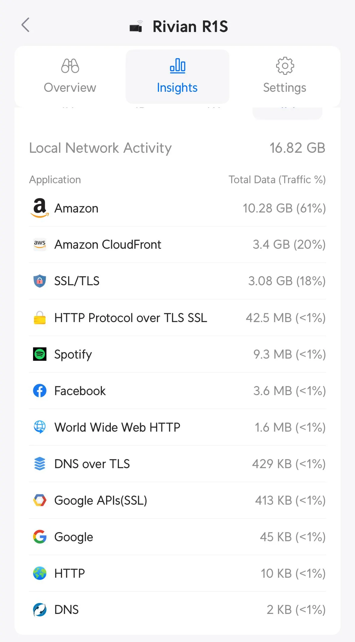

The one that bothers me is Facebook. Why are they sending my data to Facebook?! I have to go back through the privacy setting to see if I can disable this. I was rather open with the data sharing on the truck thinking that it’s be used to improve the product.
I’m kind of annoyed that they are trying to monetize my data to a provider that has nothing to do with the functionality of the vehicle. I get Amazon and knew that going in, but there’s no reason to send data to Facebook other than $$
I wouldn't trust Unifi's traffic identification fully. I see a ton of traffic that seems to be misidentified. As far as Facebook, I've seen that report from Unifi as well, but haven't seen the corresponding DNS requests to substantiate that report yet.
