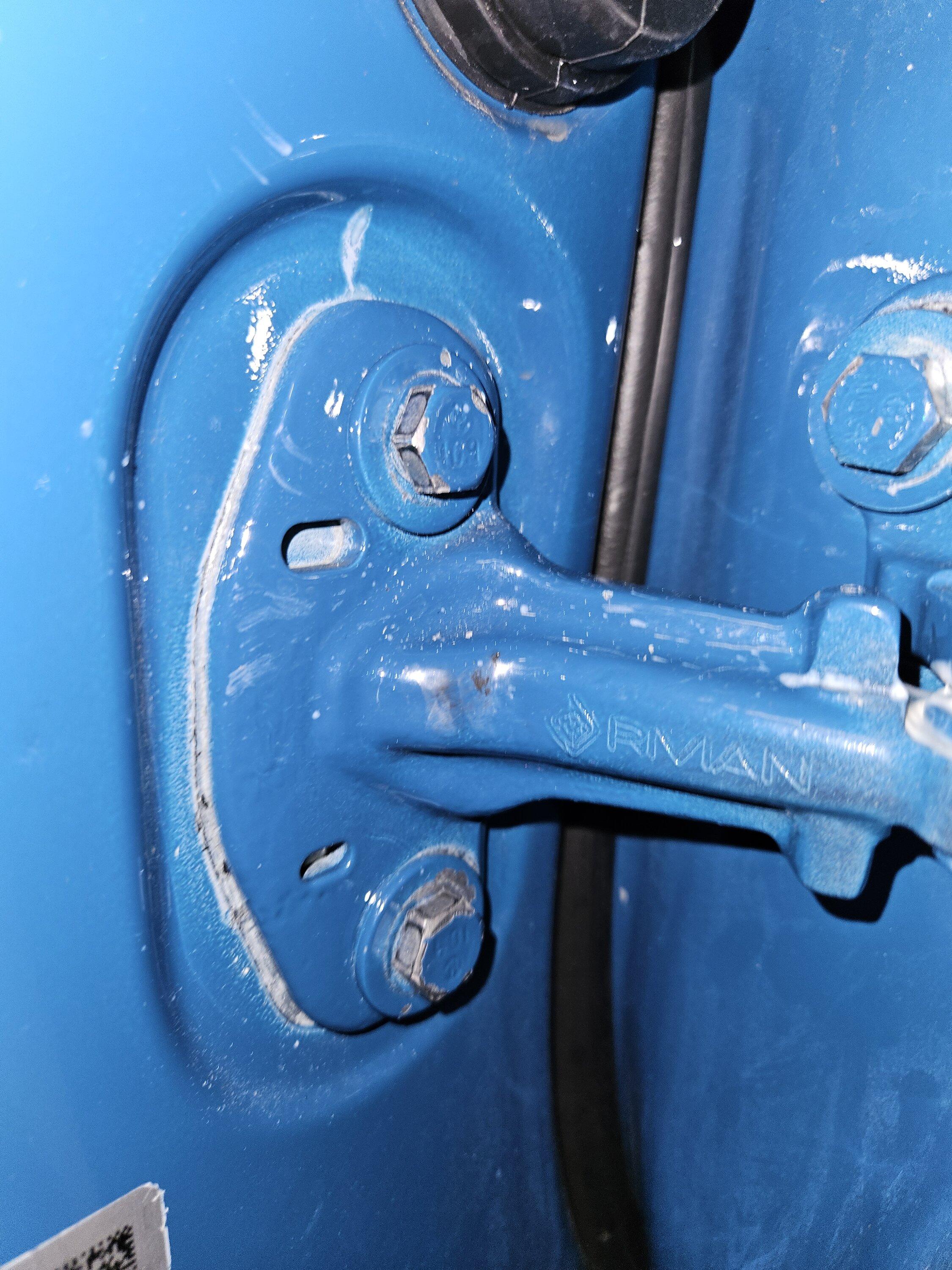

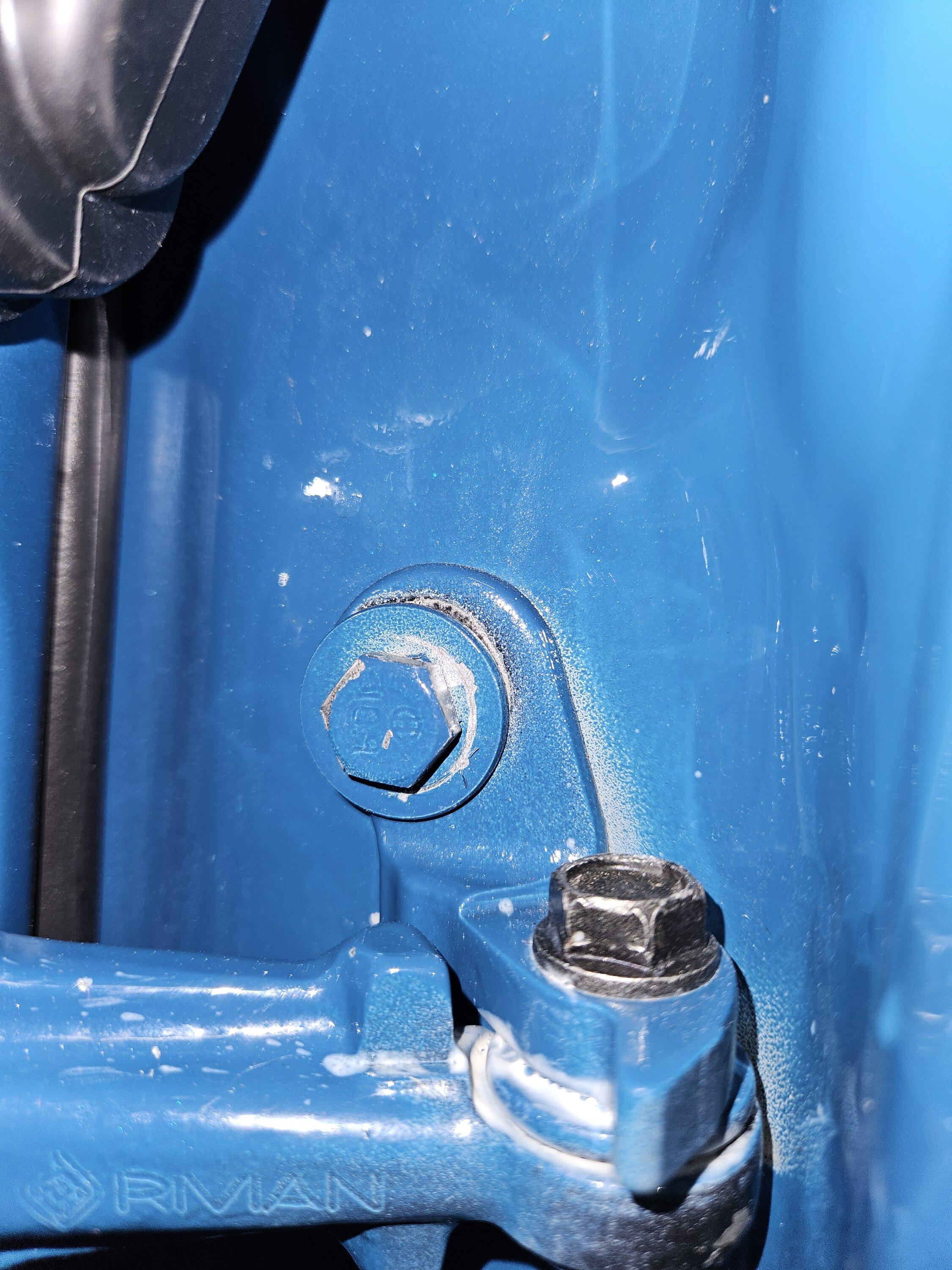

We had the same issue with the same door where the handle itself sounded like it was under a lot of pressure and the door had to be slammed a few times. While at the service center for something else I included that but they said it was "within spec." Once I got home I took a look and since I didn't like the panel gaps anyways I just adjusted it all myself. There are 4 bolts to the frame and when loosened it lets you move the door left/right and up/down. There are two bolts on the door itself that let you move it in and out. Once you look at the bolts the paint will just flake right off of them so you can see if any of the bolts have been touched before you adjust it. If you take a piece of paper it can be helpful to see what you need to do. Our door was not aligned across the top so the top right corner above the glass was low and I had to push the bottom hinge to the right while keeping the top hinge mostly tightened where it was this alone took the pressure off the striker and kept the door lines where they were supposed to be. I used the passenger doors as my baseline for the panels gaps since they were almost perfect to me, I just had to adjust the striker in a little on the rear door.
It's a lot of back and forth getting the door hinges right then adjusting the striker again too (I loosen the striker just enough to wiggle it and used a rubber mallet to move it around, other cars the striker was easy to move when loosened but this one isn't). If the door is out too far at the latch side the striker goes in, ours was also forcing the door up which is where the pressure was coming from, if I raised the striker to take the pressure off then the door lines were really bad. I had the driver's side rear door perfect where it closed smoothly with one finger but then it stuck out from the front door at the hinge side so I had to adjust the driver's door then back to the rear door again. It can get pretty annoying to get it just right only to have it not match the next panel then start over. In the end I got it close enough to the passenger side and none of the doors are hard to close now.
Good luck!

@HarCo S is clearly more "hands on" than most on this forum, including myself. I've had this issue since delivery and at my first visit a technician _opened_ the door and looked at how it moved - he said "door drop". It's hard to see the misalignment on close - much easier on open.
That said, each of my visits I've asked them to address the worst door alignment or panel gap. The folks in the SCs are getting better - you just have to be patient, be happy with things getting less bad, and (ultimately) accept that it's not going to be as perfect as other cars you've owned. Maybe they'll get better at the factory, or maybe the R2 will be better <fingers crossed>

"Door drop" is a much better way of describing what was going on with ours, it just took changing the door angle to fix it. When the door would open it dropped down on the striker side and when shut the striker was having to push it way up to meet the body lines.
