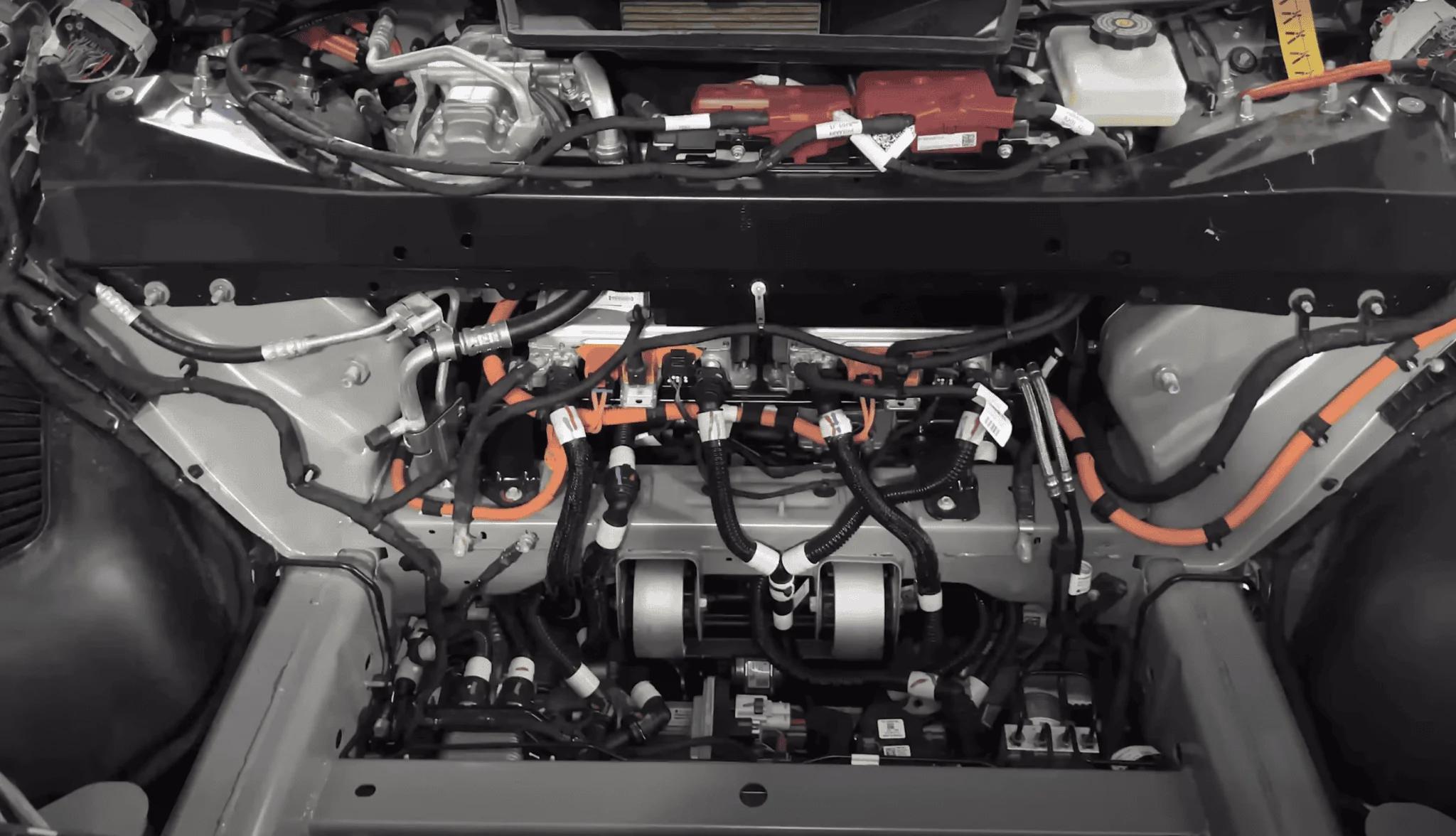

The end. We tried everything. One final 12 V charge from the rear pigtail. Noticed one left rear light illuminate but would not unlock doors, charge port, etc. Basically the update (per Rivian) bricked the 2 small batteries that control car ingress/egress. The high voltage batteries are fine. Should be ready tomorrow as long as the re-updates do not crash the systems again. Hoping this gremlin has been discovered. Call me any time 407-796-2411.

Rivian just called. I had a mobile service appointment for tomorrow to program key fobs. They moved it up to today and should be here within the hour. They said they're bringing two new 12V batteries, so we'll see what happens. Fingers crossed. My last software update was several weeks ago and it's been fine since. Drove it Sunday. It sat for a day with 81%+/- charged and was completely dead.
Hoping they find the cause, beyond just replacing the 12V batteries. Want to know why it happened and if it will happen again. Fortunately I was at home when it did. Would not have been pleasant if it happened while I was out somewhere or out in the middle of nowhere.
