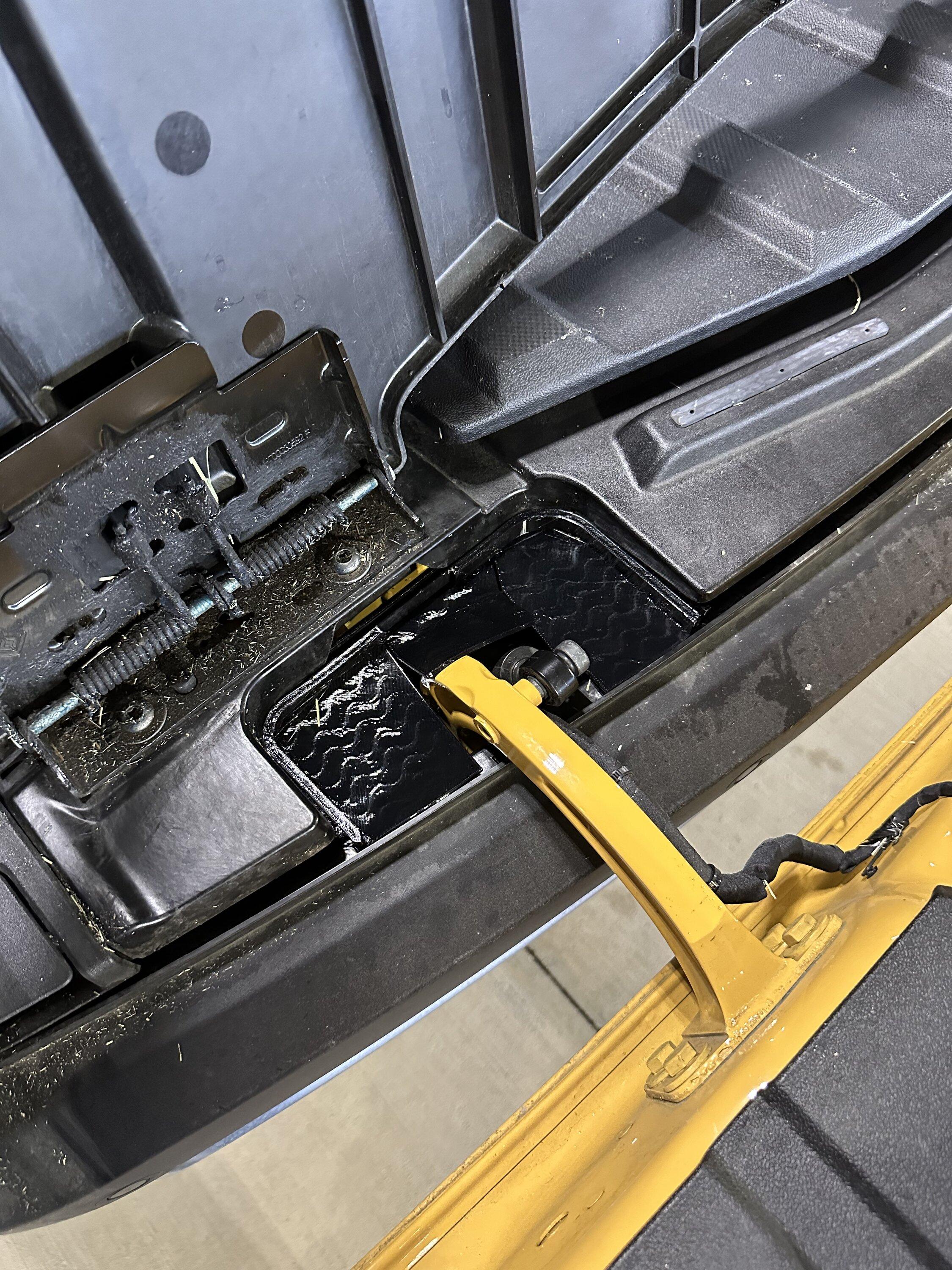

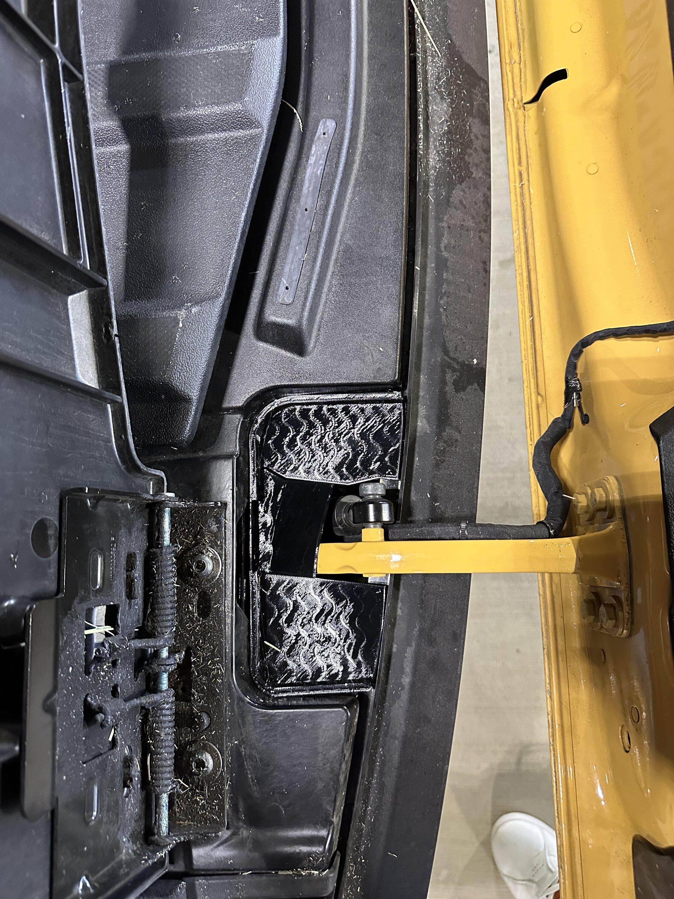

Update! I settled on a final design and I think it works great so far! Below is a pic of where I landed. It's very sturdy and blocks a large majority of the gap.
I cant seem to get a video to upload, but the top flap stays in place very well w/o interfering w/ the hinge/piston. Also the whole thing is a friction fit, so no glue or fasteners needed. Just snap it in.
Hoping to test this out more in the coming weeks!

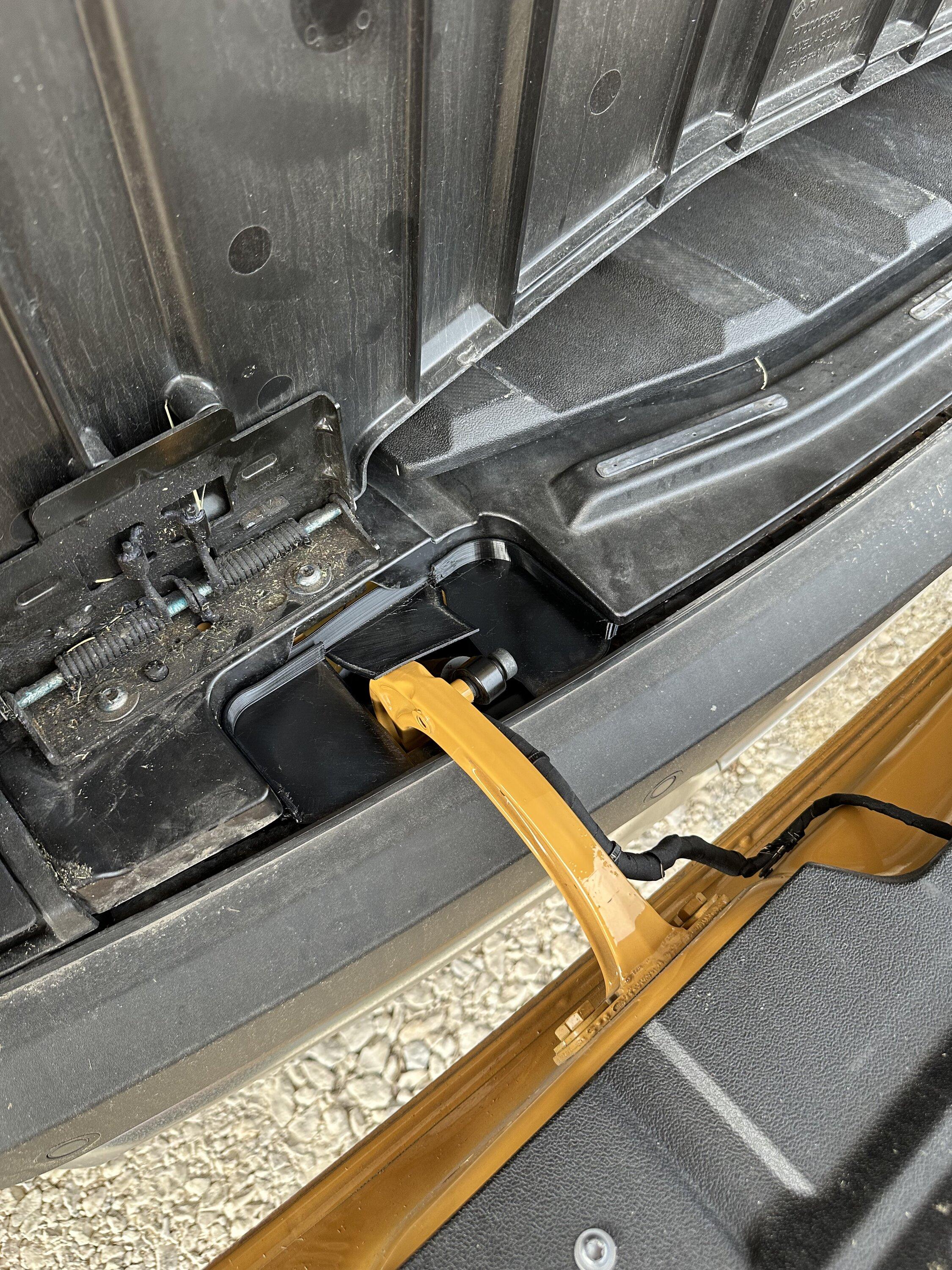

Original post:
Thought I’d show off my prototype design for a tray to cover that annoying hole-to-nowhere in the RIT bed. 3D printing it out of TPU (super strong & flexible). Pictured is just a quick draft for concept. I’m still adjusting the design a bit, but so far it works real well and seems promising. Would love any feedback.
I carry a lot of hay and loose material and every time I close my tailgate the extra debris falls down into this abyss, really don’t want this stuff to keep building up down there.

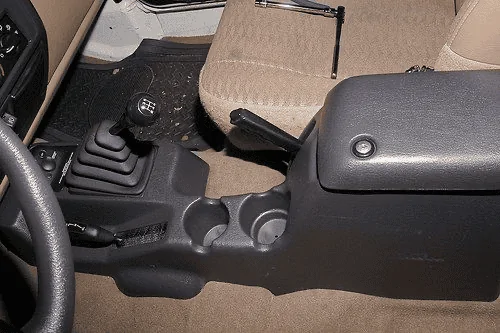

maybe add a brush gasket by hacking up a broom or other bristled cheap hand tool, the bristles could help keep most stuff from going in, and not inhibit the movement of the hinge, like an old parking brake/ drive selector gasket
(example from a TJ)
(example from a TJ)
Thanks for the input! I thought about a brush, but I couldn't find a simple way to make that sturdy enough to hold heavier debris. I also wanted this to be easy to make (3d print) and a simple one-piece design.
