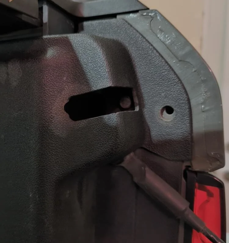

Driver side, you can see it:
Rivian R1T R1S R1T Tailgate Sensor Problem 1000001866

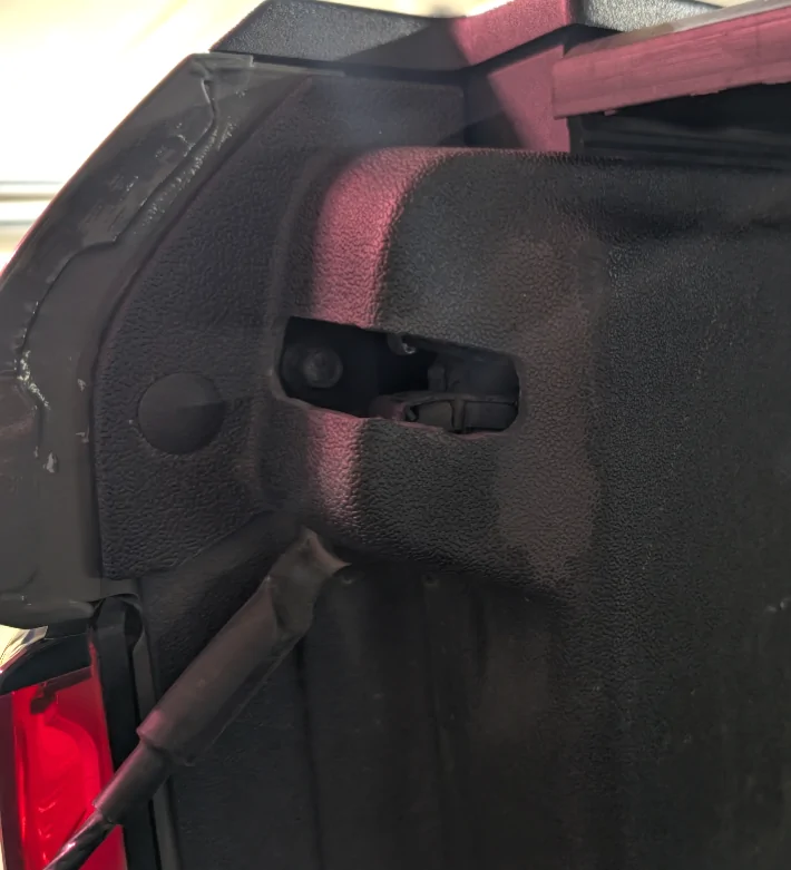

Passenger side, I removed it. You can see a worn area in the plastic, it's grown since the day I bought it. It makes me think the actuator wasn't aligned right, but you can't adjust its position. The staple can be adjusted, but not in the direction necessary:
Rivian R1T R1S R1T Tailgate Sensor Problem 1000001865
