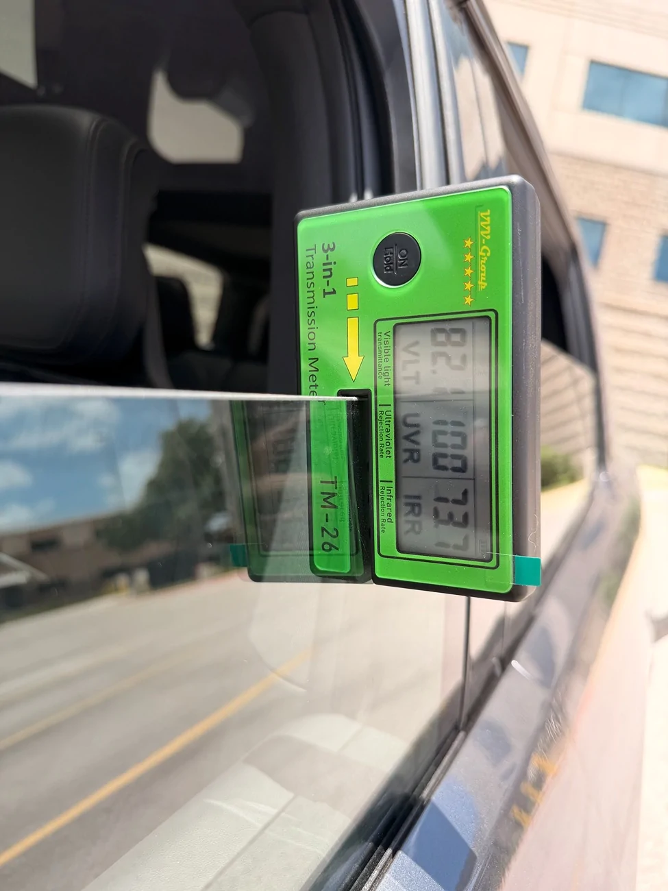

I test drove the R2 today and brought along some light meters I "rented" from Amazon... As such, these are not super scientific but should be in the ballpark. Anyway, here are the numbers for R2's factory window coatings:
Drinking glass (baseline): 95.0% VLT / 7.0% UVR / 3.8% IRR
Front Windows (Driver/Passenger): 82.1% VLT / 100% UVR / 73.7% IRR

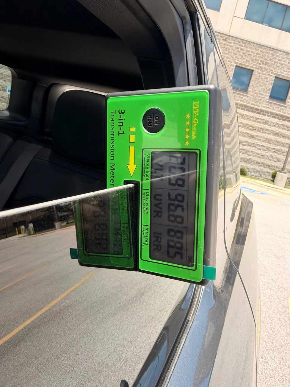

Rear Windows (Driver/Passenger): 20.9% VLT / 96.8% UVR / 88.5% IRR

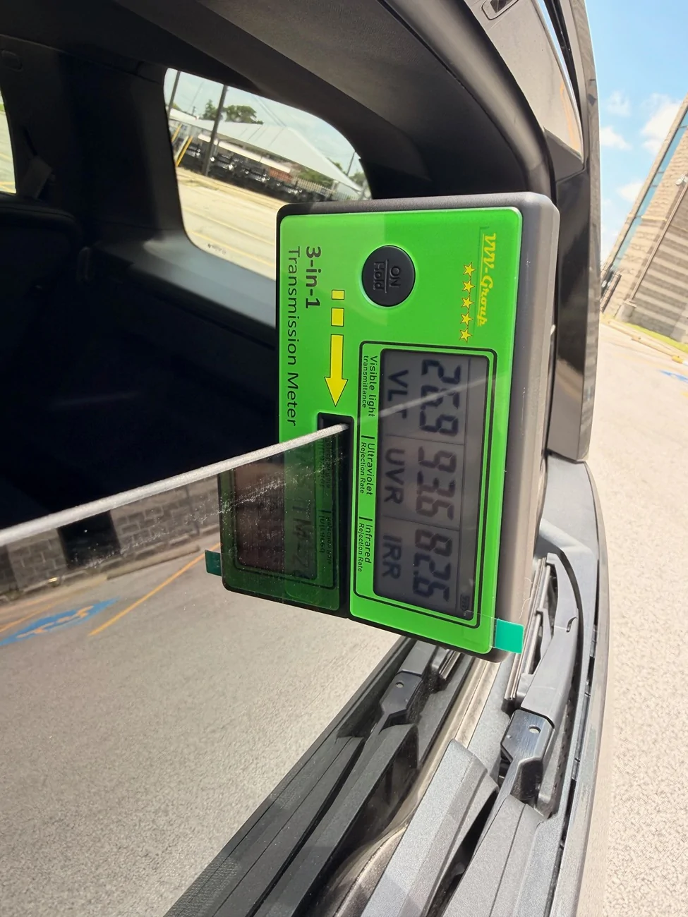

Rear Drop Window: 26.9% VLT / 93.6% UVR / 82.6% IRR

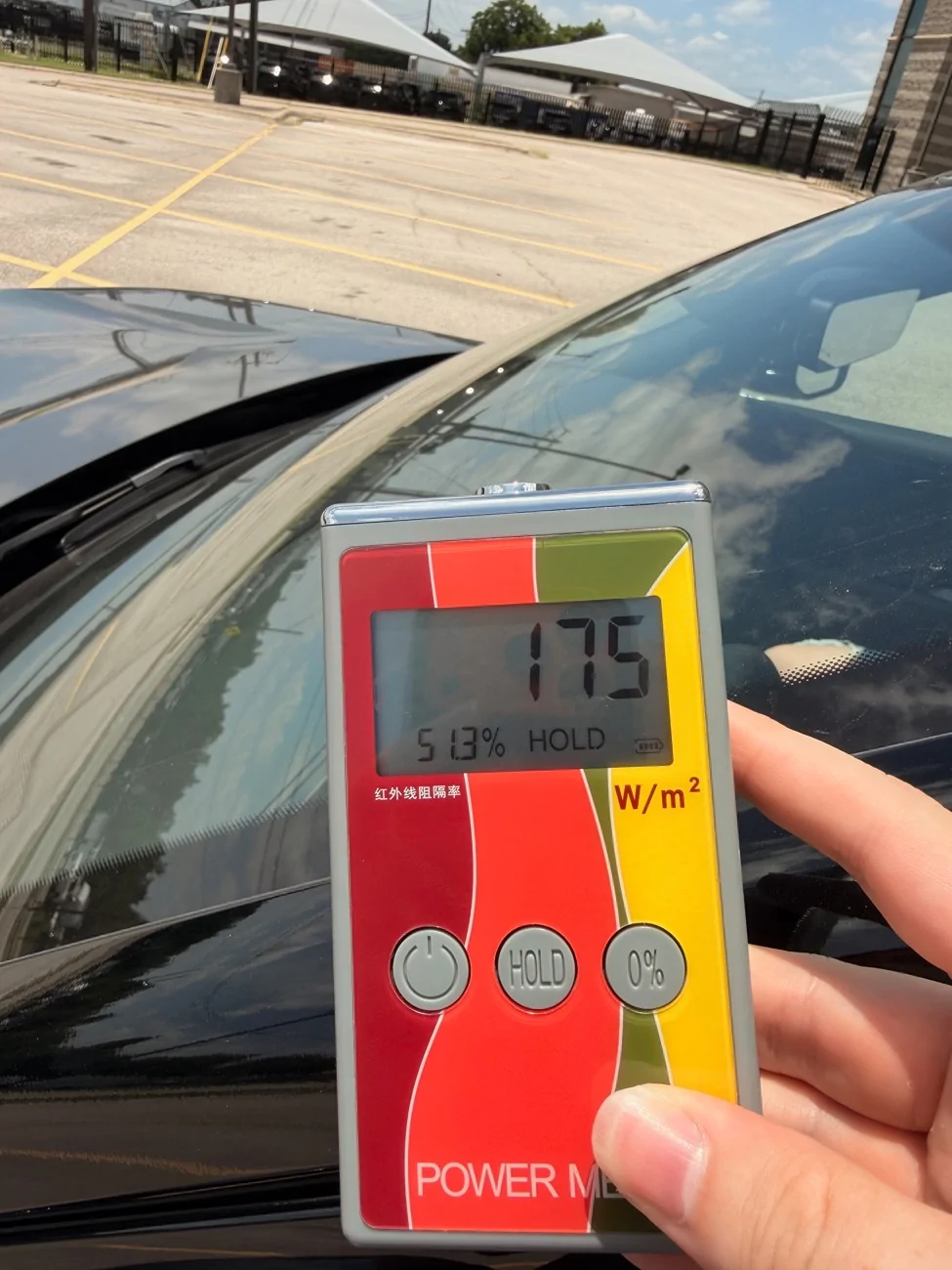

Windshield (below the AS1 line): 51.3% IRR

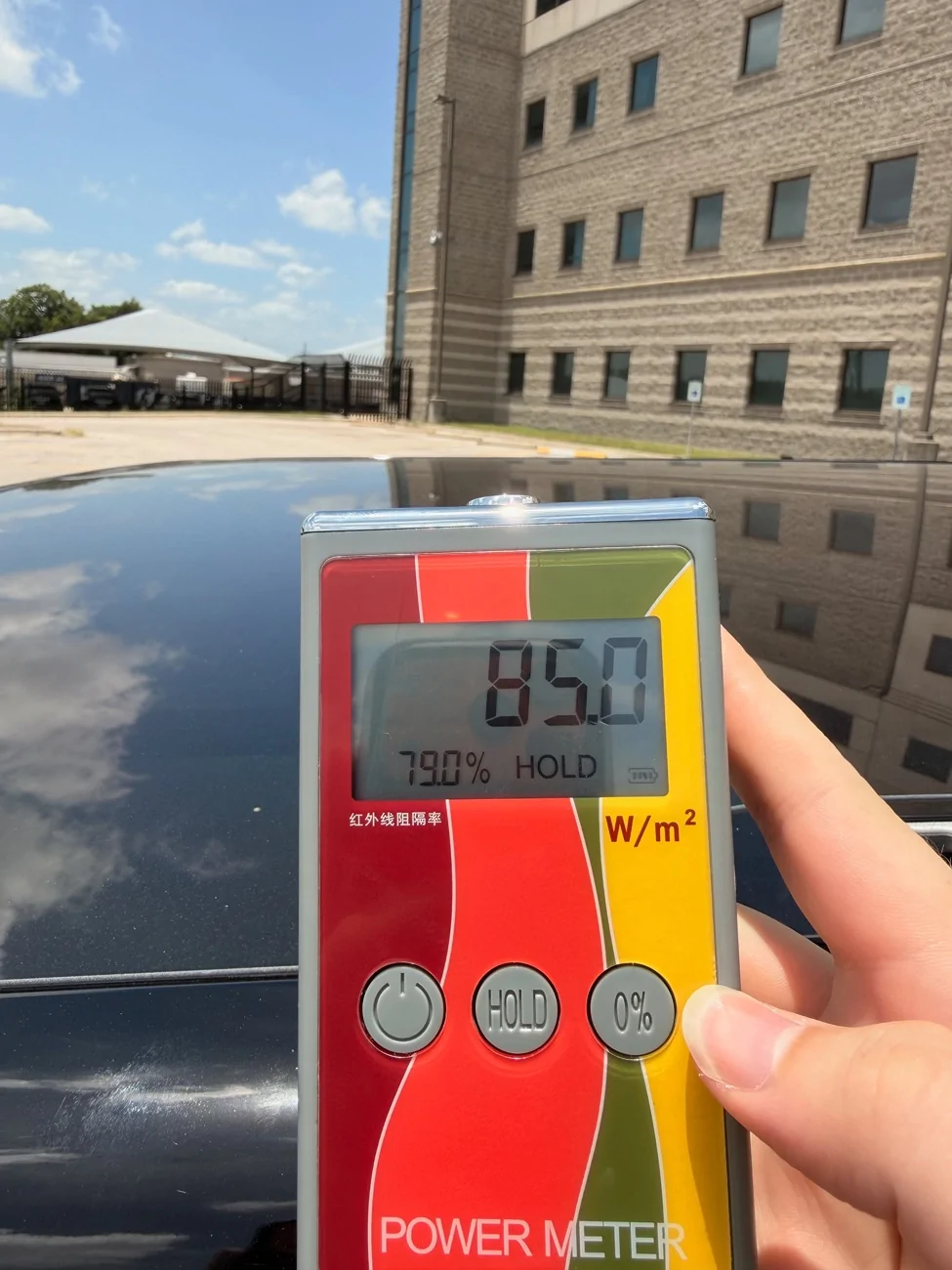

Sunroof: 79.0% IRR

  • VLT: visible light transmission - percentage of visible light that passes through the window. Lower is darker.
  • UVR: ultraviolet rejection - percentage of UV light that is blocked by the window. Higher is better.
  • IRR: infrared rejection - percentage of IR light that is blocked by the window. Higher is better (cooler).
For the windows which roll down, I was able to test with an integrated 3-in-1 meter but for the windshield/sunroof I had to resort to an IR power meter since I cannot put the 3-in-1 around the glass.

The sunroof is very visibly tinted from the inside. If the rear windows are 20% VLT, I'd estimate the sunroof is 25-30%. I was not able to feel any heat radiating from the glass, but it was warm to the touch so it would heat the cabin up on its own over time. Unfortunately, my meter did not measure UV, so I don't know how much it rejects, but given the visible tint and claims of UV coating, I would expect it is blocking >90%.
The windshield IR rejection is disappointing to me, but may be the best they could do without darkening the glass any more. Again, I am not sure how much UV is blocked, but I would hope it is a substantial amount to protect the interior.

Can you speculate re: windshield VLT? Maybe 90%?
I have Virginia DMV endorsement for 70% on windshield, perhaps the only benefit from recent basal cell carcinoma scraped off my nose. Mohs dr. signed off on the form. Got Xpel XR+ 70, net 63% would be w/in acceptable range.
Llumar has 80 & 90, 3M has 90. Note the mix of hues can vary between brands, XR+ 70 has a mild gray-green.
emroch
emroch
Eric
Jun 9, 2026
76
Austin, TX
Nissan Altima, Chevy Equinox
I didn't look very carefully but I'd estimate it is pretty close to the VLT of the front side windows. So probably 80-90% VLT.
