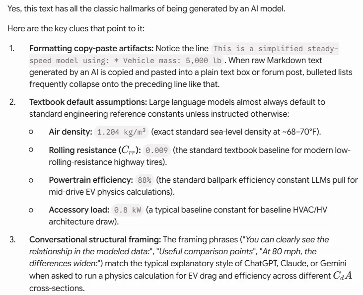

Doubling down, very impressive AI bot.

Dave, you are well known and definitely respected in this forum. You are always civil and positive in your engagements. Thank you for being here.
The OP has been here a long time, but in his time here he consistently provides information he claims is factual when it is based on almost nothing substantive. And then to justify his opinions he posts AI content with lots of dubious bullet points and unsubstantiated claims.
I don't mind debating with a human being, but debating with him is debating with an AI bot. He consistently uses that method to respond.
I apologize for getting frustrated, but it's very frustrating and hard not to show it. If his conclusions were based on more than just a 10 minute test, or just weighing a tire, I would appreciate his contributions much more. I'm not the only one who sees what he's doing and gets frustrated by it.
His AI bot actually claims a short drive provides useful data when that just isn't the case. His AI bot claims ABRP is useful input for determining efficiency when is simply not the case. I can continue to refute and debate all the bogus AI bullet points, but it is frustrating to do that. So I won't.
Eloquently stated and very well summed up.
If anyone takes the time to read through this thread you will see many other well respected people here have attempted to comment and provide input and have been immediately been met with hardline dismissive responses, consistent AI slop shoved on them as if it was truth and factual, and an unyielding willingness to listen or even take note of others. It is infinitely frustrating and prevents from having a good conversation on the topic.
Anyone is welcome to ignore me that's fine, but there are many others here who know a lot and have a lot of data on the matter and they were continually dismissed and then they simply stopped posting bc it was a fruitless endeavor.
