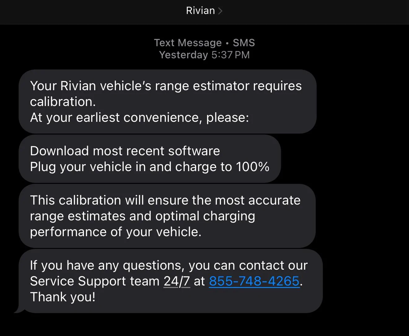

Gen 2 R1S dual standard just delivered on Monday. Got this text today (attached screen cap) telling me to plug in and charge to 100%. Well I only have 110 slow charger at home and the app says it’s been at 95% for most of the day today (started at 8pm last night) but the kWh keep going up - shows I’ve added 23.6 in 19 hours of charging. But it’s not moving mileage or % any more. Anyone have experience?

My guess is that as the pack gets full, it continues to balance and bleed off excess capacity from the high modules. Even 240v and DCFC charging sessions get slow at high SoCs, but they're even slower on 120v.
Or maybe the truck is "seeing" a high SoC and is slowing down out of an abundance of caution, thinking the voltage spike at full will be there "any minute" but in reality it may actually be quite a ways off. LFP batteries can be kind of mysterious because of their flat voltage curve, so this is basically the charger operating in the dark.
How many kw does the app say the truck is charging at? Is it still ~1.4kw?

Yeah 1.3kw

I would not worry about it for a while. You're seeing 95% now, but the battery may actually be much less than that, and the BMS needs to see the voltage spike at the end to know that it is truly full.
You could try speeding it up a bit by putting it on a public L2 charger for a few hours, but it's likely to be full by tomorrow morning anyway and should then be calibrated.

Thanks - I’ll just leave it overnight and not worry about it til the morning. I figured but just wanted to make sure I wasn’t just sitting on the charger for no reason. If it hasn’t resolved by tomorrow I’ll take it to a “real” charger haha.

Update: left it plugged in to the slow charger and it “completed” but only read 99% so I took it to a Rivian Adventure Network charger this morning just to be safe and charged to 100%. Hope I’m calibrated!
