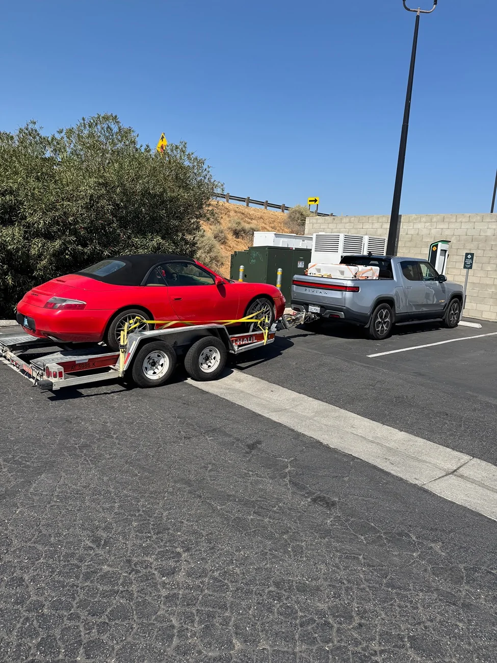

Just towed this 6,000 lb load through Sacramento Tuesday. Outside temps 102.
Battery pack temps 92-105 range
Dang! Beautiful ride! Sounds like if there was going to be battery heating difficulty you would have had it with those conditions and didn’t. You Gen 1? Can’t tell if those are 21s’ or not. Also, random question, what hitch are you using? Thanks!
21"
Pirelli Scorpions,
Started at 48 psi cold went up to 53 hot tires.
Factory Rivian hitch.
UHaul
Trailer weight 2500 lbs empty, plus about 4000 1999 Carrara additional weight.
Truck pulled this load no problem 70-75mph on freeway. Load did not faze the quad '22 R1T at all. Plenty of power on the steepest hills. Regen off the truck-no trailer brake did stop the truck easily.
