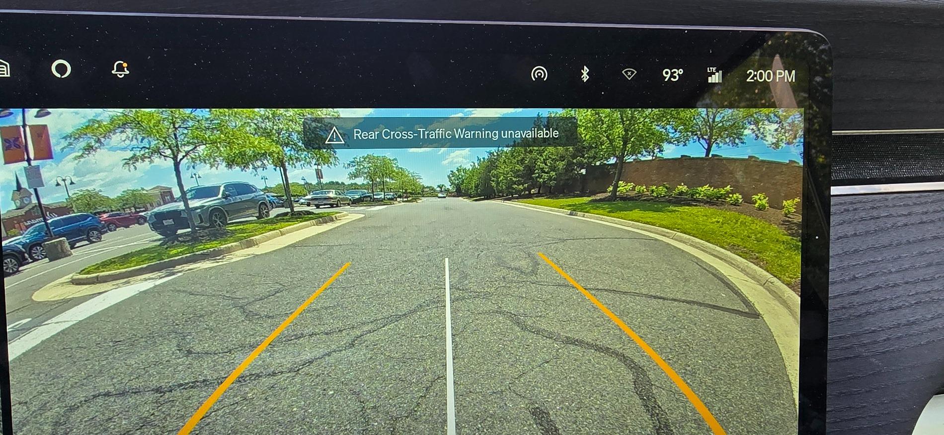

I'm having this same issue. I have to do a hard-reboot (hazard button + left-most steering wheel button) to make everything work okay again, but then the next day (or sometimes the day after) it comes back. Usually, it's just the "Rear Cross-Traffic" warning message, but once (so-far), all sensors stopped functioning (a bunch of yellow icons on the bottom of the instrument panel). I had to pull off to the side of the road and do a hard-reboot to get everything back.
On one occasion I didn't notice the message until I was almost ran into as I was backing out of my driveway. There was no warning that one of my neighbors was barreling down the street towards me, and not even slowing down. The "automated emergency braking" didn't engage either.
I'm not sure it is specifically a sensor malfunction since a reboot makes the problem go away temporality. It does seem to happen more often after the last software update, though. I think something about the car going to sleep for a long period of time that is what causes this to happen. That's what I've noticed anyway, but I'm not an engineer.
If this issue is not resolved with the next software update I'm going have to schedule a service call.
Rivian R1T R1S Rear Cross-Traffic Warning Unavailable - R1S Tri 20250517_140032
