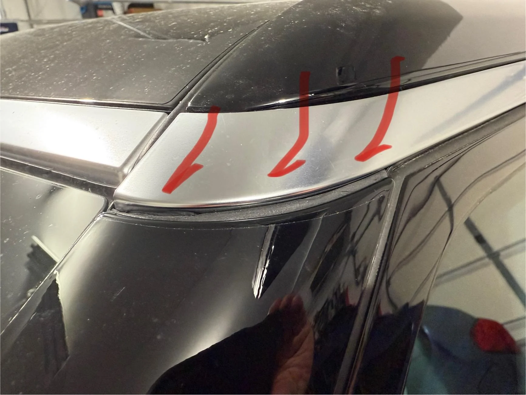

boise_mountain_biker
Jun 11, 2022
Boise, ID
Tesla S Plaid, Lexus GX460
Medical professional
It’s in the photos on my original post. It’s the outermost 1/4” or so weatherstrip—looks quite stock. Pretty much the same procedure as the OP. I just put the red markings of the extra adhesive strip locations.

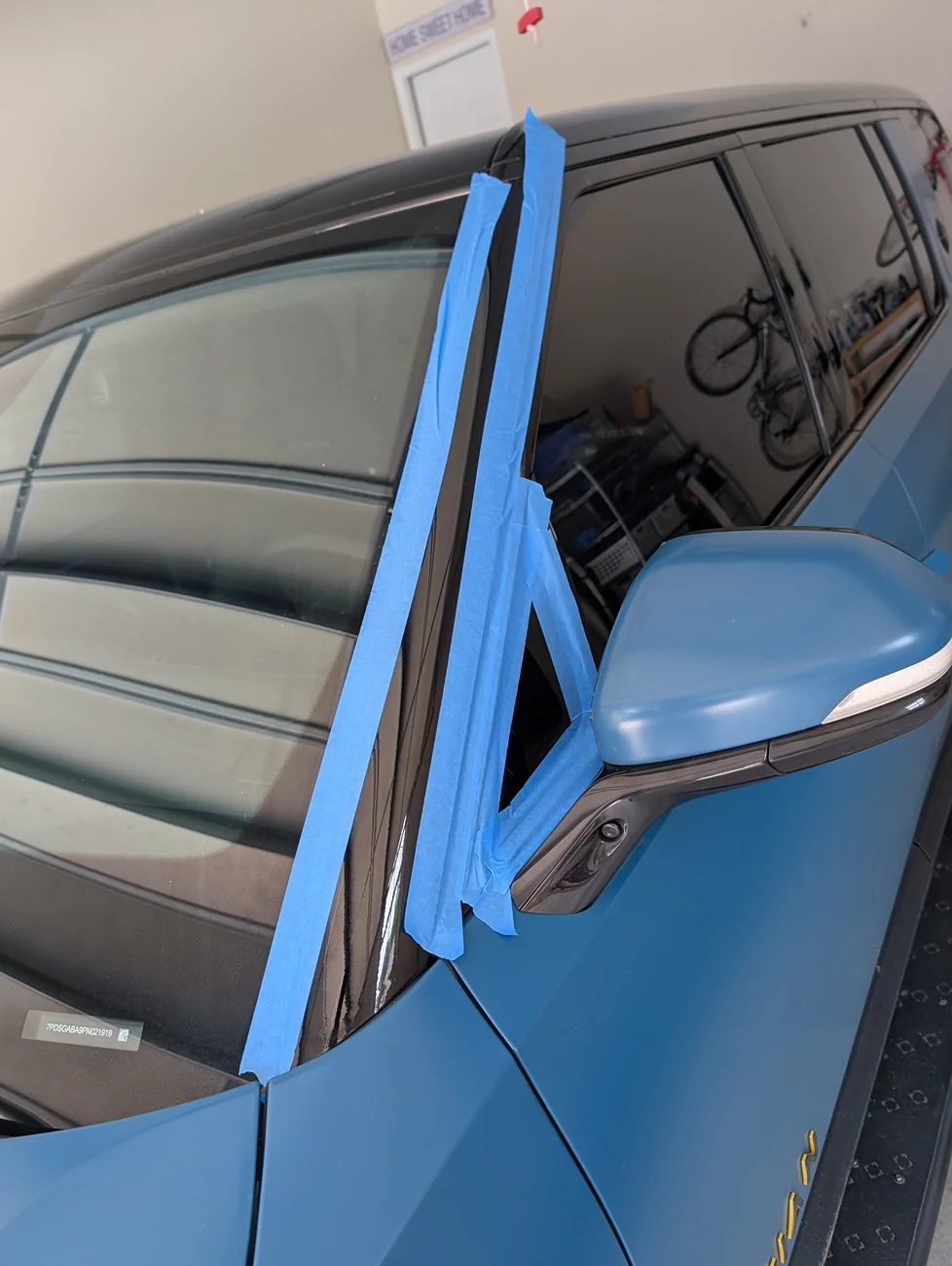

So, quick question, do any builds NOT have the wind noise issue? I have a September 23 R1S, and set out to do the painter tape trick and I noticed no difference in wind noise at various highway speeds.
dbs mph
63 90
60 80
58 70
55 60
My painter tape setup. Made several runs up and down the highway, taking measurements at various speeds. Removed the tape in sections. Measured no difference. Did I do something wrong? I've got the weather stripping to do the upgrades, but if I measured no difference, should I not attempt any fixes?

I just discovered that the exterior a-pillar “appliqué” slides up and down a tiny bit. My R1t came back from service with a new triangle window seal but noise worse than before; drivers side had a big gap at the top of the trim compared to passenger side. I figured air gets in there, travels down inside the pillar, comes out the window seal. I was checking out how difficult it would be to take off the exterior trim piece to fill the underside with foam (or fill that gap like post #124) and it moved up and down when applying quite a bit of force. I slid the driver side up to close the gap and wind noise is mostly gone.

Good timing. I just did a "panel gap wind fix" yesterday.
I've always noticed a whooshing above my head from near the A pillars on both sides, but after installing a GMRS antenna with 5mm RG58 coax running up the passenger side of the windshield, it mostly went away from that area and I only heard it from the driver side.
So I got a non-compressible nitrile 5mm diameter seal strip from Amazon (https://www.amazon.com/dp/B0BHY9FB2F) and simulated a cable run up the driver side too (and also across the top of the windshield where it meets the roofline). It's made a ton of difference. I still hear some wind noise, but now it only gets my attention when I'm listening for it. And it's abated to the point where I think I'm only hearing the driver side view mirror, which I don't think I'm going to try to do anything about.
