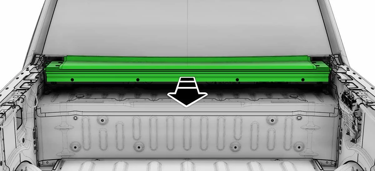

Sorry for reviving an old thread here. Any chance that someone grabbed the part number for the non powered tonneau shelf assembly?
I have the powered version but with my canopy camper install I am losing the ability/ no longer need the ability to use the tonneau. I’m mocking up some plans to utilize that space to heat/cool my camper and I’d love to not have to drill through the aluminum plate on my powered tonneau setup.

Pretty sure it's this:
PT00949439-A
Cargo Bed Front Cross Rail Assembly - Manual Tonneau Cover
And used to be variations of this:
C100052985-G
It's called the "bracket". Doesn't look like you get much space after removing it though. You can just have a gaping hole, the whole assembly is needed to fill specific gaps.

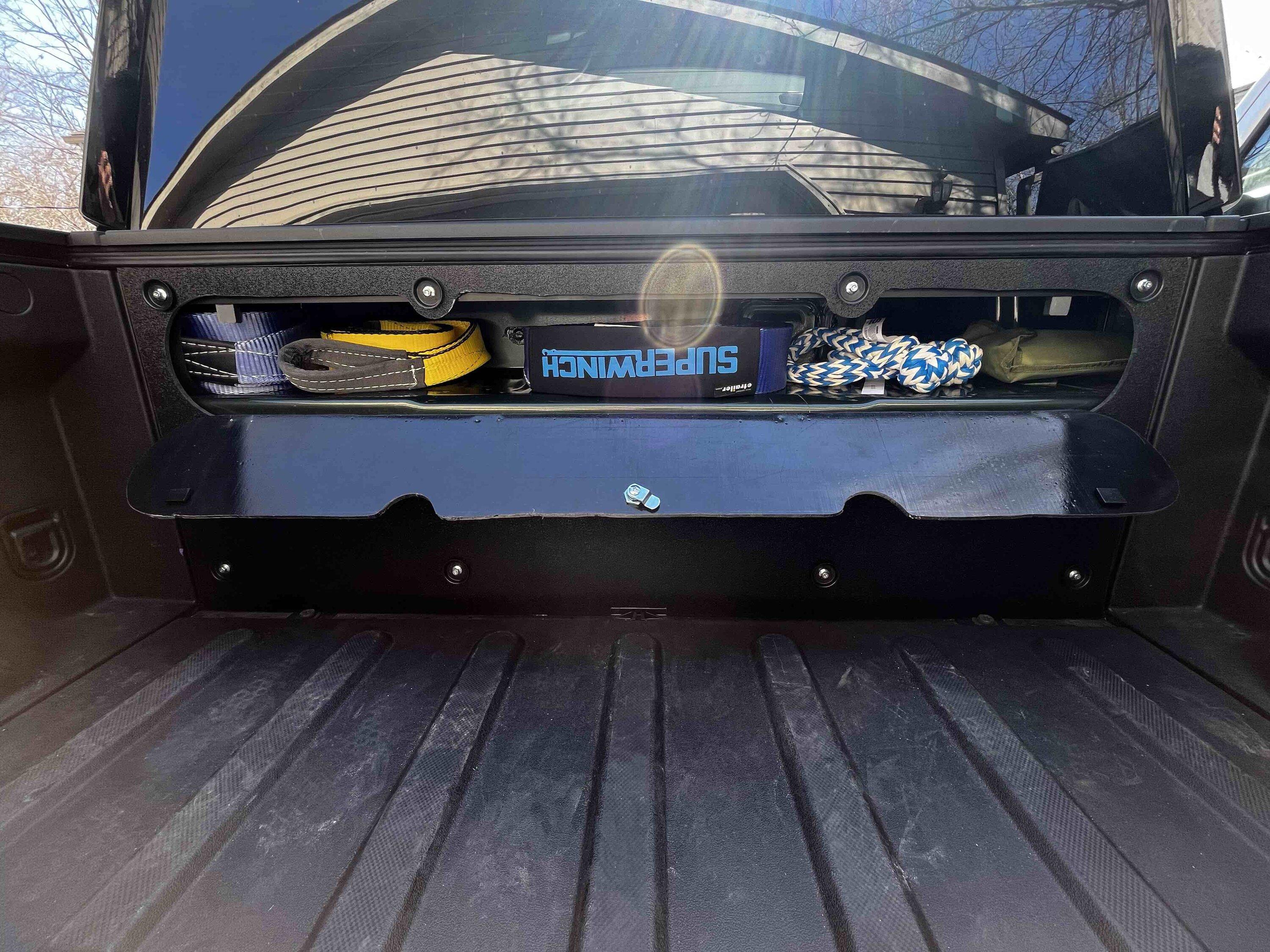

Perfect thank you so much. I spent several hours today trying to find that part number and failed.
It’s not a lot of room but I would feel better about it than taking a 4” hole saw to mine. No functional risk but still hard to do.

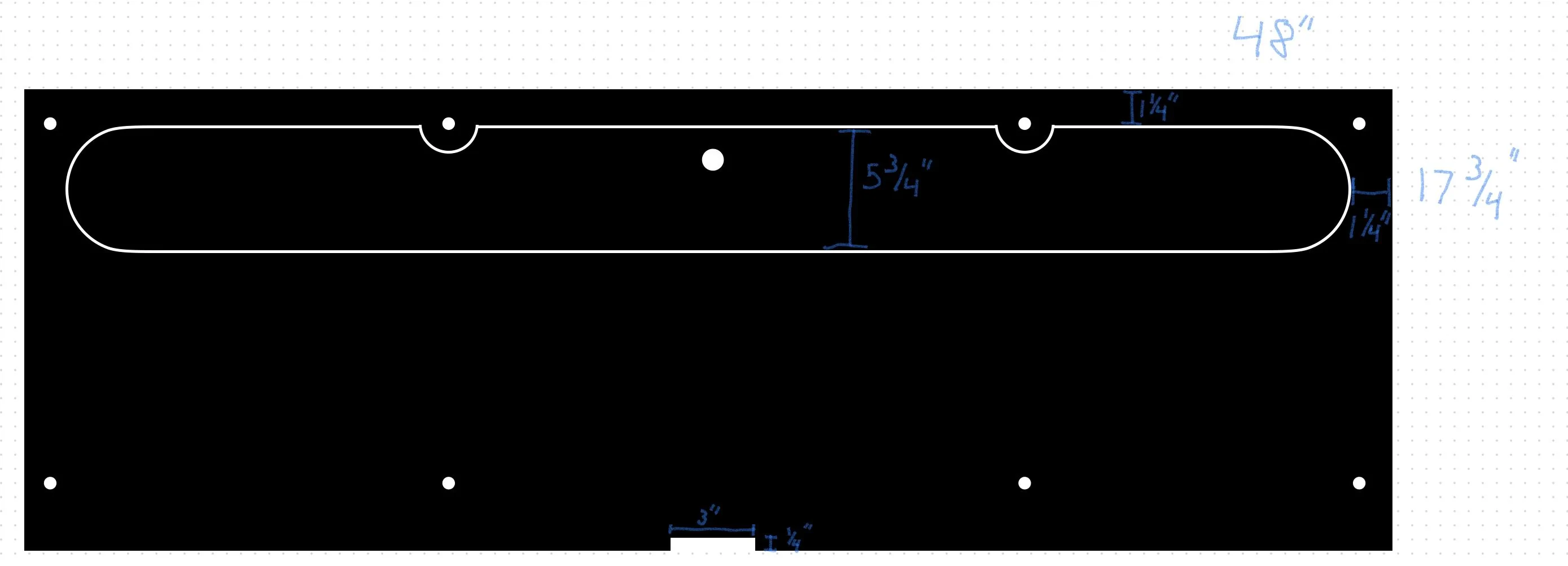

All done with the first version. [...]
[...]General design and dimensions:
@camping123 Thanks for taking the time to innovate & discover for us and for posting all of your photos & measurements. These sorts of things are invaluable!
For our use case (constantly having some things mounted into the bed), we'll probably do 3 separate access panels (1 between each set of retainer bolts) so that we can still access the panels regardless of how much gear we have pinned against the front of the bed. We are considering (a) using fully sealed boxes and (b) incorporating the built-rite molle panel. Basic options would be...
1. Just use access panels w/ existing Rivian cover (cheap but reasonably clean & effective)
2. Make one to three of the openings attached to fully-sealed bins in the back for cleanness of appearance and water-tightness (though we'd inevitably lose some of the storage space).
3. Incorporate the panel(s) into modified built-right molle panels for the sake of mounting some of the additional more permanent accessories we'd be using. (most expensive but also most comprehensive solution)
It will be a week or two before I'll have time to put too much thought into it, but curious: does anyone have any preferences on a solution they'd like to see to replicate/refine?
[PS: I know its an old thread, but continuing the conversation here based on forum etiquette rather than starting up a new thread]

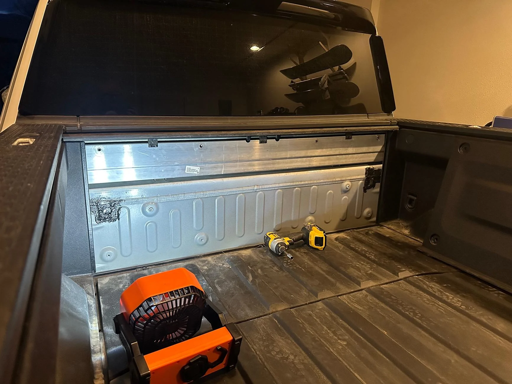

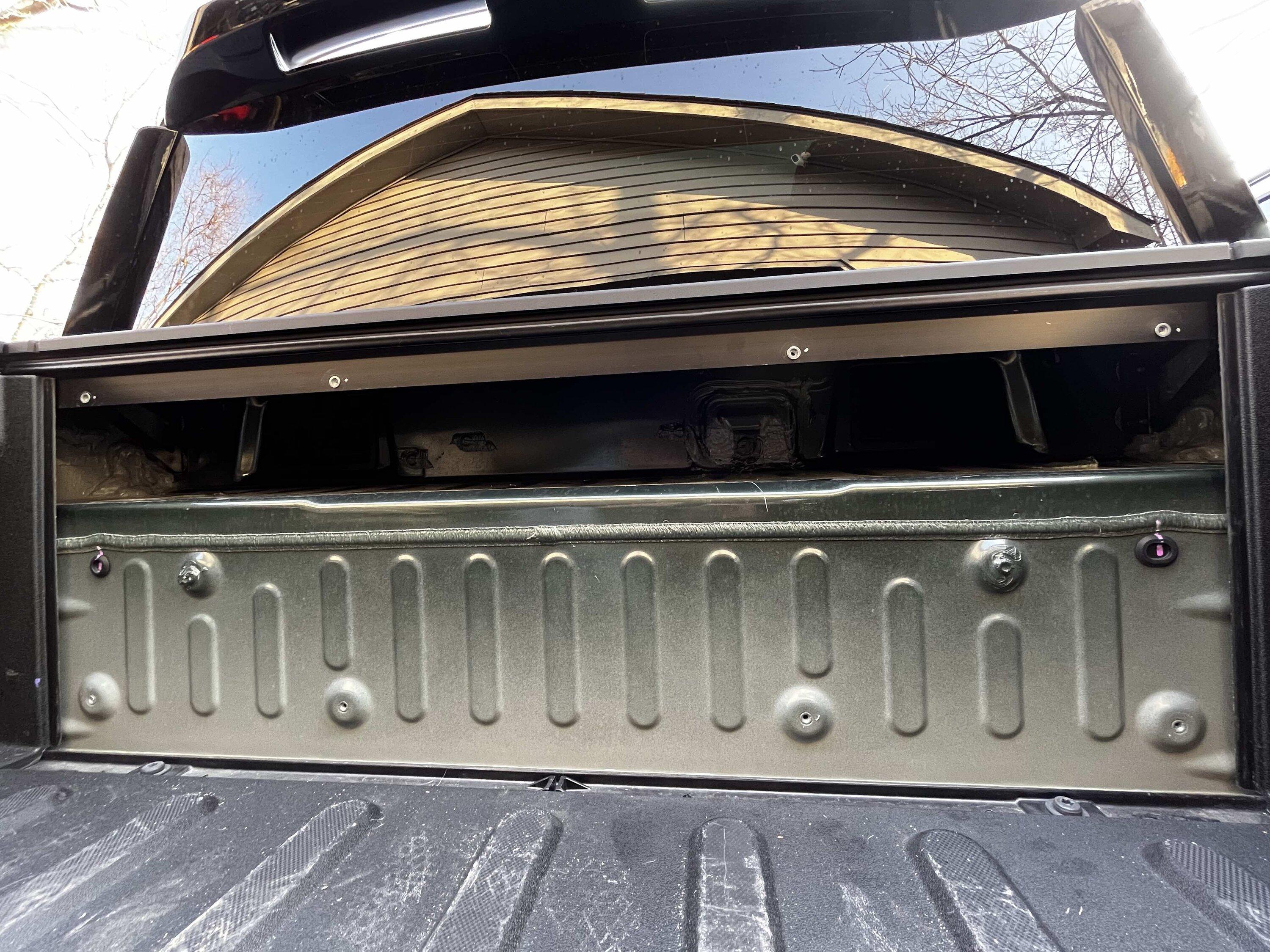

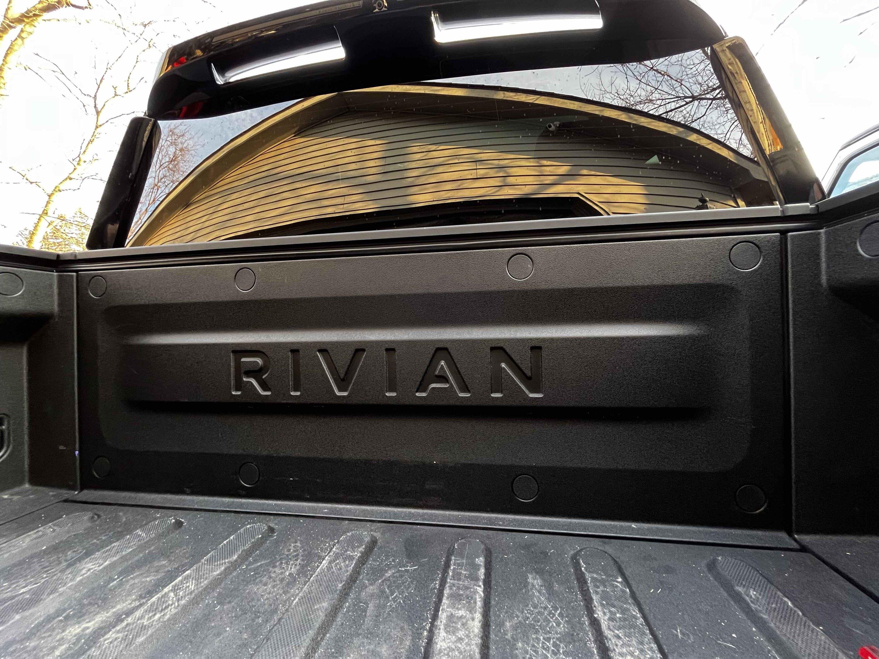

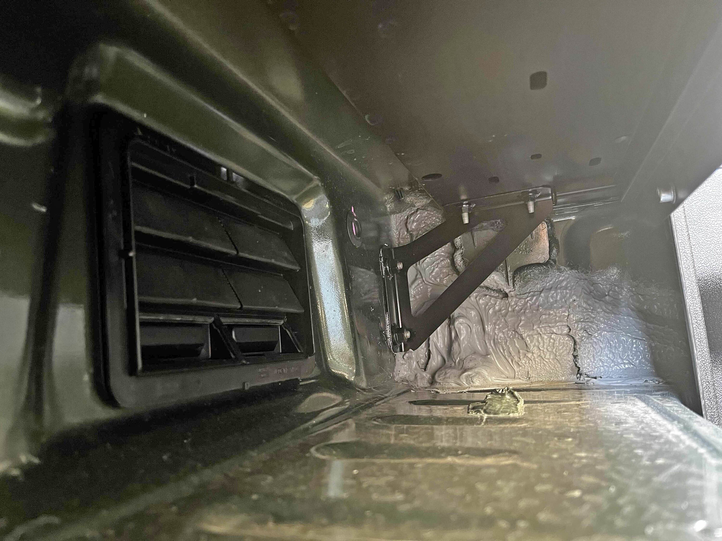

Curiosity got the better of me and I wondered what exactly is in that powered tonneau cover space on the manual/no tonneau versions. How much or little of the hardware is there and how difficult is the space to access?
No surprise, all the hardware is gone. I didn't check to see if any of the wiring for the motor or open/close button was still present. But I was surprised to see how easy it was to access the empty cavity. Just 8 plastic covers and bolts to remove the back panel in the bed and you can gain access to the space.
It's not a huge amount of space and I'm guessing that water could run through there, but it would be handy to store some tools or recovery gear. I'm thinking of making a new panel to go here out of wood or plastic with a hinged door and tumbler lock. The stock panel dimensions are roughly 48.25" x 17.5" and it sticks out about 1.5" at the bottom which I may not try to copy.
Looking to get some feedback from the community on any other ideas or suggestions for using the space.
Corner of the space with the one way flaps into the cabin. Lifting the flaps you can see the foam cushioning of the rear seats. Too bad the rear seat backs don't fold. That would be convenient access.
Part number info for the plastic bed panel. If I could source another panel, I'd cut one of those up instead of making one out of plastic or wood.
Thanks for sharing the photos; it's great to see what's inside that cavity. I could see an opportunity for either a split back panel, hinged above the Rivian logo, or a grooved vertical track to slide the top part down like a sleuth gate. While you could use some nice stained plywood, getting a second panel to cut from a junkyard might have good results; you can go back to the original if you need to sell or it doesn't turn out looking nice. Would love to see a posting of a completed retrofit project.
