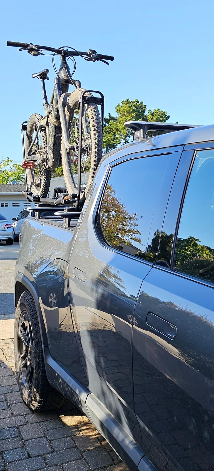

Yes, this is an E-MTB, and so far, I really like the Piston SR. I usually just lift it onto the rack from the side. Front tire rail holds it in place until rear rail can cinch down. Weight (42lbs) is not so much an issue as the Piston is less than 20lbs and cargo crossbars are rated at 250 per pair while driving.

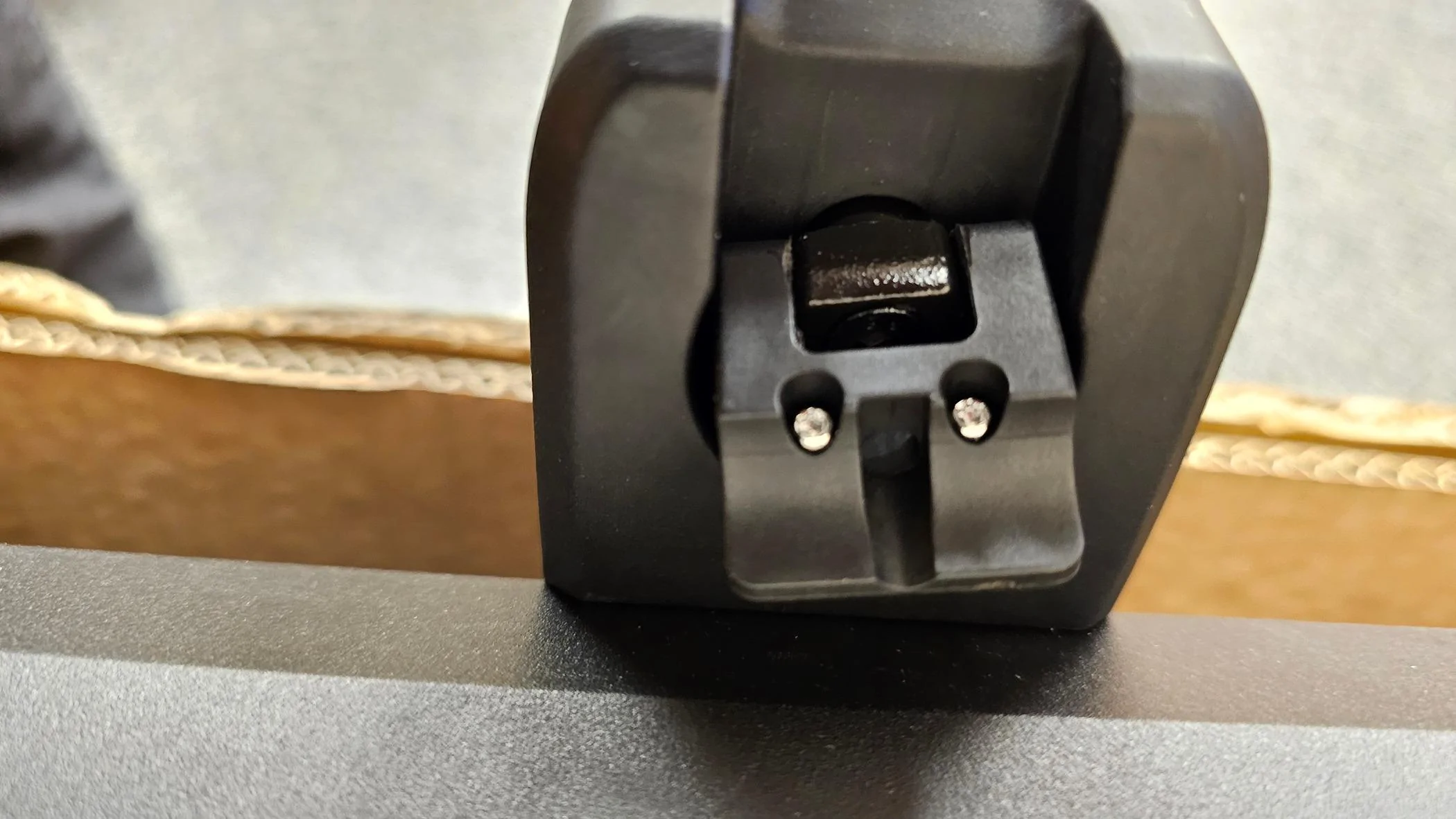

The Riv Piston SR mounts (2) have four thumblatch operated threaded T-Bolts that can be tightened with a hex key and then 'thumbed' down in a tensioned fit. They mount is fitted for the Riv crossbars and is a clean finish, as opposed to an over-under clamp like my Loadwarrior cage rack. Then thre is the key set from Gear Shop that can be added for security preventing the 'thumbed tension' from being accessed.
Theoretically, it should come off of the bed rails relatively easily, howeveri have yet to do so. Hope this helps. I also picked up a standard Piston SR on sale through back country just before the Rivian branded one came out, so I am in a similar dilema of having a second rack that doesn't fit quite the same (and it doesn't have the Rivian logo).

I was able to install on the Rivian cross bars in about 5 minutes, so I assume it would be a similar if not faster removal proces, I just haven't taken the Kuat off yet.
