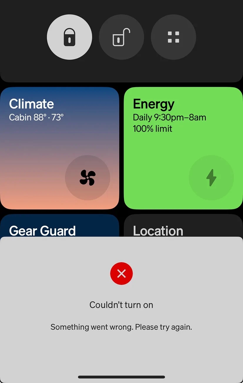

I live where it’s hot, so love to turn on the AC remotely before heading to my Gen 2 R1S. When I hit the AC button in the iOS app, it warns that it couldn’t connect. After 3-4 attempts, it connects. Happens when I’ve got a strong 4g/5g signal, and even when I’m on wifi at home.
Anyone know about this issue?

Same. To get around this, I wake the vehicle first. In the app Home Screen, pull down from the top and tap on the words stating the vehicle is sleeping. It will confirm that you’d like to wake the vehicle. Once awake, HVAC buttons should work immediately
100% a "wake/sleep" issue. I've found PaaK and the Fob both respond almost instantly when the truck is "awake", but if I walk up and it's "asleep", then I'm waiting for it to wake before I get access. App behaves the same way.
Probably a hardware limitation, but sure would be nice to have a "constantly on" section of the hardware that controlled access and OTA commands. I'm sure this symptom is a function of limiting vampire drain, but it leads to this annoying behavior.
Thanks
Agreed. There are times that I really need to minimize vampire drain. However, in a typical week where I’m driving a bit most days and charging at the end of the week, I’d trade a higher level of vampire drain to have the vehicular constantly awake, at some level, and responsive to commands.

Looks like this issue is being addressed in the next OTA update.
