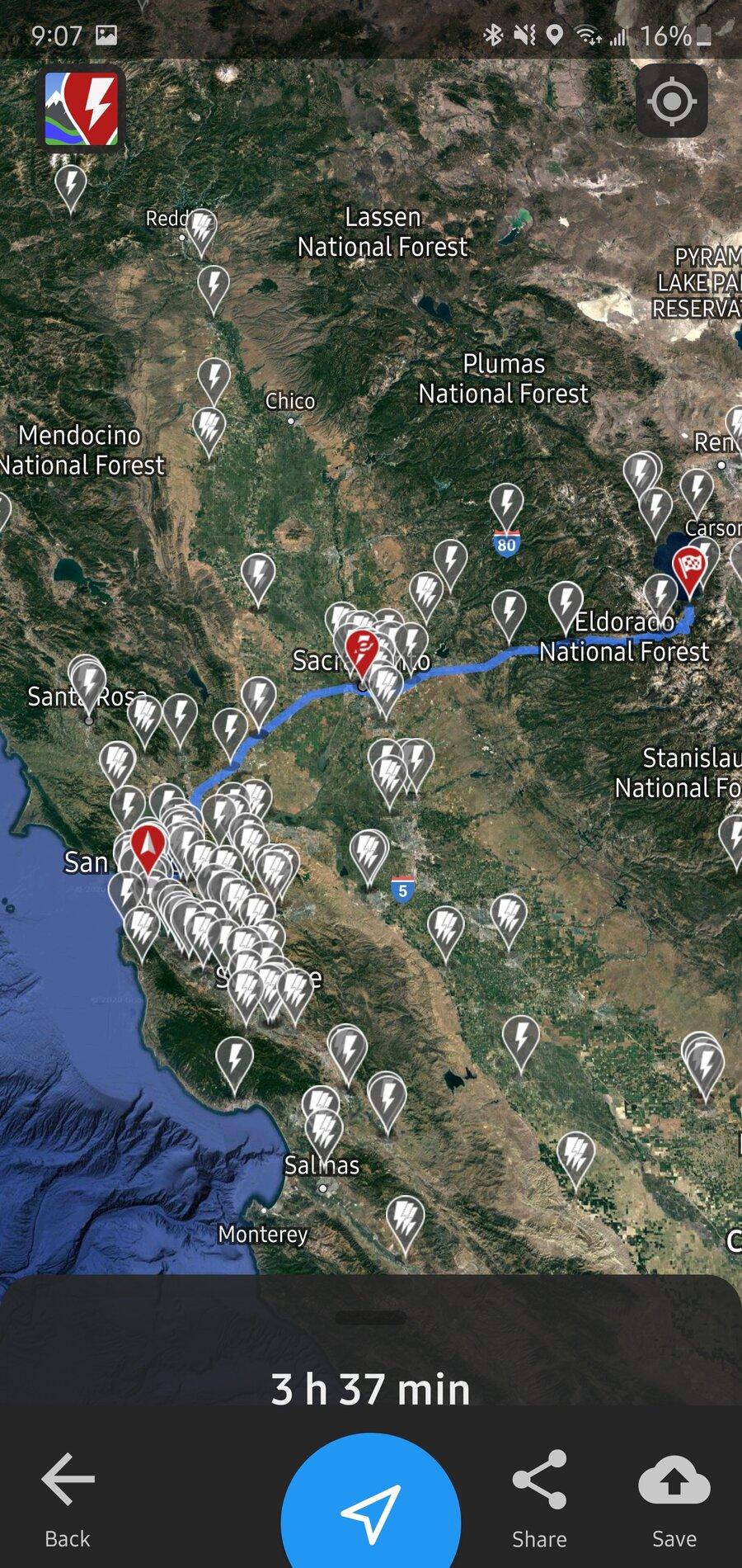

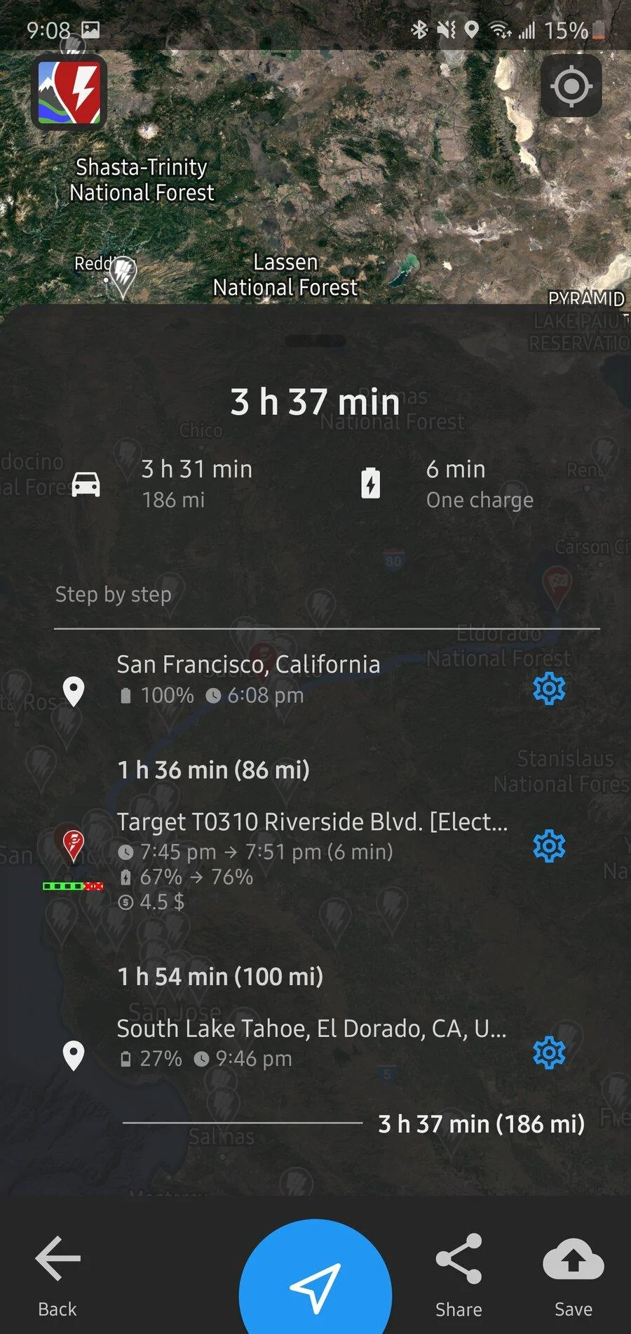

BtW, looks like there is a 150kwh charger in Sacramento so you could top it before going up.
If you have a heavy foot you'll definetily have to stop, so up to you if you are OK stopping or not.
Does stopping for ~20 min makes that much difference to you that you think it's worth to pay 10K more and wait longer?
Rivian R1T R1S Rivian announces 7-Seat version with longer range Screenshot_20201123-210856_ABRP
Rivian R1T R1S Rivian announces 7-Seat version with longer range Screenshot_20201123-210738_ABRP

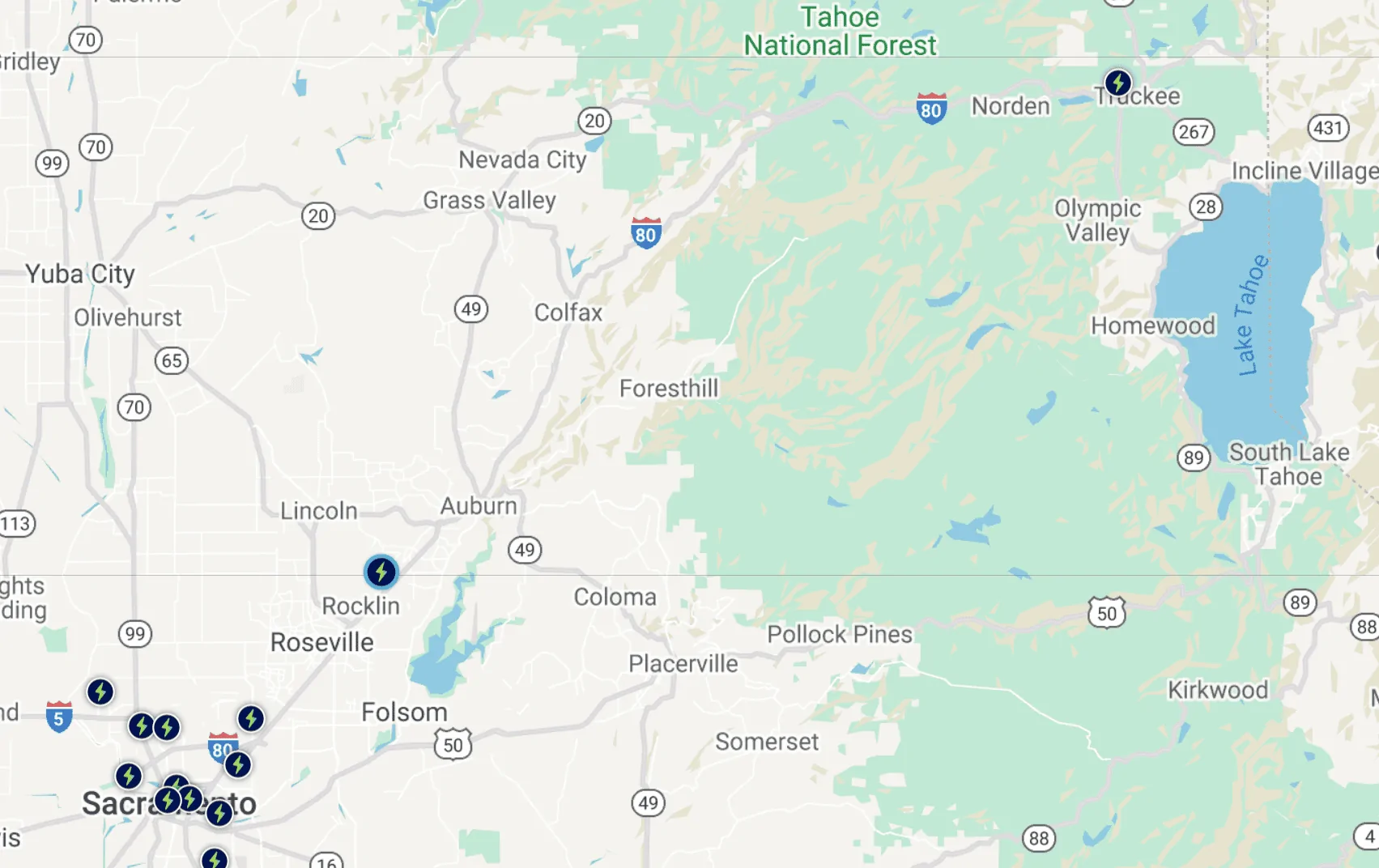

The 350kw chargers in Rocklin and Truckee are 80 miles apart with 5000 feet elevation change, which is about 1.2 degrees slope. This guy says he loses in his Tesla-S about 2/3 range going 40 miles with 2.5 degrees slope. So, your trip seems doable to me...

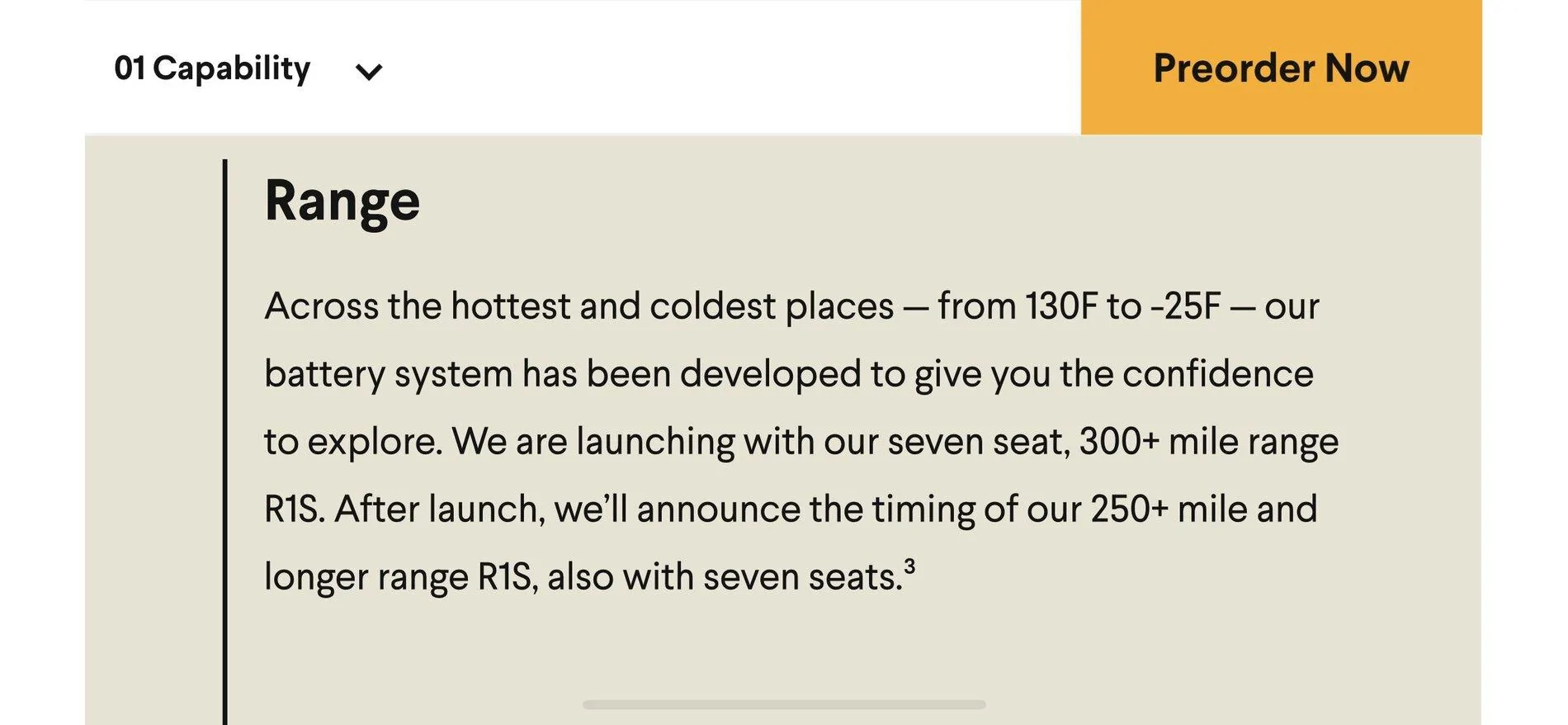

The 400+ mile R1S isn’t a sure thing at this point. They specifically use longer range wording for the R1S instead of 400+ like they do for the R1T. There is a lot of speculation they can’t fit a large enough pack while keeping 7 seats. It’s possible they keep delaying until cell density improves more so they can get more kwh out of the same number of cells.
Rivian R1T R1S Rivian announces 7-Seat version with longer range F189BA46-20CA-4E5B-96CB-58A4C2B4991B
The 400+ mile R1S is a sure thing (or as sure as we can be about anything these days). What we are not so sure about is a 7 seat 400+ mile R1s. The idea that there would be a 400+ mile 7 seat R1S is fairly new. It was not promised way back when most of us made our reservations. The reason for this is that the additional seat cut into the space where the extra range battery had to go. Battery volumetric requirements are going down daily. Eventually batteries dense enough for a 7 seat design will become available but I don't know when that will be.
