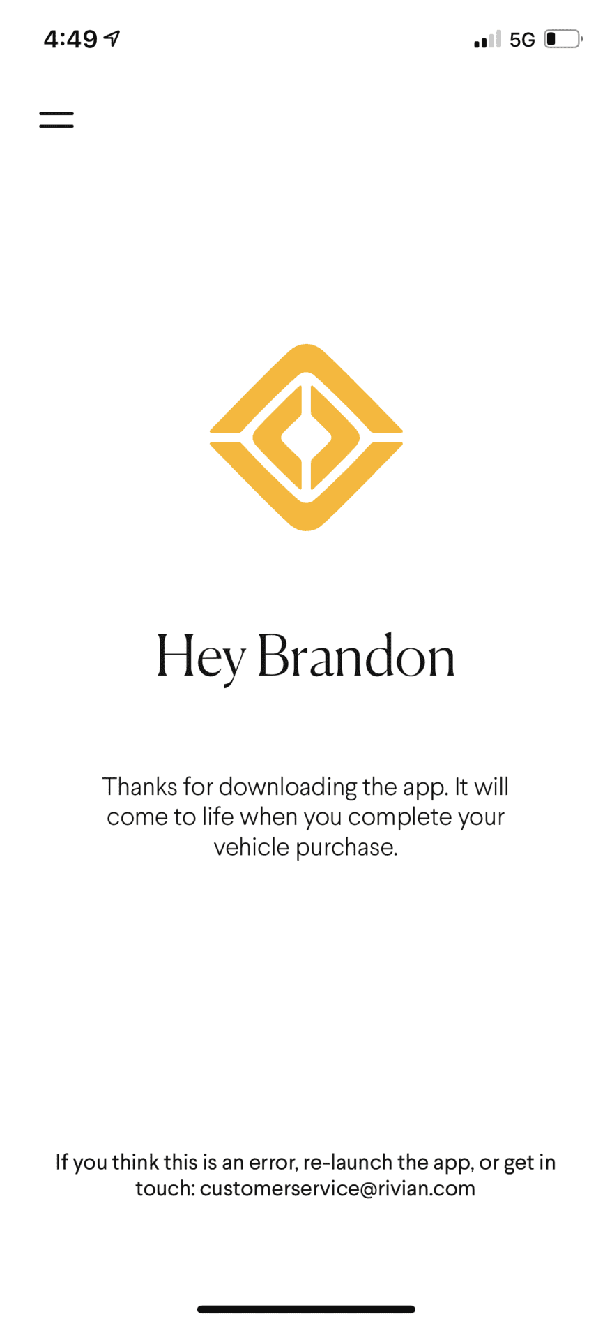

Is it just me or does my app home screen look slightly different today?
Not just you, I'm getting the new greeting as well. Also noted an app update was pushed yesterday (for Android).
