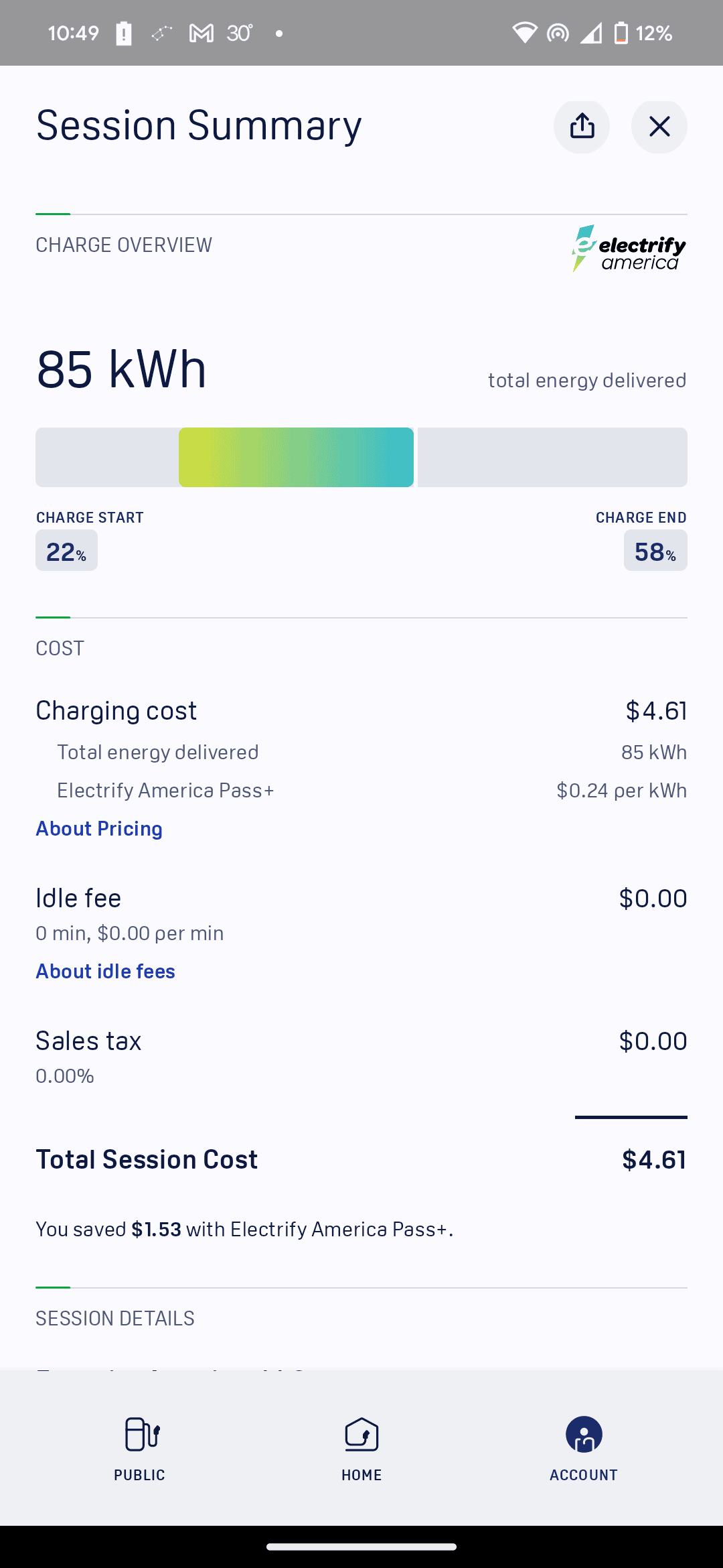

I meant the only one that is currently available that Rivian laughably calls the "large battery pack"
It is large in size compared to most EVs
148
13,592
27,466
Oh wow, I can only dream of having electric rates like that. Our electric rates in NH for the next 8 months is $0.336/kWh. The benefit of going electric isn’t nearly as beneficial as other parts of the country.
They got ripped off anyway. ;)

Does anyone know if the battery percentage is based off of the ~125kw usable or the total pack. Trying to figure out what 1% battery is in kwh. I would like to know this to keep track of all the vampire drain. The trip meter purposely doesn't track it to make the car seem much more efficient than it really is.
