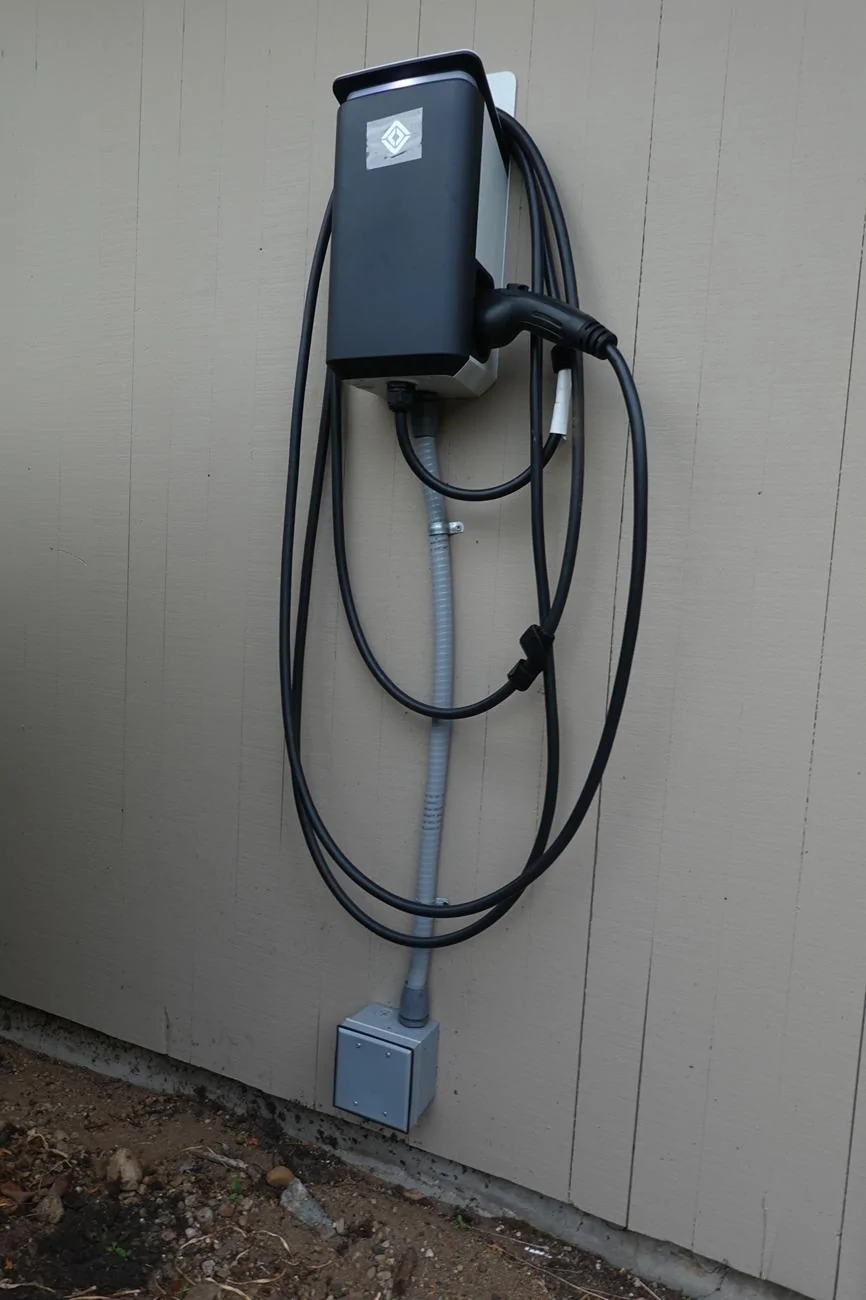

splicer was near Rivian charger. The splicers were in the junction box at bottom where wires come out of the house, I do not know the gage, but visually very large. When initial install performed the electrician came with a pre cut length of the heavy wire, it was too short to get outside of the house, so he came back later with a longer one, maybe it was too short also?

I’d go to a commercial charger and see if the vehicle will accept a charge. I believe you have a faulty breaker.
that’s what I would do.
keep us posted

Heat cycles can do that. Glad it was a simple fix.
