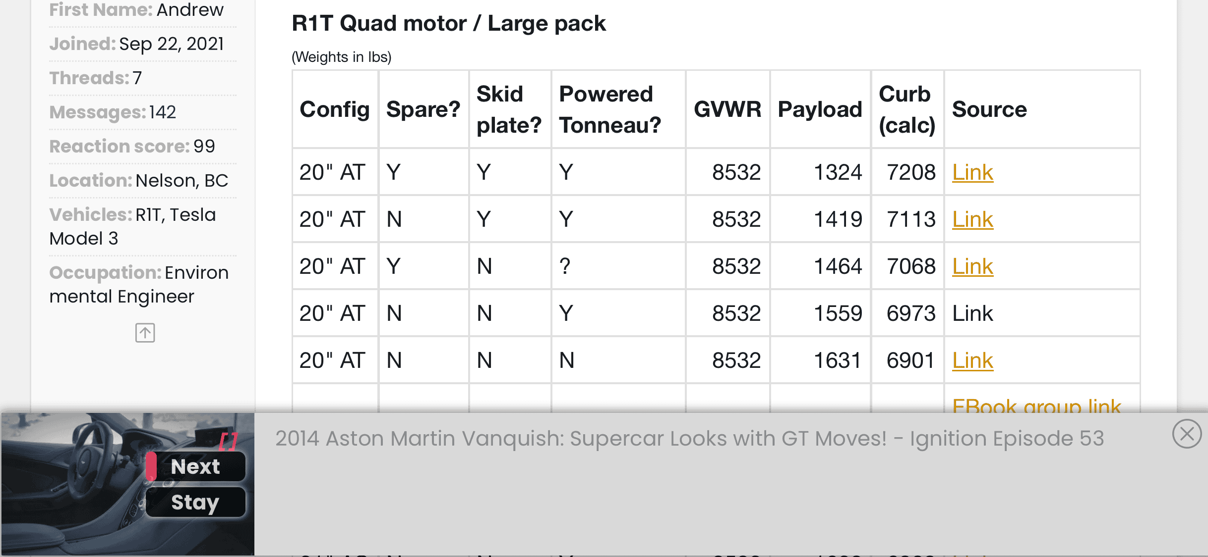

My truck only has 1400lbs of payload with the large pack. Add two more modules that probably becomes a ~1000lbs.
So as long as you don't want a spare tire, RUS or power tonneau it's probably ok but for me it's a no go.
Edit: Just looked and Munroe quoted the weight of a large pack at 1750lbs so its even worse than I thought.
The DM has a better payload & very few of the MP have a spare/RUS/PTC so payload would still be above 1400lbs.
If I divide 1750 by the gross capacity (141 kwh) I get 12.42 lbs per kwh. Now adding modules will not be completely proportional because there are additional components in the pack that will not change but using this number 200 kwh gross pack would be estimated at 2,484 lbs so an extra 734 lbs over large pack.
I don't think weight is as much a problem as the packaging. In the R1S there is just not enough room. In the T even if it fits what will the reduction in payload and towing capacity look like?
Disregard the R1S, if they want to sell a real max pack for it put it on the T chassis & have a R1S XL.
Weight is an issue, since it kills payload.
we know the modules are approx 195lbs (or less) The MP has 142kwh net (usable)so:
10 modules = 158kwh usable & 1945lb pack
11 modules = 173kwh usable & 2140lb pack
There is no room for a 12th module so that is as good as it gets, no 200kwh gross as it is too big & heavy.

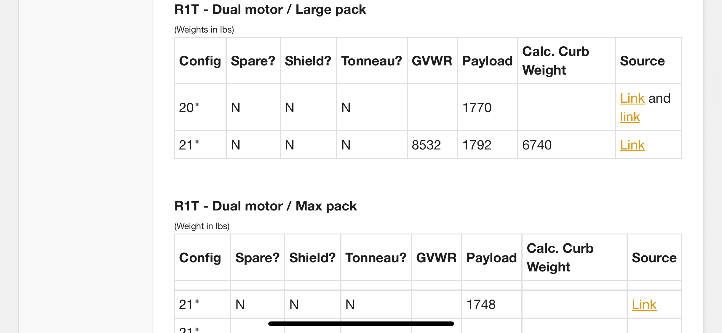

They may just accept the 900 # payload, and likely reduced SAE tow rating,
Only a very small % of MP have RUS/Spare/PTC so sans those items:
11 module, 173kwr usable
1792- 390=1402lbs>900
1748-390=1358lbs>900
10 module, 158kwh useable
1792-195=1598lbs>900
1748-195=1553lbs>900
Keep the GVWR the same & the payload is still same or better than the full size GM offerings and in line with the midsize offerings.
