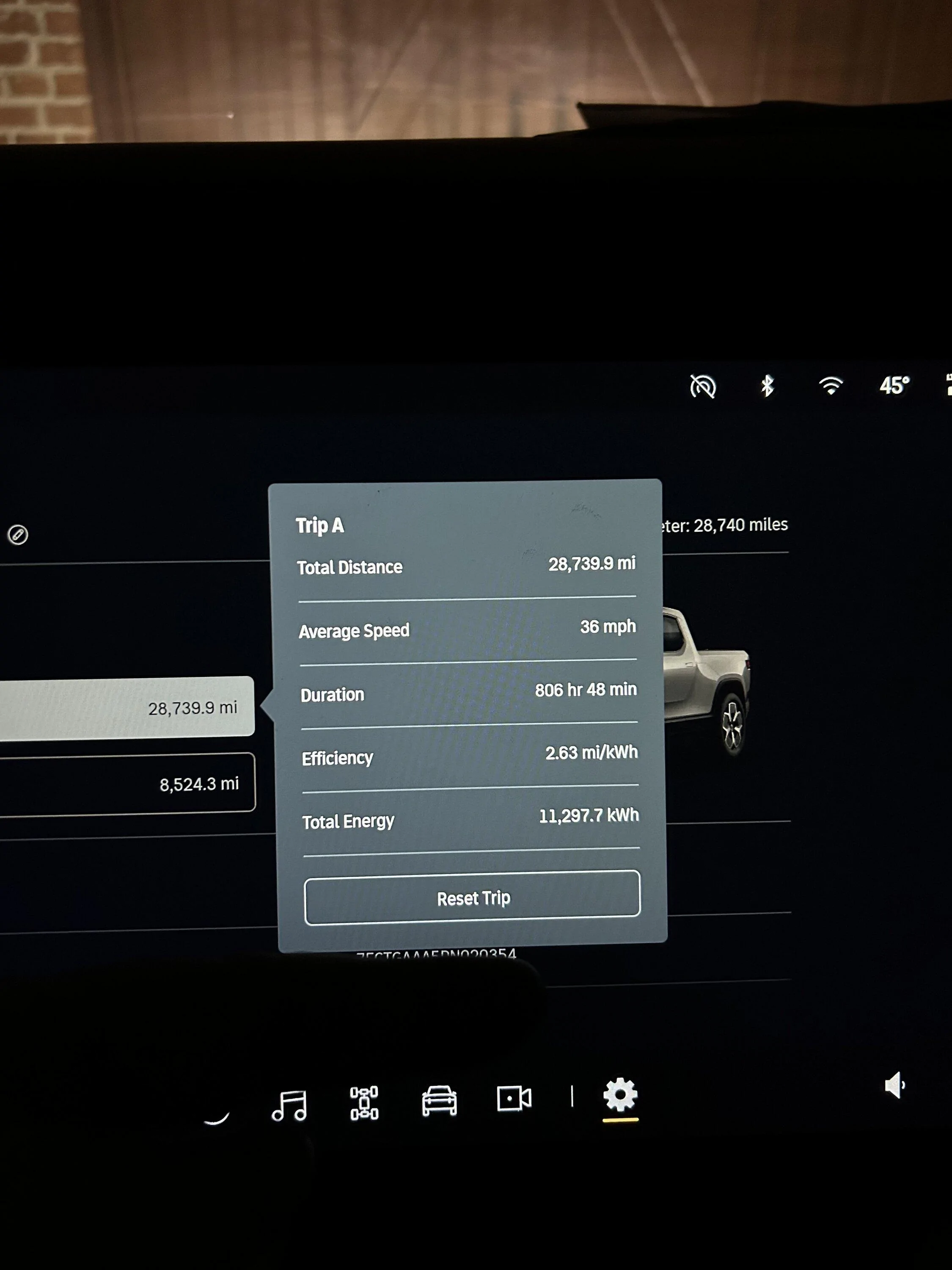

I’m actually at 2.63 now.
The math actually comes out at 2.54 but still impressive.
What tires are you on? Do you do mostly long drives?
On 22s I get a lot of 1.95 to 2.0 because we do a lot of 3 to 5 mile drives around town but on trips we do much better.
Edit: nowhere near your numbers but between 2.2 and 2.3

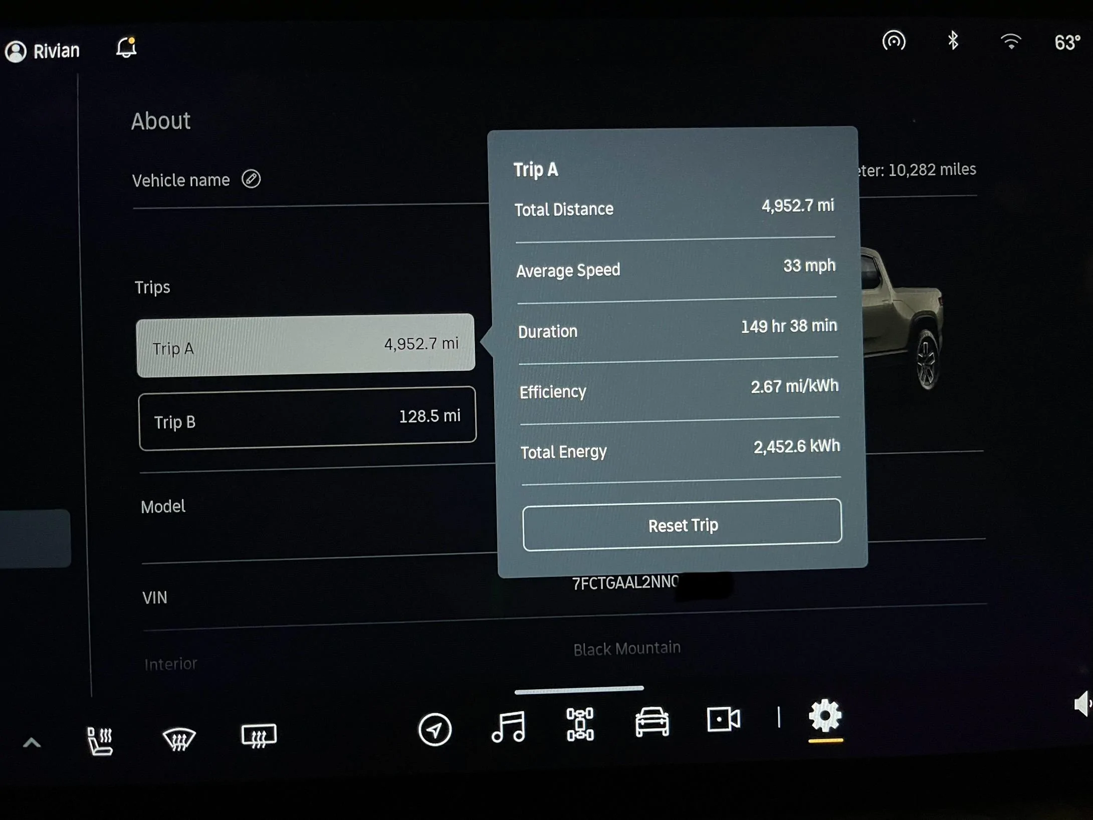

Here is the Rivian R1T loaner showing 2.67 mi/kWh with 20” All terrains.
Rivian R1T R1S Rivian Max Pack EPA Data (document shows 141-142 kWh usable battery) IMG_6404
7,462
12,794
That average is even further off, you divide the miles by the kWh it is 2.01.
