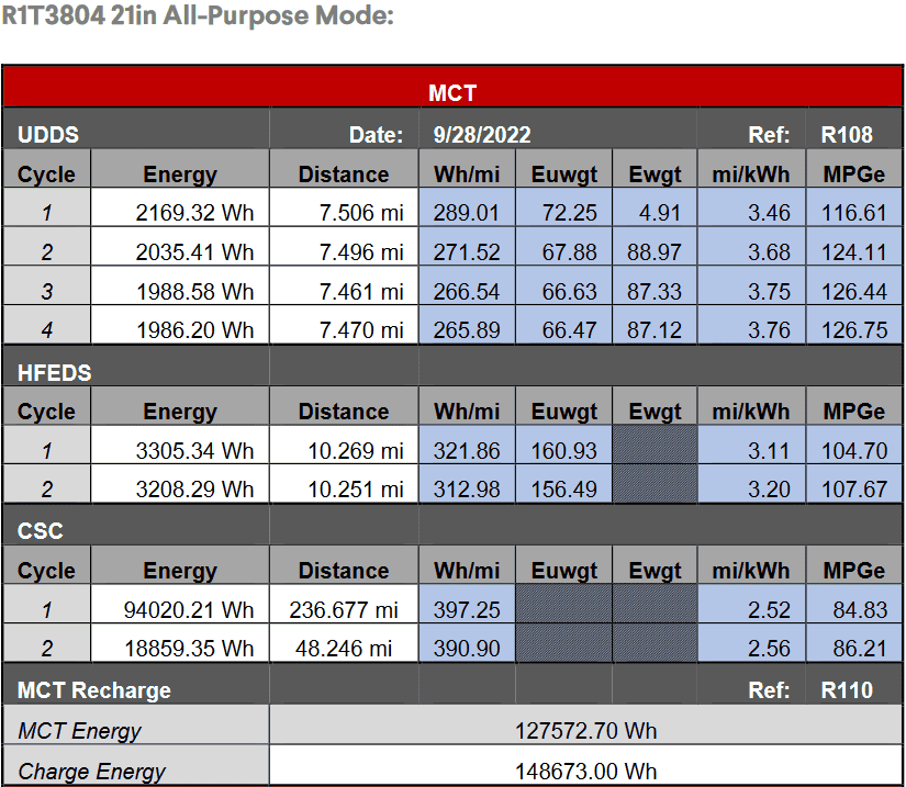

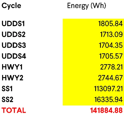

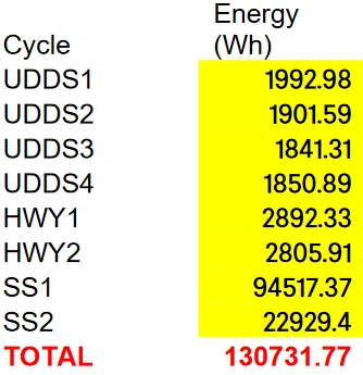

I'm with you but I think 127-128 kWh usable is (just?) for Quad Large? Like @240vPlug alluded to earlier, the Dual Large test group data shows 131-132 kWh usable, I think. Is this the correct interpretation of this data?
R1S 21" Dual Large (page 24):
Rivian R1T R1S Rivian Max Pack EPA Data (document shows 141-142 kWh usable battery) 1700711935569
R1T 21" Dual Max (page 27):
Rivian R1T R1S Rivian Max Pack EPA Data (document shows 141-142 kWh usable battery) 1700711985453
Quad Large for reference:
Rivian R1T R1S Rivian Max Pack EPA Data (document shows 141-142 kWh usable battery) 1700712111322
Dual Large:
Dual Max:
Well now I just don't know. There should be several different large pack test results. And one is prior to them unlocking the extra capacity and one after. And I think they are apples to apples with quad motor. So much data.....

So I copied and circled here the relevant info for *R1S 21 DUAL MOTOR*. Only difference is battery pack.
Large Pack
Max Pack
For hwy, we see about a 32 mile difference (364.87-332.52). Like you said, could be explained by the 11 kWh battery pack difference.
And you’re right, the city numbers are quite disparate. 429.60 - 368.05 = 61.5 miles.
Since the only difference between them is the battery pack (presumably), is there anything in these EPA docs that would suggest Rivian is fudging the city numbers? Or, is there a good possibility that these could be legit and we need to understand how?
