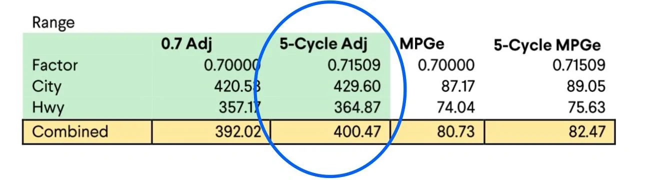

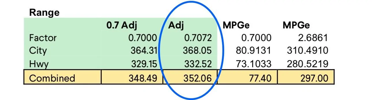

So I copied and circled here the relevant info for *R1S 21 DUAL MOTOR*. Only difference is battery pack.
Large Pack

Max Pack
Rivian R1T R1S Rivian Max Pack EPA Data (document shows 141-142 kWh usable battery) 1700698780103
For hwy, we see about a 32 mile difference (364.87-332.52). Like you said, could be explained by the 11 kWh battery pack difference.
And you’re right, the city numbers are quite disparate. 429.60 - 368.05 = 61.5 miles.
Since the only difference between them is the battery pack (presumably), is there anything in these EPA docs that would suggest Rivian is fudging the city numbers? Or, is there a good possibility that these could be legit and we need to understand how?
