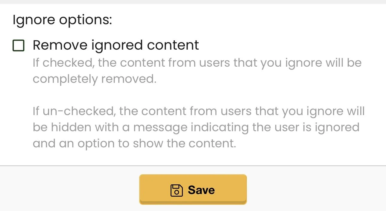

Not sure what you want out of the ignore feature. If you ignore a user specifically you won't see any posts, replies or threads from that user. It's worked quite well for me though I reserve it for people that resort to people are clearly trolling or resorting to insults.
Ignore still shows their posts here, and they still show up on the reaction lists.
And importantly, ignore doesn’t mean that the ignored users won’t see your posts—this would be a true block feature, where a blocked user wouldn’t ever know you exist on the site
And importantly, ignore doesn’t mean that the ignored users won’t see your posts—this would be a true block feature, where the blocked user wouldn’t ever know you exist on the site
That hasn't been my experience. It is true they can still see your posts but otherwise I am not sure your first statement is correct.
Ah, it’s my error. Apparently, this checkbox in my settings wasn’t checked. Corrected now, thanks for the heads up.
Ah interesting. That explains it.
