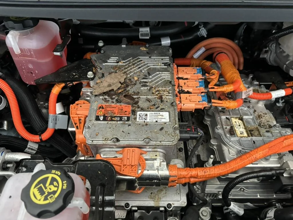

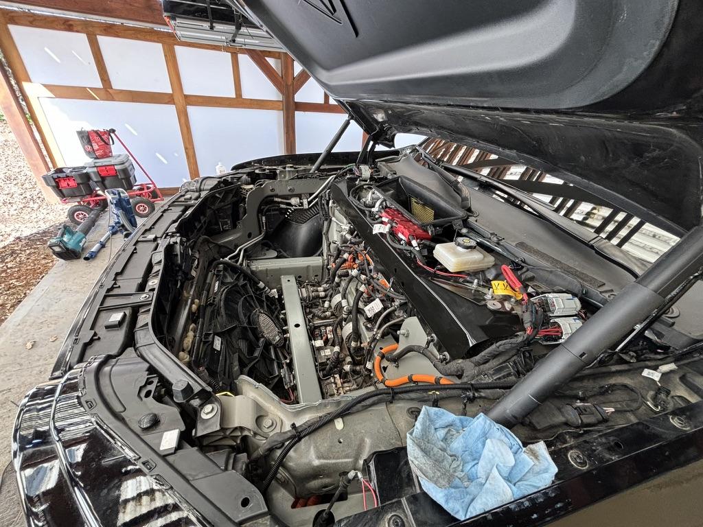

I've had rat/rodent problems as well --see attached photos of my R1T and Chevy Bolt. I've gotten very good at removing the R1 tub and clearing out nests.
There appears to be lots of evidence that concentrated peppermint oil placed throughout the underside can deter rodents. Seems to work for me as well.
Setting traps under the R1 and Bolt has also helped. I've been pretty successful with the RatZapper. If you go that route, be sure to bait the traps UNARMED for a few days in a row. Once the rats/rodents get comfortable taking the bait, you can arm the trap(s) and start collecting bodies in the mornings.

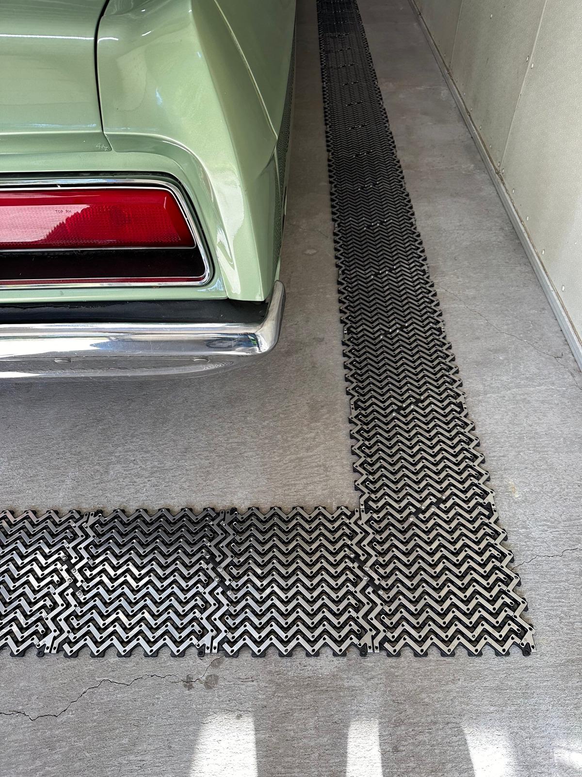

is this metal grid electrified?
yes. The Count even had staff check it by hand just in case the voltmeter was giving a false positive.

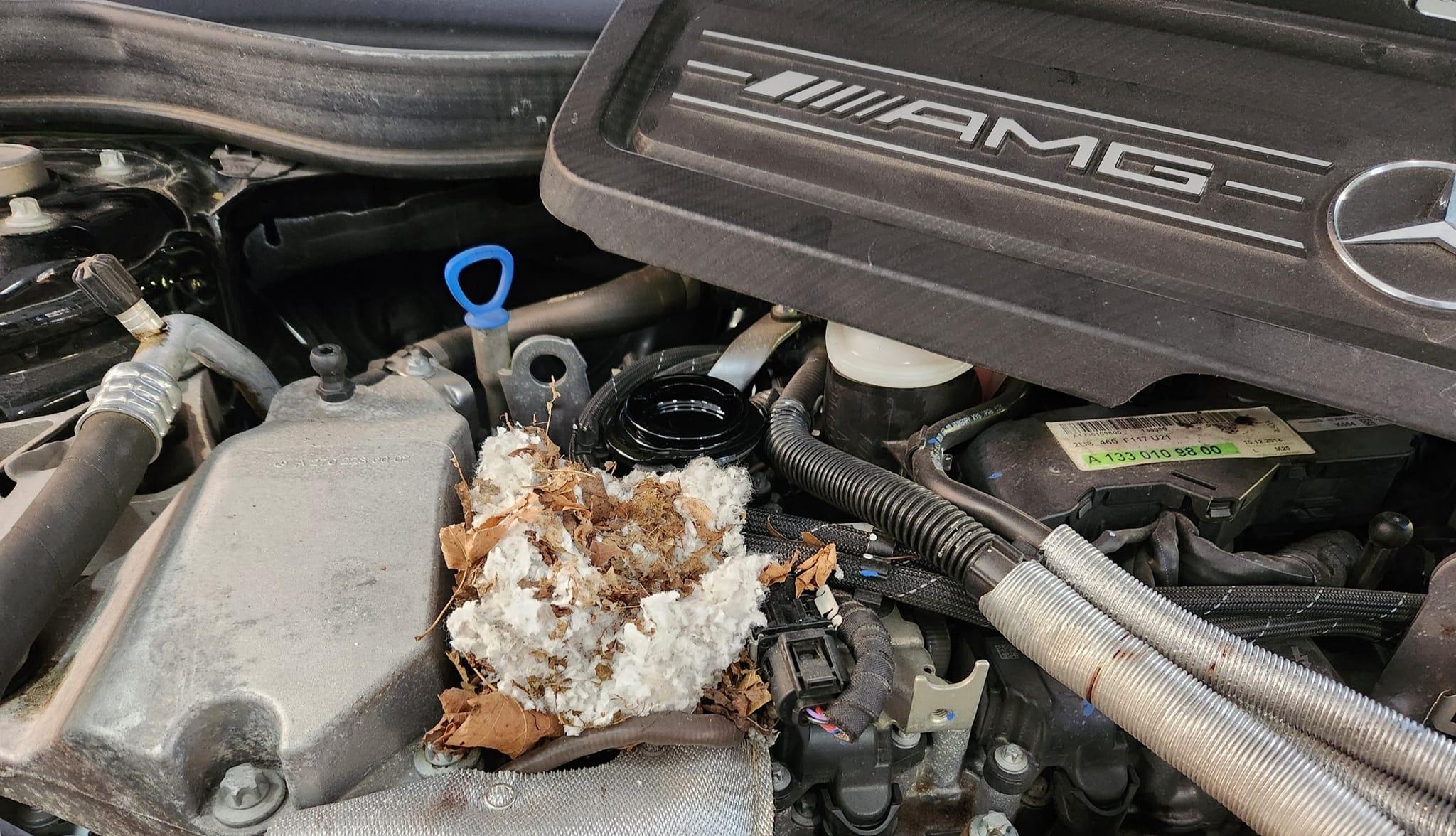

Bummer! Just did some maintenance on wife cars and found this. This car was driven EVERY day this winter and they still set up shop, unbelievable. (chipmunks). Key is to set traps at the first sign of cold in the fall. That's when they move in. Forgot this year myself.
