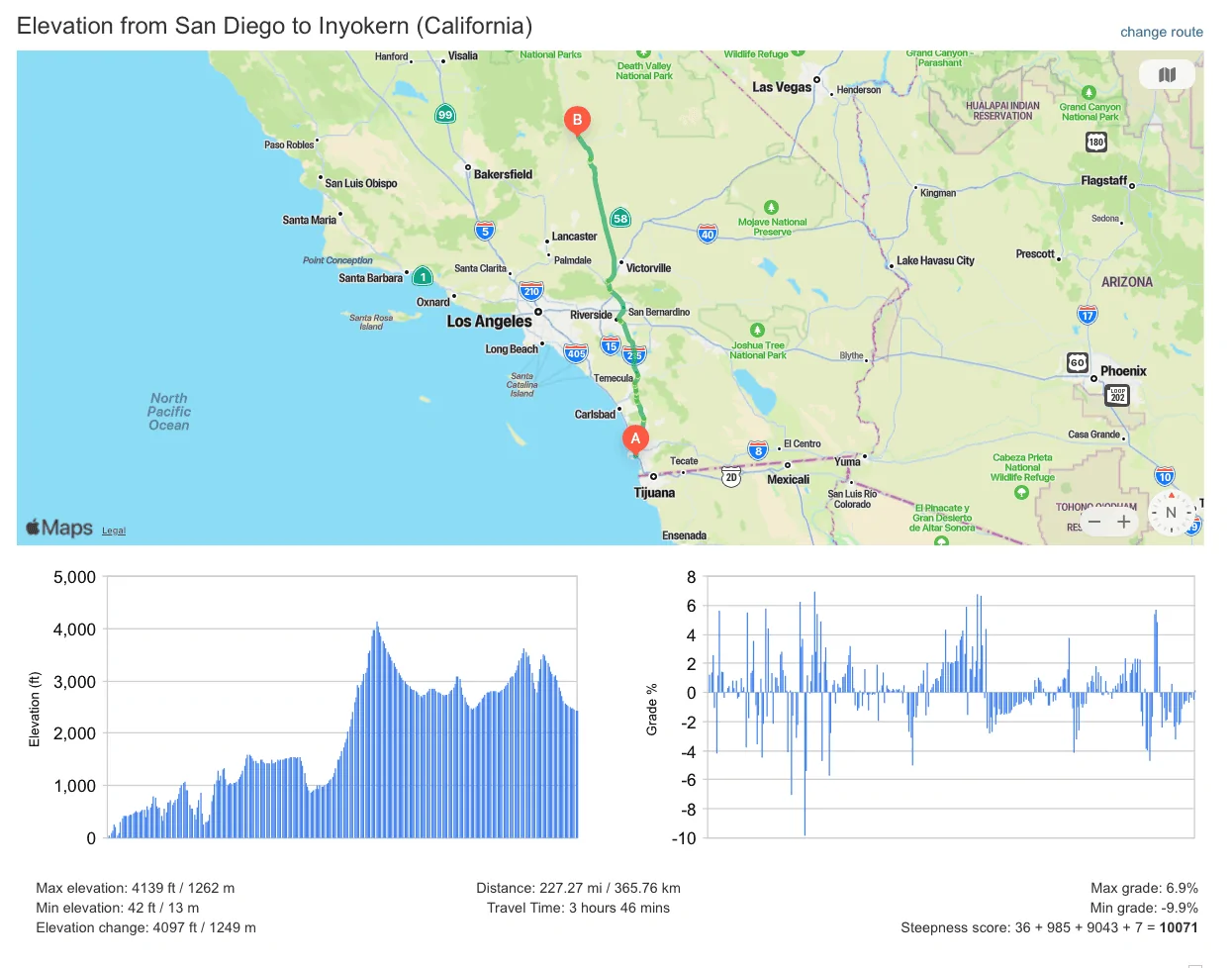

Ever since I started taking an EV on road trips (well over 4 yrs now between Tesla and Rivian). I use this website to get an estimate of elevation changes along the route I plan to use.
https://www.flattestroute.com
You can specify start and end points so it's pretty handy. Also, I compare my thinking with Rivian's nav set to arrive at 10% on battery SOC. The thing to keep in mind is actual distance versus elevation changes.
In your particular case, it says 227 miles, so its close your house, but it also shows that it's an up grade for quite a long distance. Even in Conserve mode, starting at 100% SOC, I think it will be close.
What I would do is to see what SOC is in Victorville as you are changing to 395. It's roughly 90 miles between Victorville and Inyokern so if you have at least 150 miles left on the vehicle, you should be fine. OTOH, if it's around 100~120 miles left, I would definitely charge in Victorville (there must be an EA there at a Walmart, but do check. beforehand).
