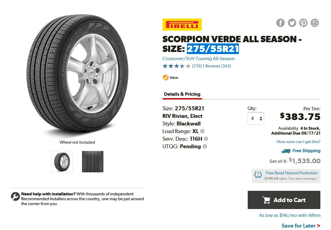

Ventura
Sep 3, 2021
163
293
Ventura County, California
R1T Red Canyon 20" / Prius
FYI. Tire Rack finally has a price on the 21".
275/55R21
$383.75
https://www.tirerack.com/tires/tire...wall=Blackwall&partnum=755HR1SVASXL&tab=Sizes
Listed at 38 lbs vs 57 lbs for the 20"AT.
It's hard to find an LT in that size less than 57 lbs, but here is a possible replacement for those looking for an LT on the 20" that is more focused on road driving and efficiency. It is still heavy so it is unlikely to rival the 21".
Michelin Defender - listed at 53 lbs

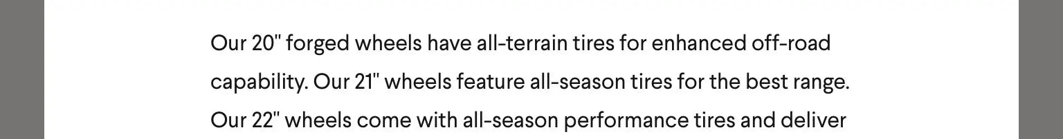

You can verify with CS as I did, the 20s are forged and the 21/22s are "tilt cast/flow formed" so it is a hybrid between cast and forged
Zoidz
Gil
Feb 28, 2021
227
5,233
11,754
To dive a little deeper, a forged aluminum wheel (compared to simple cast aluminum wheel) is stronger in all areas due to the forging process aligning the grain of the metal and eliminating voids.
Tilt Cast/Flow Formed starts off as a simple cast aluminim wheel, and through heat and roller pressure, the rim area is reshaped and made stronger by the process, aligning the grain similiar to forging - but it's *not* forging. So the rim is stronger, but the hub is not. This type of wheel is great for the street, but not for serious track usage, for obvious reasons.

I concede. Was influenced by the identical wheel descriptions in the configurator. Seemed to me that one would would want a full and accurate wheel description in the configurator where one makes their wheel choice. Obviously it makes sense to have a stronger wheel in the ATs as more stresses are expected when off-roading.

From CS
All three 20” wheel options are indeed forged! The 21” and 22” wheels are, on the other hand tilt cast and flow formed. To clarify, the 21” wheel is the “road” wheel, but this does is necessarily specific to the tire. Both the 21” and 22” wheels have all season tires as standard, while the 20” option comes with heavier-duty all terrain tires.
